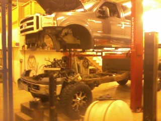

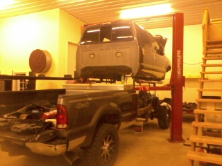

   / Ford 6.0 diesel; the good, the bad, the ugly? #16
Yep. My buddy Glenn is a Ford diesel tech. I used to go up to the dealership on Sundays during the 6.0L era/hayday while the dealership was closed and we would pull 3 6.0L Superduty trucks in on Sunday morning and in 8 hours have all 3 trucks with cabs in the air and be started on stripping the accessories to pull heads.
The dealership stocked ARP head stud kits and Innovative Diesel Performance modified EGR manifolds and blocker plates. As fast as he could pull cabs, more trucks were brought in.
Eric and his dad Ted at Innovative Diesel were one of the very first to pioneer the hardware fixes for that turd.
I've worked on more 6-leakers than I could count. Despise that thing, an embarrassment to Ford and International.
