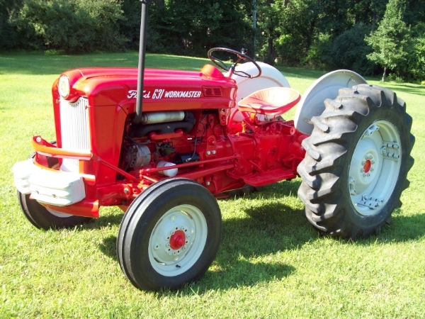

No real difference. The 601 was the series number the 641 was the model number. Here is my 631 with the side decal ford 631 workmaster. When the workmaster and the powermaster were introduced in 1958 all side hood decals indicated the model number in 1960 they change all hood decals to read the series and not the model number anymore. The tractor rod330 showed was a 1958 so original hood decal would have said 641. The 601 decal was put on when tractor was repainted. It's still a 601 series 641 model tractor. The difference in your Dad's 641 and their 601 could have been a diesel or different trans or auxiliary trans.
If the tractor rod330 showed was actually a 1960 or later as the hood decal indicated I don't think it would have had a howard in it cause At serial number 54165 ford changed the output trans shaft to a fine spline shaft and I don't think howard ever made a fine spline shaft for the coupler.
Kirk
Thank you very much for the details Kirk. Your 631 is very nice!!!!
