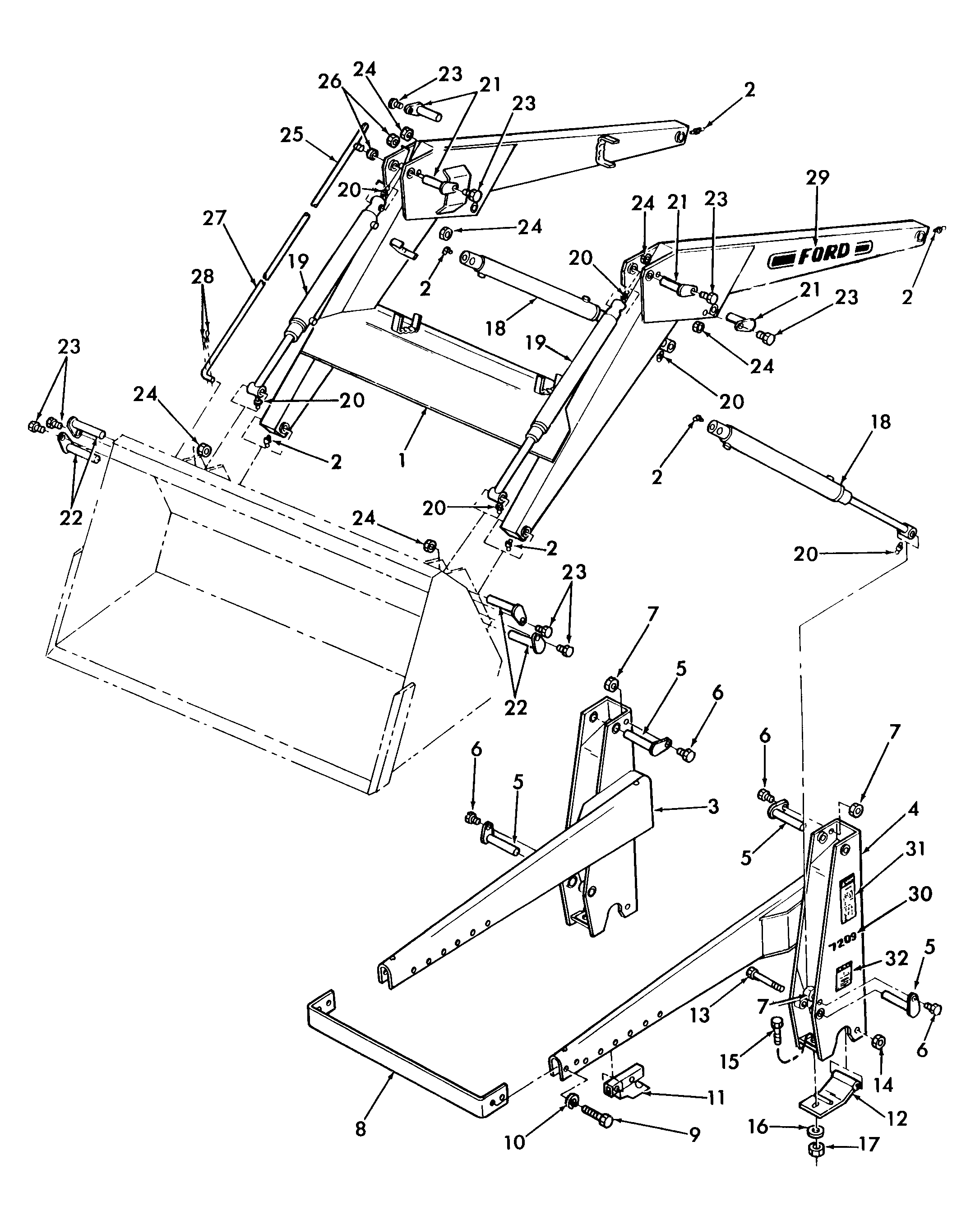

Greetings,
I have been on the hunt for a loader for my 6600. Today, I found a 7410 loader that's on a 4630 Tractor. The bolting pattern looks similar in the pictures. Any idea if the bolt patterns are the same between these two tractors? Thanks for looking.
   / Ford 7410 loader on a Ford 6600 Tractor? #2
Most likely the same bolt pattern, but the 4630 is a 3 cylinder and the 6600 is a 4 cylinder.
Look at the parts book for differences in the mountings. They made mounts for both tractors for the 7410.
Interesting link. Thank you. From what I can find, strength wise it should be ok for an 80hp tractor.
