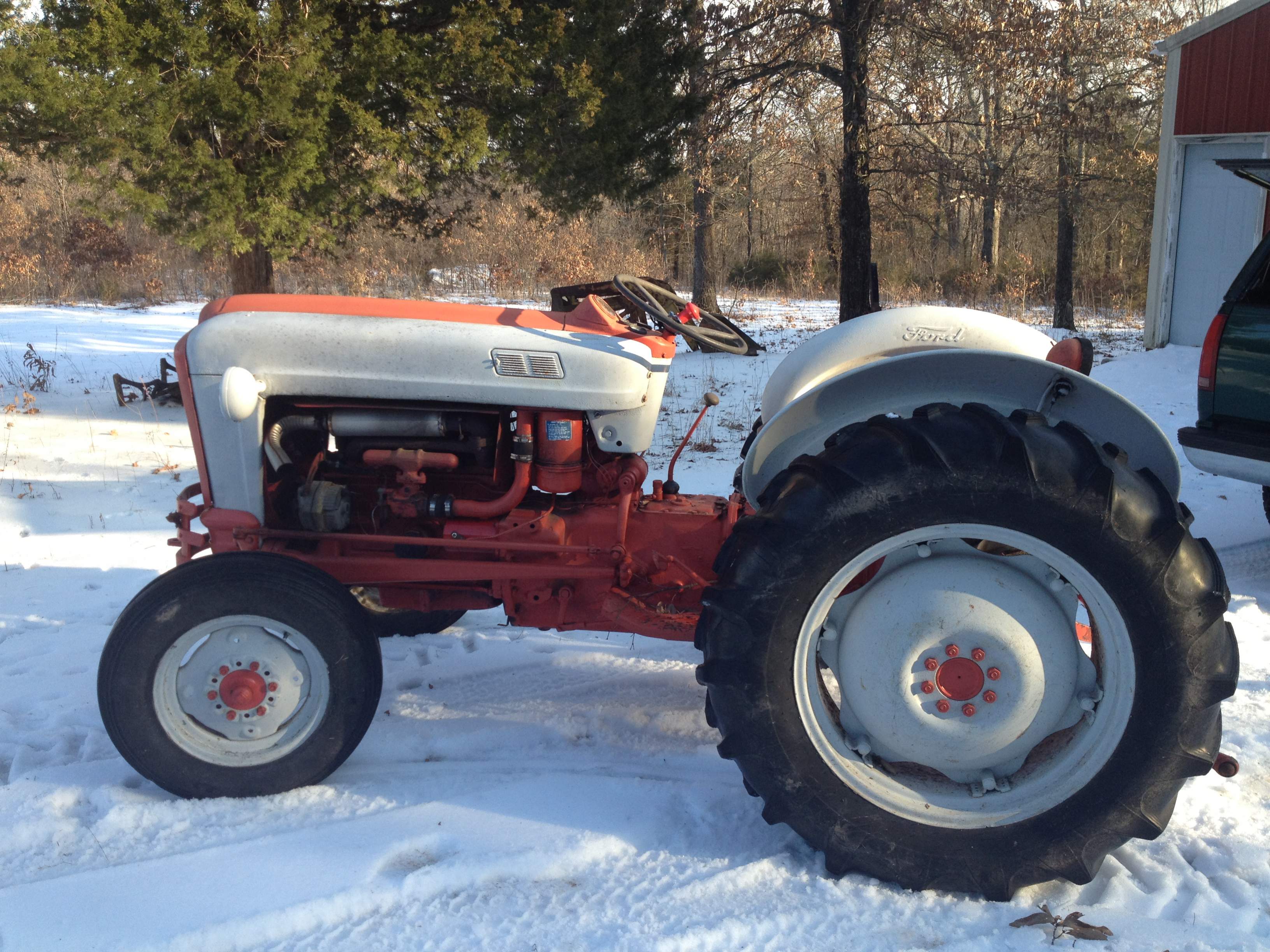

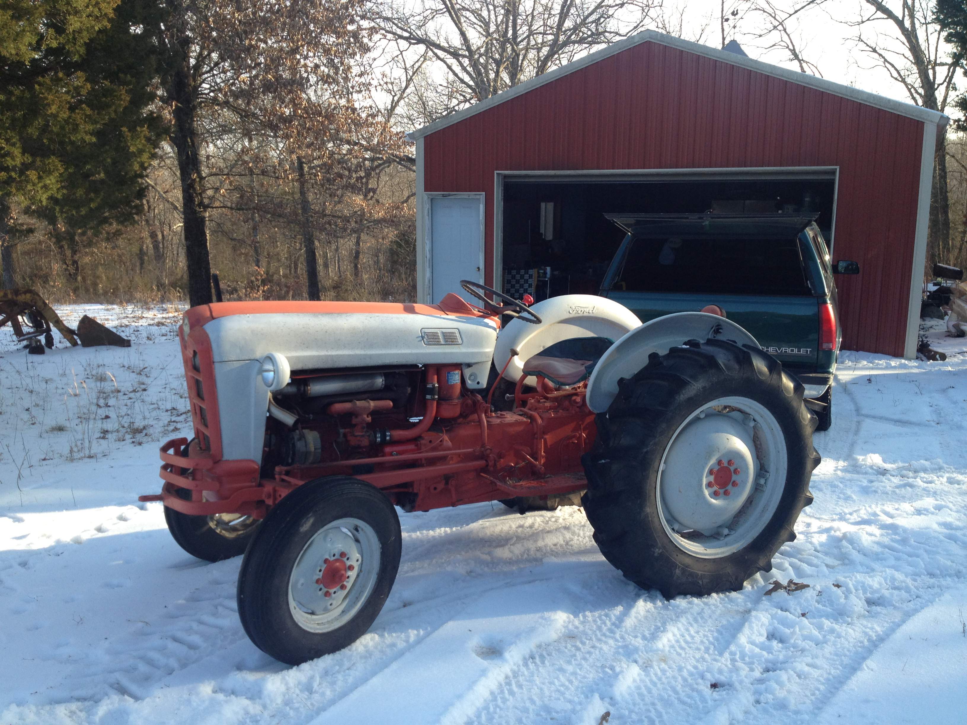

I have a 1961 841 as well. I bought it last year and have found that parts are still very easy to find. Most of the farm stores near me still have most of the common stuff and then there is ebay for those used parts you may need to replace. Mine just needed mostly cosmetic freshening up and to drive the gremlins out of the old butchered wiring the previous owner did. So I bought a new wiring harness for 12v conversion off ebay, and replaced all the electrical wiring and all the gauges. I bought the electronic ignition kit for it but I have yet to put it on just because it runs so great and starts so easy I almost don't want to mess with it. I love this tractor, to me its great therapy to just go tinker with it and clean it up and drive it around our place. I have replaced all the exhaust system and the water pump. Eventually later this summer when we move I'll put it to more work as were moving to a mini-farm. I have picked up a Davis front loader that I am going to clean up and restore and install on this tractor to help move mulch and compost around the gardens. I also have picked up a 2 bottom plow and a disc and will use it to put in the garden beds
And the exhaust in the pictures is what I replaced. I went with the factory long exhaust that comes out the rear by axle its so much quieter and I don't smell exhaust when driving.

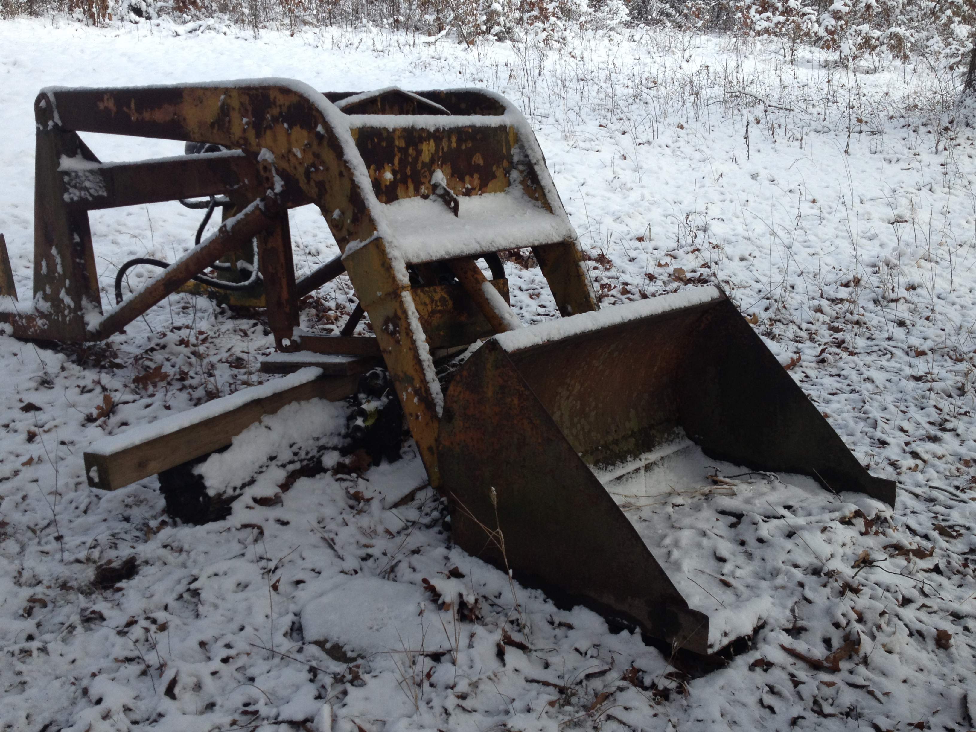

Yes mine has the front mounted crank pump. The caveat to getting the loader so cheap ($300 Delivered) was it was missing the mounts so I'll have to fab up a front mount. I found a set of rear mounts on ebay last year but the front one I am will probably going to make from scratch, I did find a parts manual for the loader and that has pretty good pictures of what it should look like. I just Missed a front mount yesterday on ebay that sold for $19... DANG IT!!!

Yes, the loader is pretty much self contained. The pump seems to do well. The loader works great and is in great condition. A little outside rubber coating is cracked on some of the hydraulic lines, but no leaks anywhere. I haven't lifted the loader off the tractor yet. 8 bolts seem to be all that hold it. We'll probably take it off in the fall and hang it on a gantry crane. Thanks for asking.
