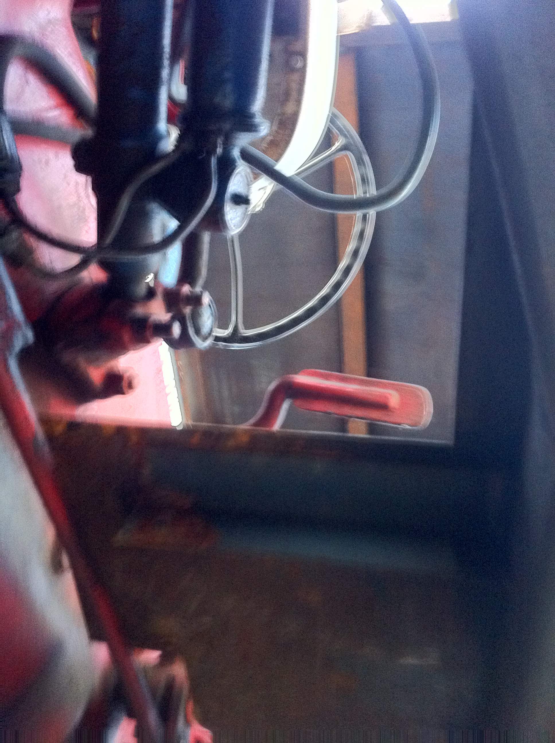

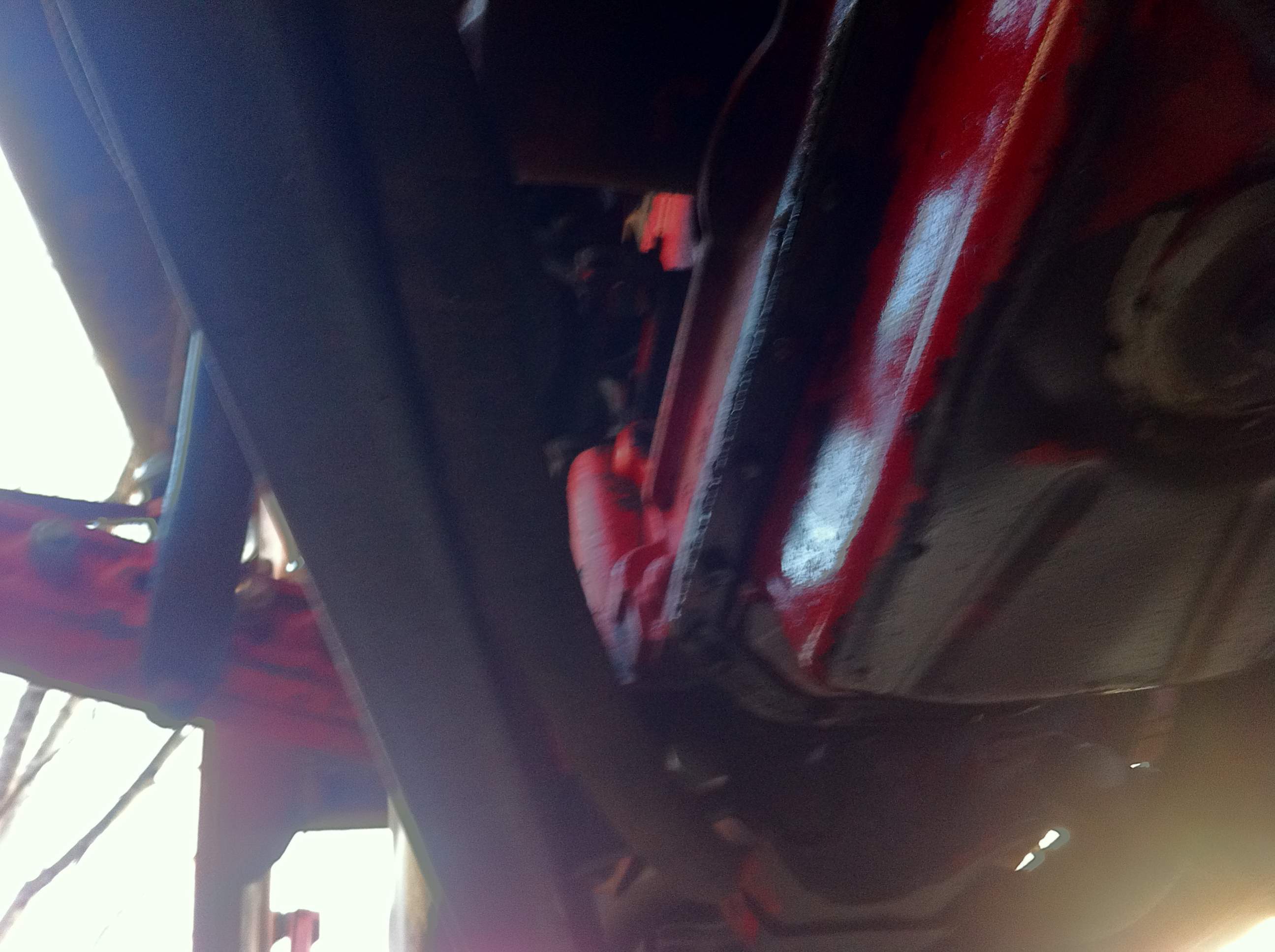

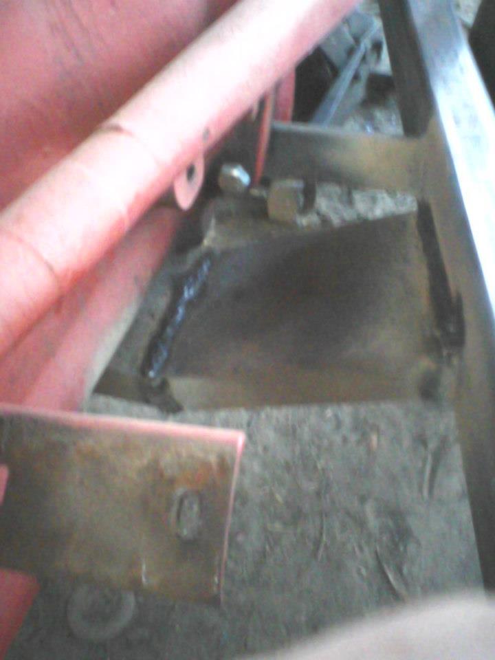

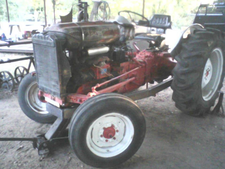

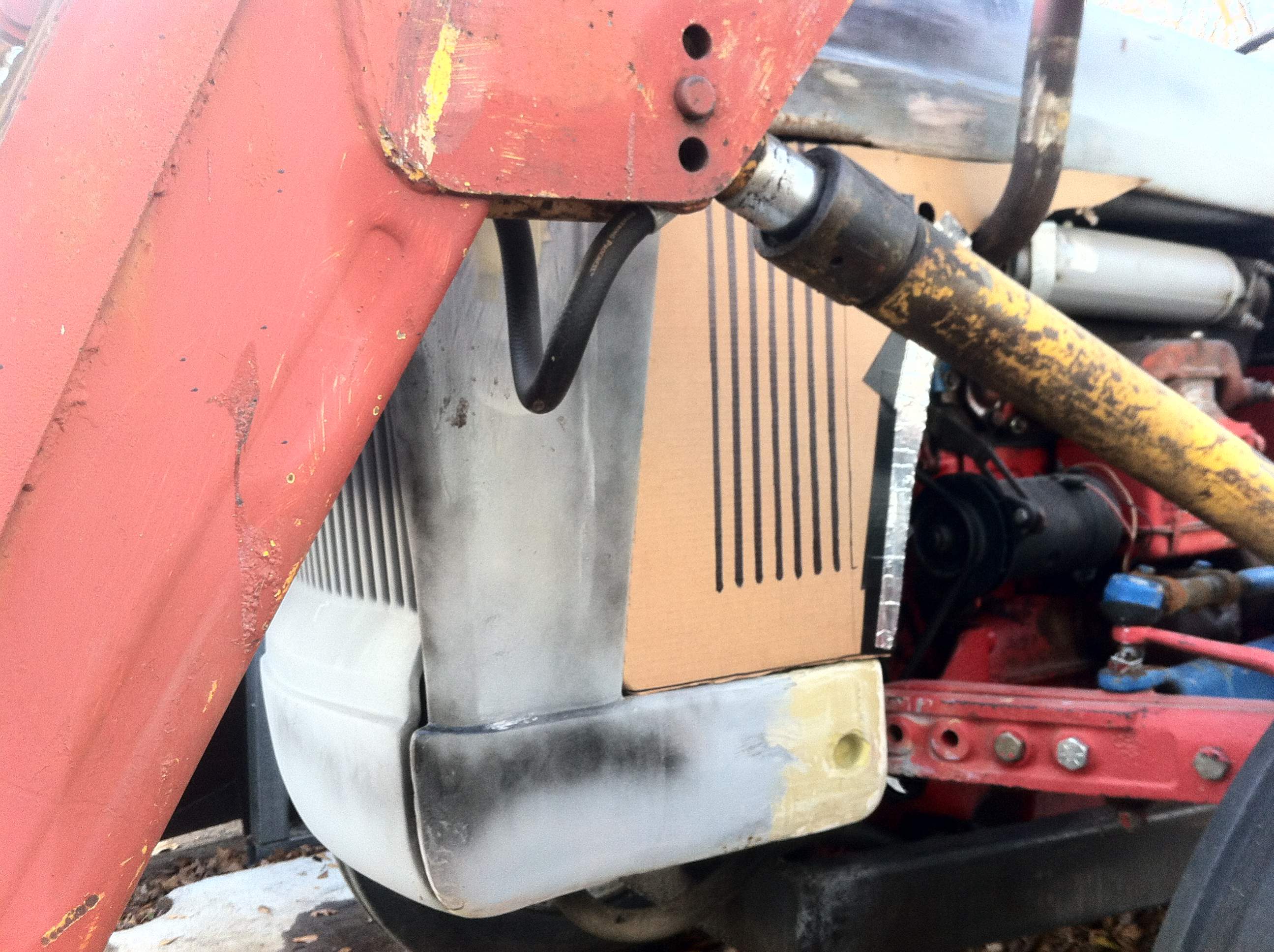

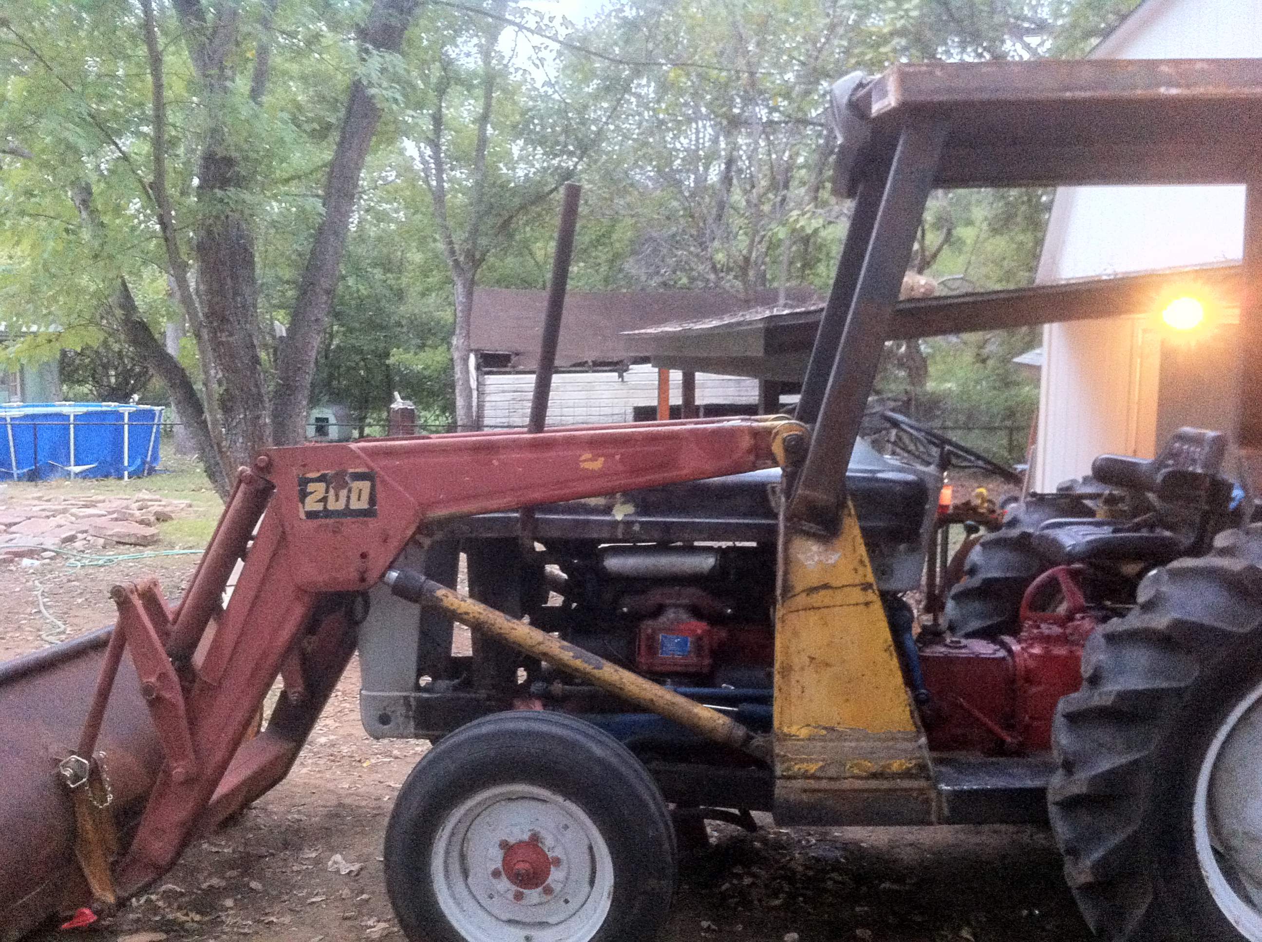

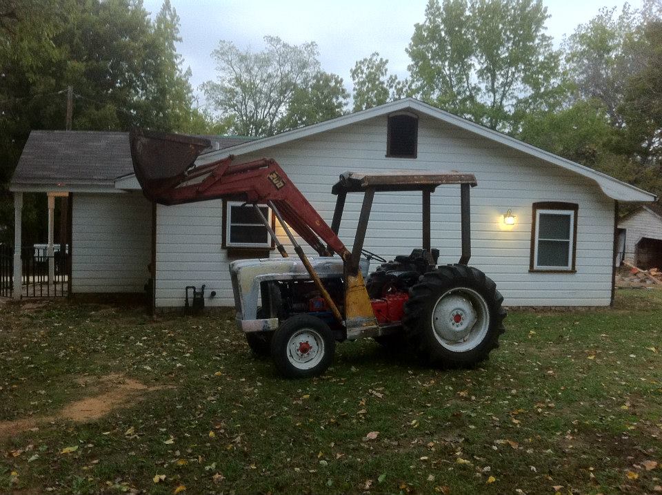

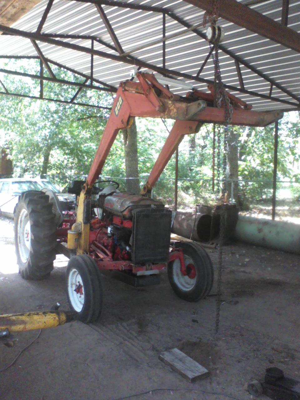

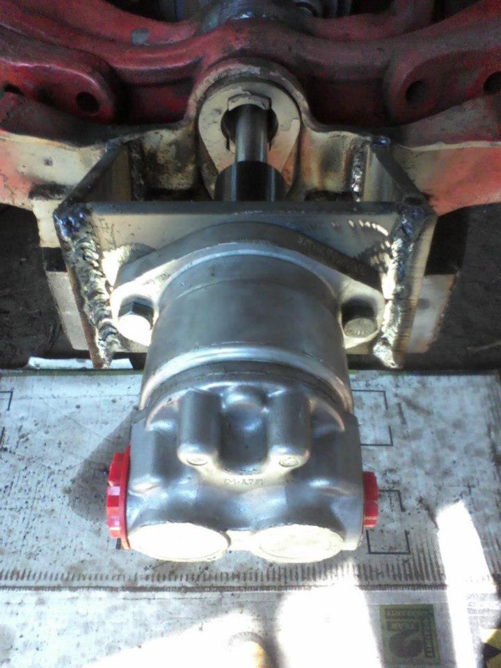

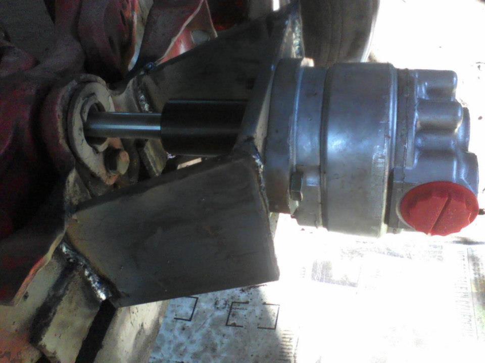

44214_3675103279361_595928437_n.jpg581464_3675106039430_1722126142_n.jpg155680_3675107999479_1348469261_n.jpg397255_3675111159558_1860712560_n.jpg404592_3675079918777_2055500_n.jpg528686_3675077158708_1129516197_n.jpg560385_3675116199684_1476826062_n.jpgThis is my first attempt at any real 'modifications' & I have made plenty of mistakes, but I've learned a lot (from this site especially) along the way. I started off with a Ford 841D, it ran really well, but hydraulics had some issues, along with 500 other things. There's still lots more to do, but I've come quite a ways. I don't have pictures 'up to date,' but I thought I would show a few of the progress. (If I can figure out how to upload)... Any suggestions/advice is welcome!

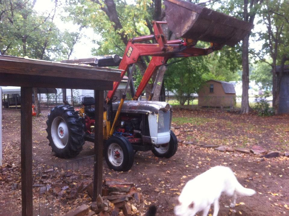

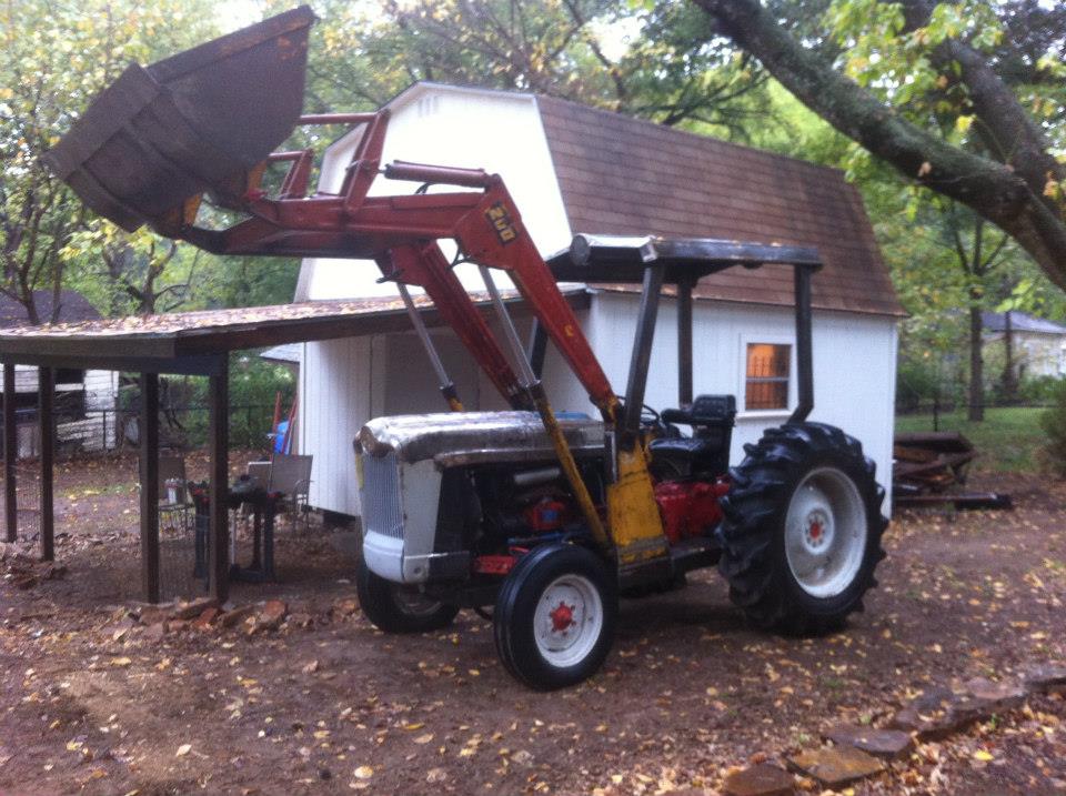

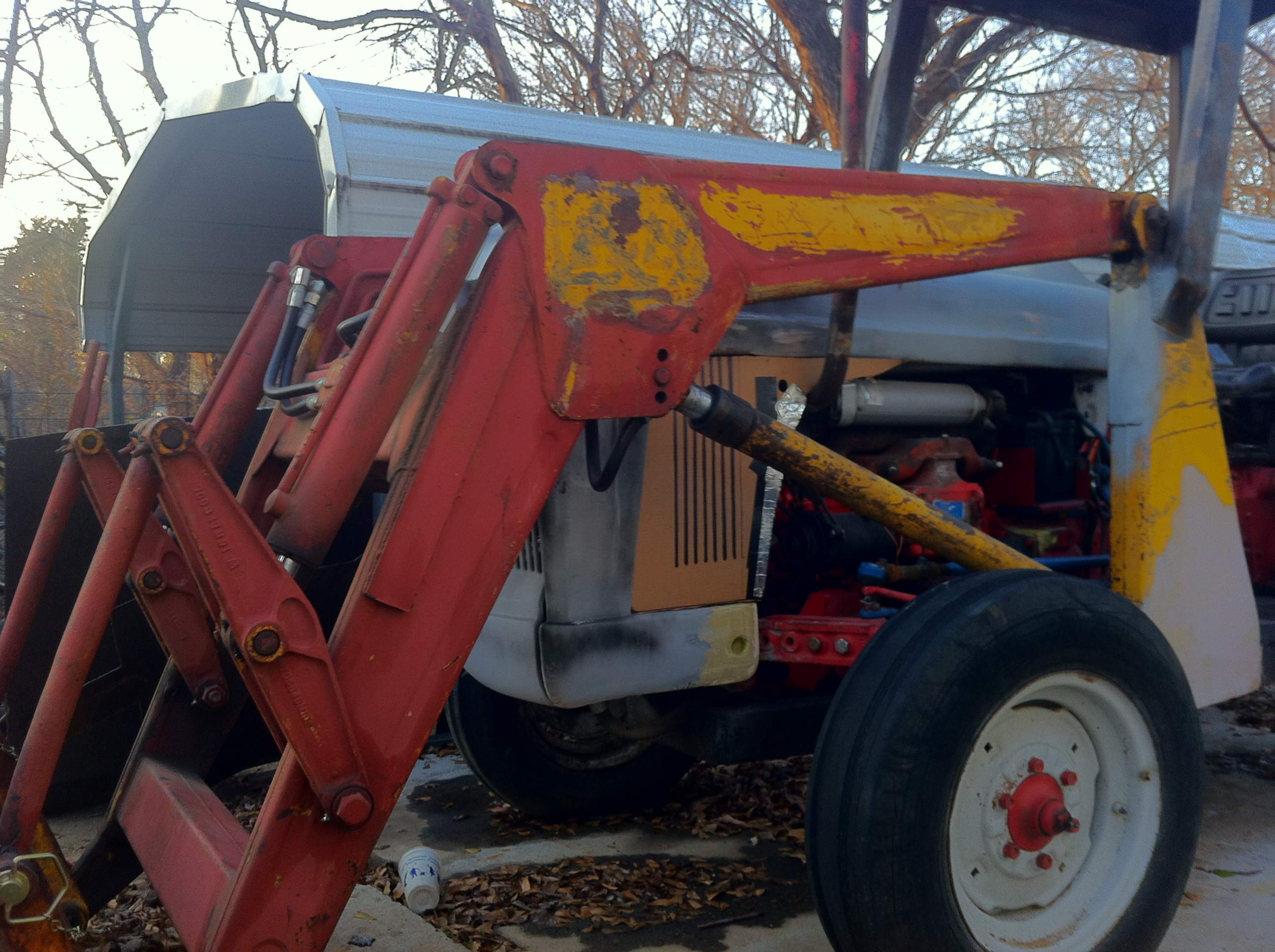

I wanted to add a loader & I got a really, REALLY good deal on a backhoe/loader combination. (I don't know what to do with the loader, it's way too big for this tractor, but it was worth it)!23868_3675071958578_99300482_n.jpg

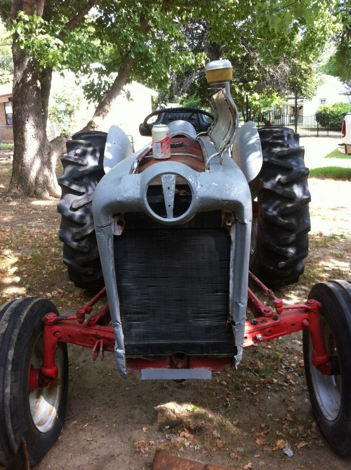

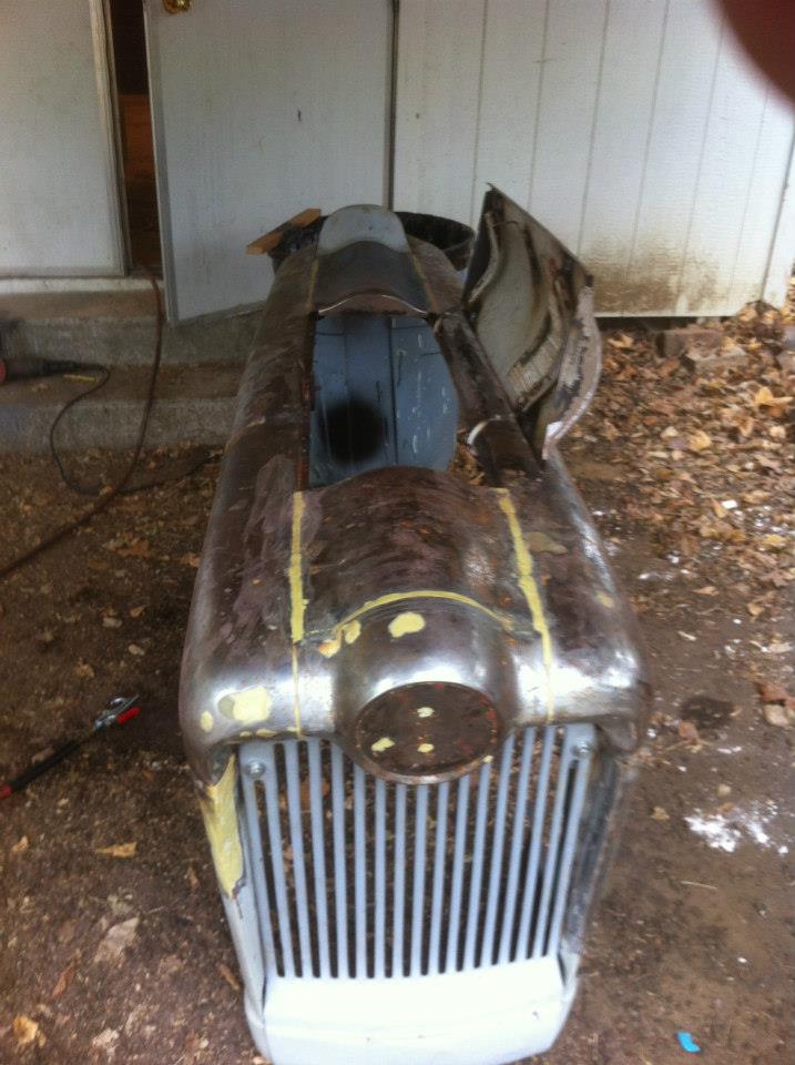

I will go down the list of everything that has been replaced/added, but I just want to tell everyone upfront - I had to replace most of the sheet metal & so I decided to cover the front pump by stretching the hood. I don't have any pictures of the finished hood, but it really turned out pretty nice (I had never seen the front hydralic pump covered).
155680_3675107999479_1348469261_n.jpg250077_3675098279236_798062142_n.jpg384116_3675114279636_1244134096_n.jpg548557_3675137880226_908007793_n.jpg550895_3675129440015_1900026359_n.jpg559582_3727523029822_610646148_n.jpg560385_3675116199684_1476826062_n.jpg577319_3727504789366_1541515148_n.jpgphoto.JPGPicture 495.jpg

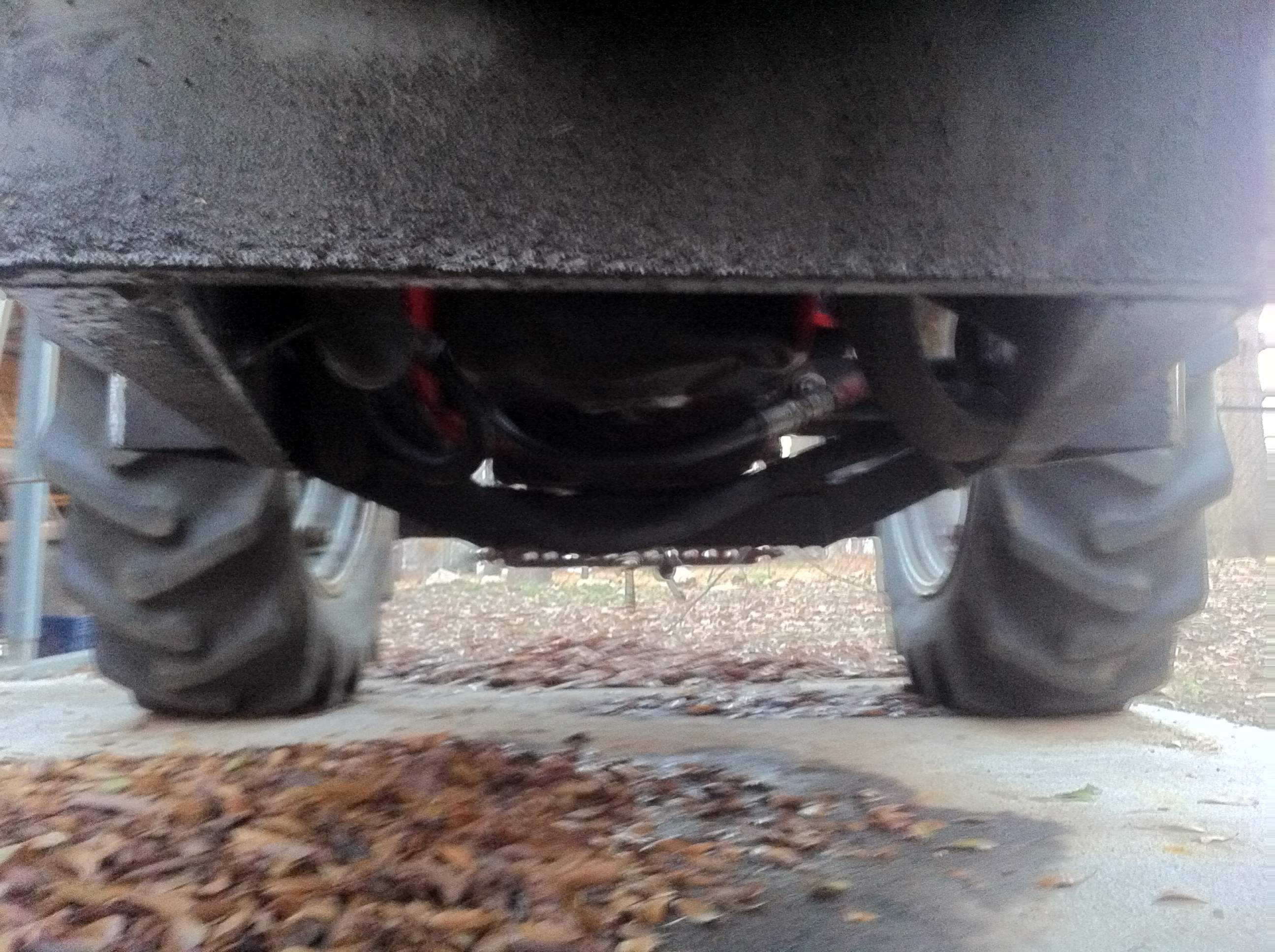

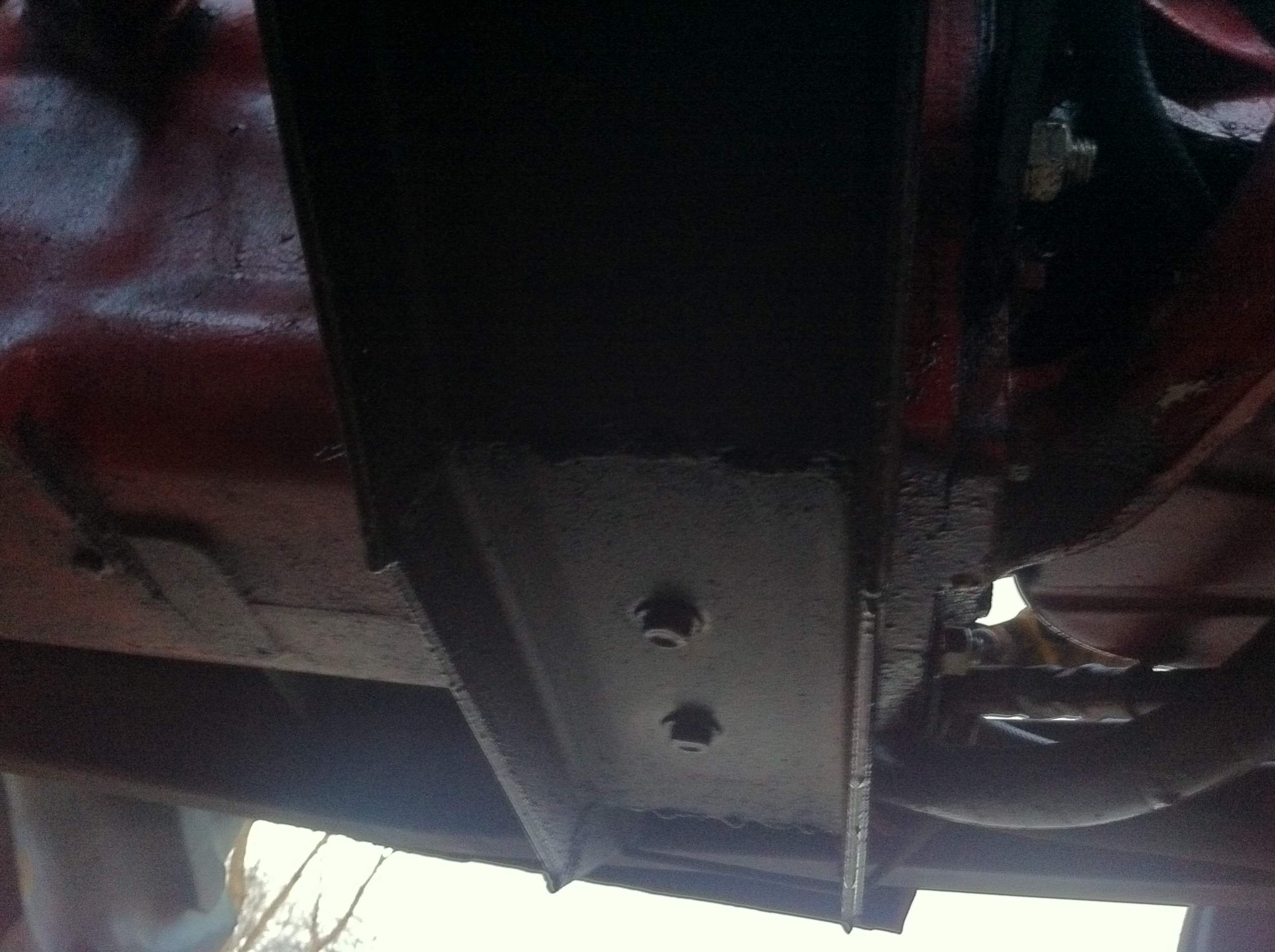

IMG_4505.jpgIMG_4509.jpgIMG_4511.jpgIMG_4513.jpgIMG_4515.jpgIMG_4517.jpgIMG_4518.jpgIMG_4523.jpgIMG_4525.jpgIMG_4531.jpgIMG_4533.jpgIMG_4535.jpgIMG_4537.jpgIMG_4539.jpg

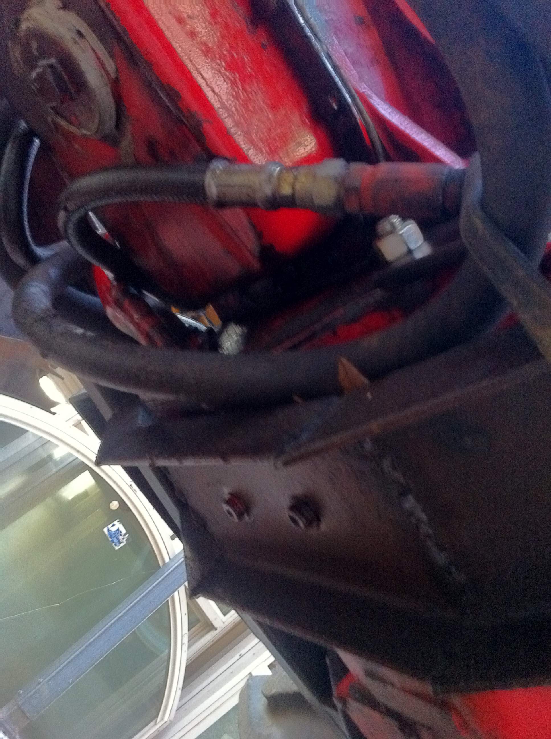

Again, I don't knw exactly how to load these photos correctly, but I will work on it. First, please excuse the messy hydraulic hoses under the tractor, those have been straightened out (I couldn't believe how difficult it would be to learn all the different fittings/etc....)!

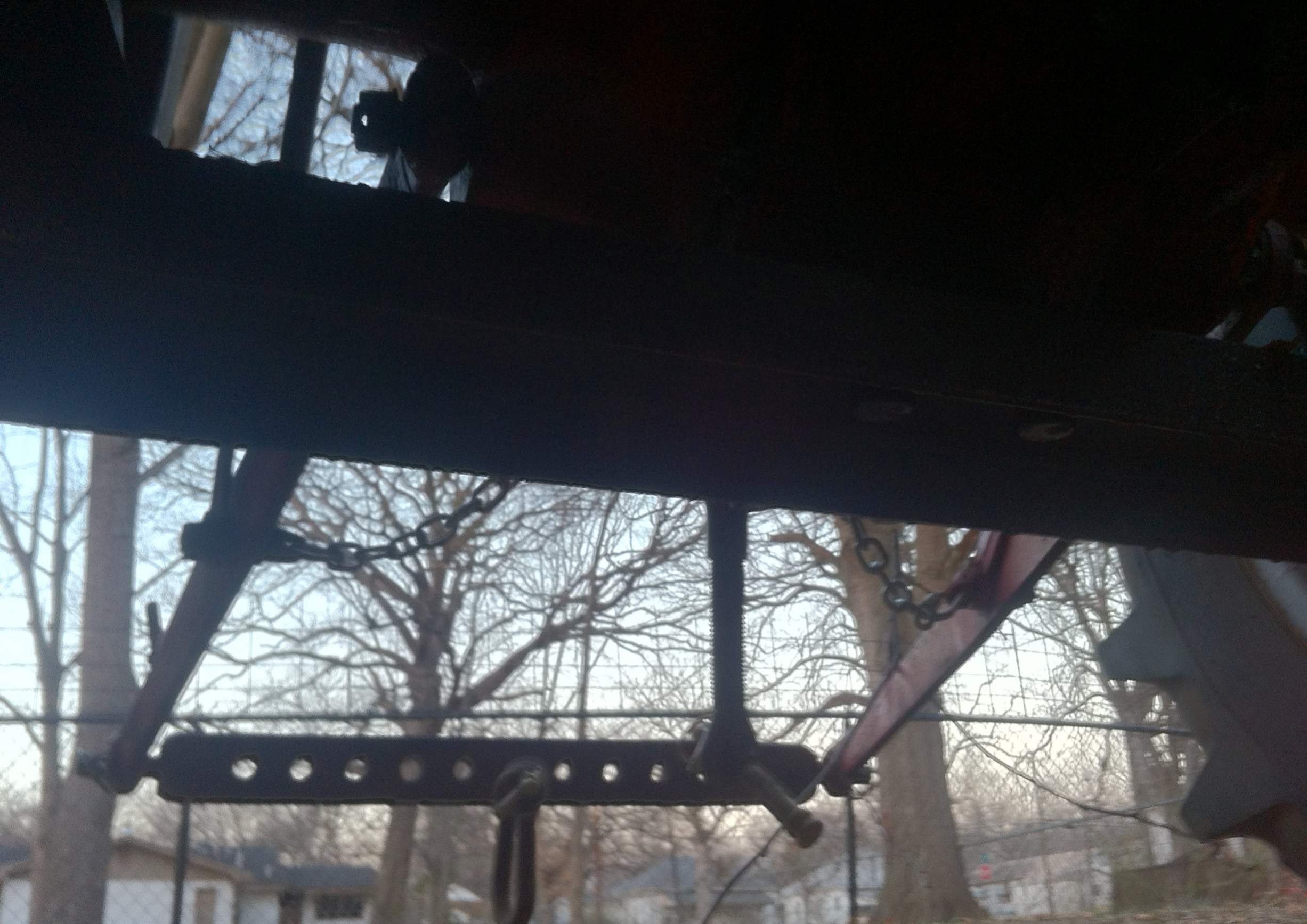

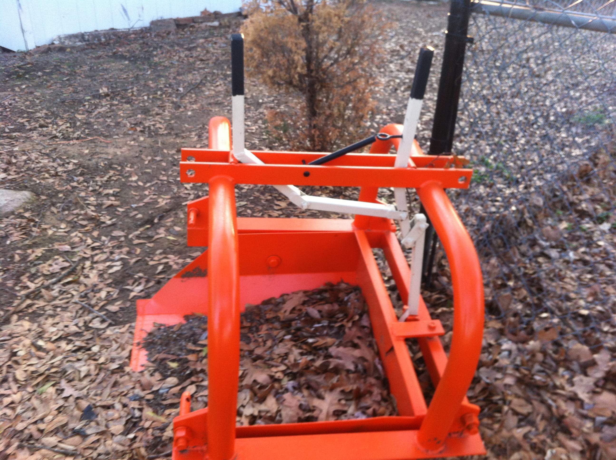

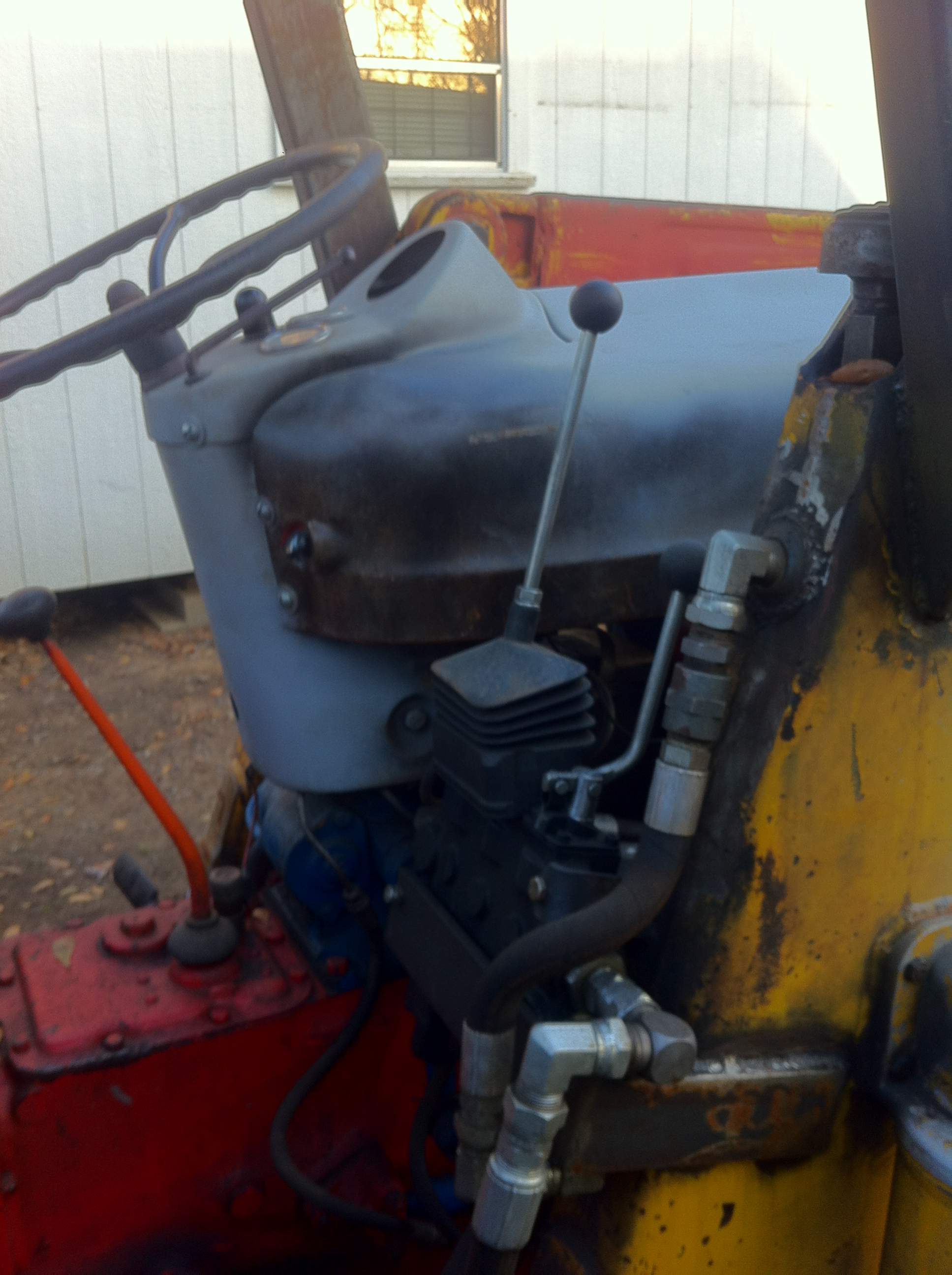

I am proud of my rear remotes, I wanted to have some like Soundguy & some others I've seen on here, but I only found a few & they were $$$. This remote is the old loader controls with the levers cut & switched.

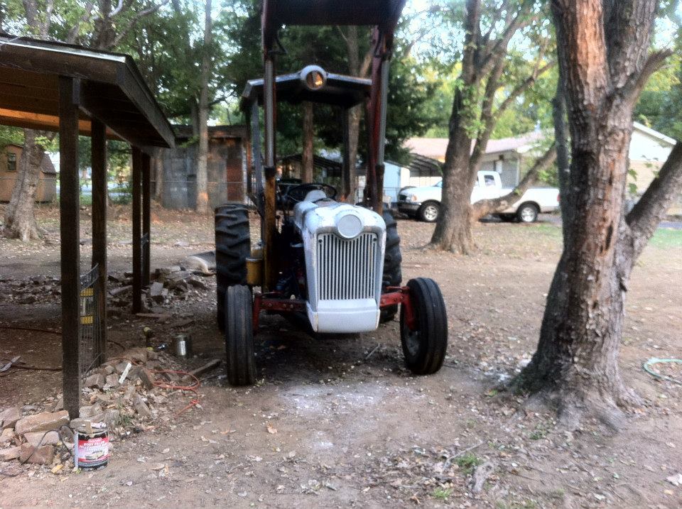

I know the ROPS/Cover isn't standard, but it is tied together pretty well. I would like to find some weights for the back tires...

IMG_4502.jpgIMG_4502.jpgOh, the cardboard cutout was an early design for the sides. (I had the remnants of an old grill & wanted to utilize them in the design, if possible. Is an OS like a scoop on the back? I did find one of those for $20! I bought it, but it had issues releasing the dirt. I took tips from another forum & design a little trip mechanism & it works pretty well.

Looks pretty neat..I sense you have done some sheet metal work in the past.
/ Ford 841D - first tractor project (modifications)
#9
Thanks, I appreciate it (I'll get some better pics posted...). No I've never done any kind of body work, I just never like to see the pumps showing upfront & I figured the sheet metal that was on it was in such bad shape, I could piece together a longer hood - it really wasn't too bad. I wanted to keep the original look as much as possible, so I've tried to keep most things the same style. (The 'cab' is not exactly what I wanted, but that can change)! I really wanted to mimic the curved edges of the original, so there's still work to do there...

Here's a few pics from the next step - the additional side panels for the hood.tractor 024.jpgtractor 038.JPGtractor 046.JPGtractor 067.JPGtractor 060.JPGtractor 081.jpgtractor 084.jpgtractor 113.jpgtractor 124.jpg

Thanks! Here's a few more pics, I thought that using some of the old grille & pieces of old dog legs help it to still appear "Ford."004.jpg009.jpg014.jpg

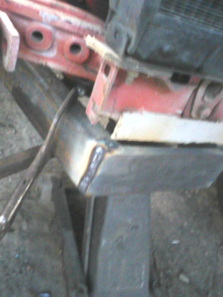

Here's a few shots of the hood panel - driver's side. They aren't completed in these pics.008.jpg009.jpg010.jpg016.jpg021.jpg027.jpg
#18
image-560085811.jpg I tacked the first side together this evening.
