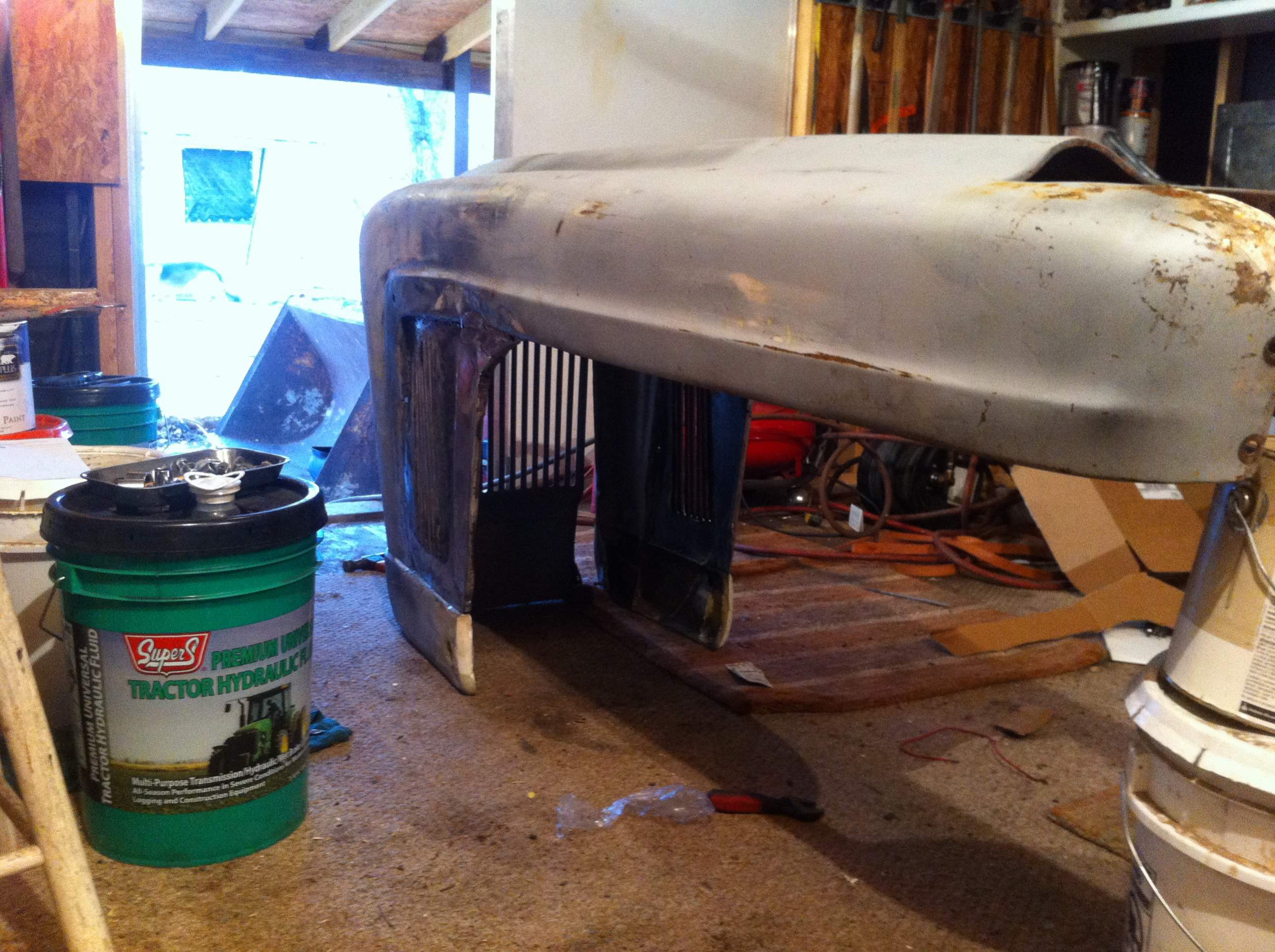

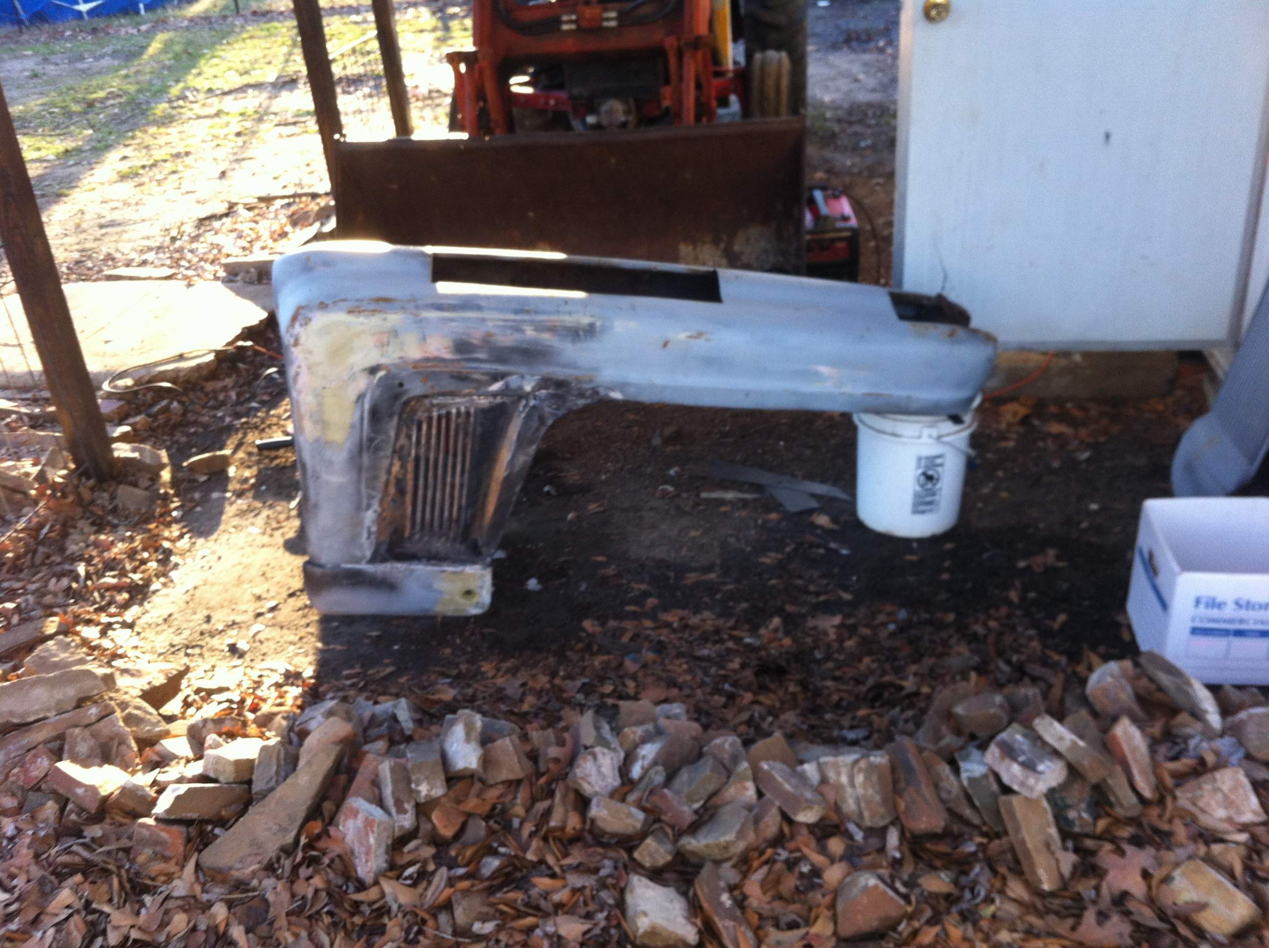

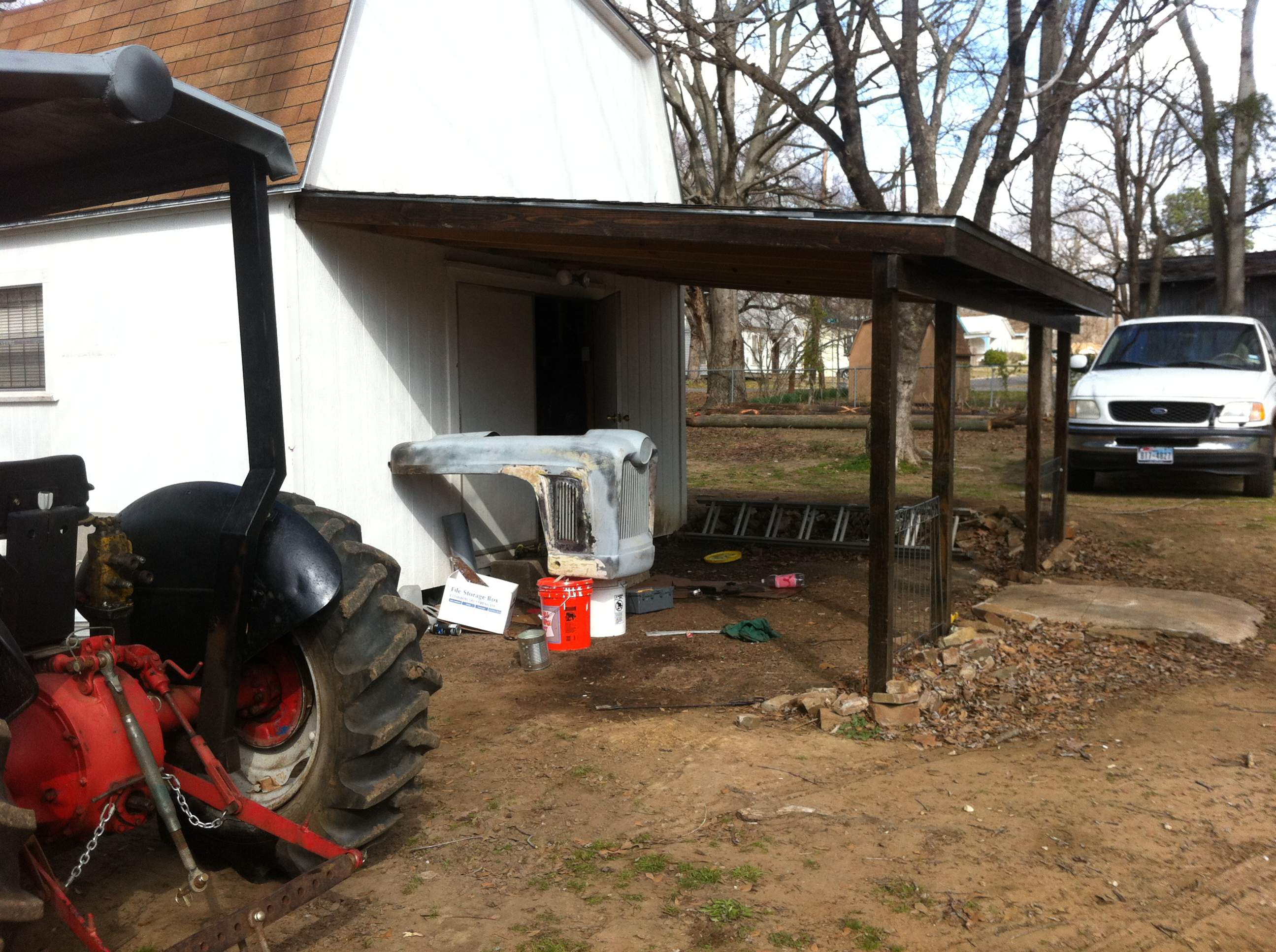

image.jpgI did squeeze in the time to tack the driver's
side panel together this pm. The two sides are
Matching up nicely. I'm going to try & clean it
up and maybe get a little primer on it just to
Sorry for the poor quality pictures, I'm not very good
With these mobile devices.

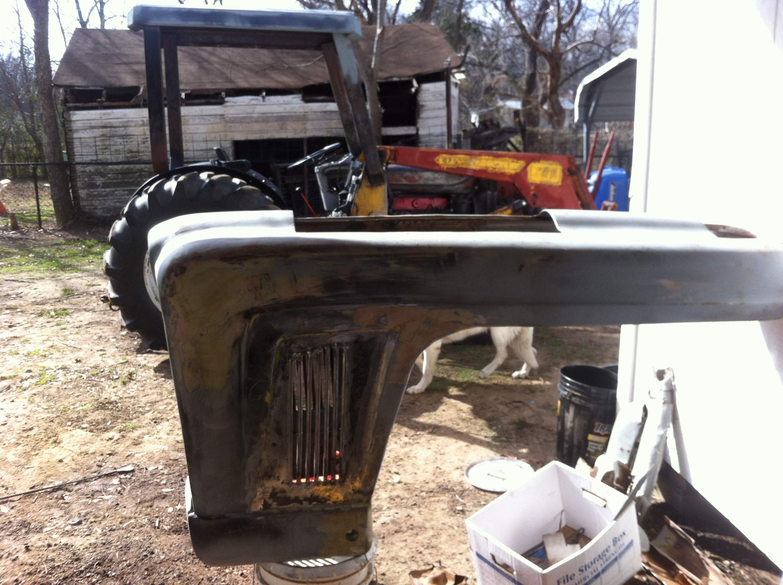

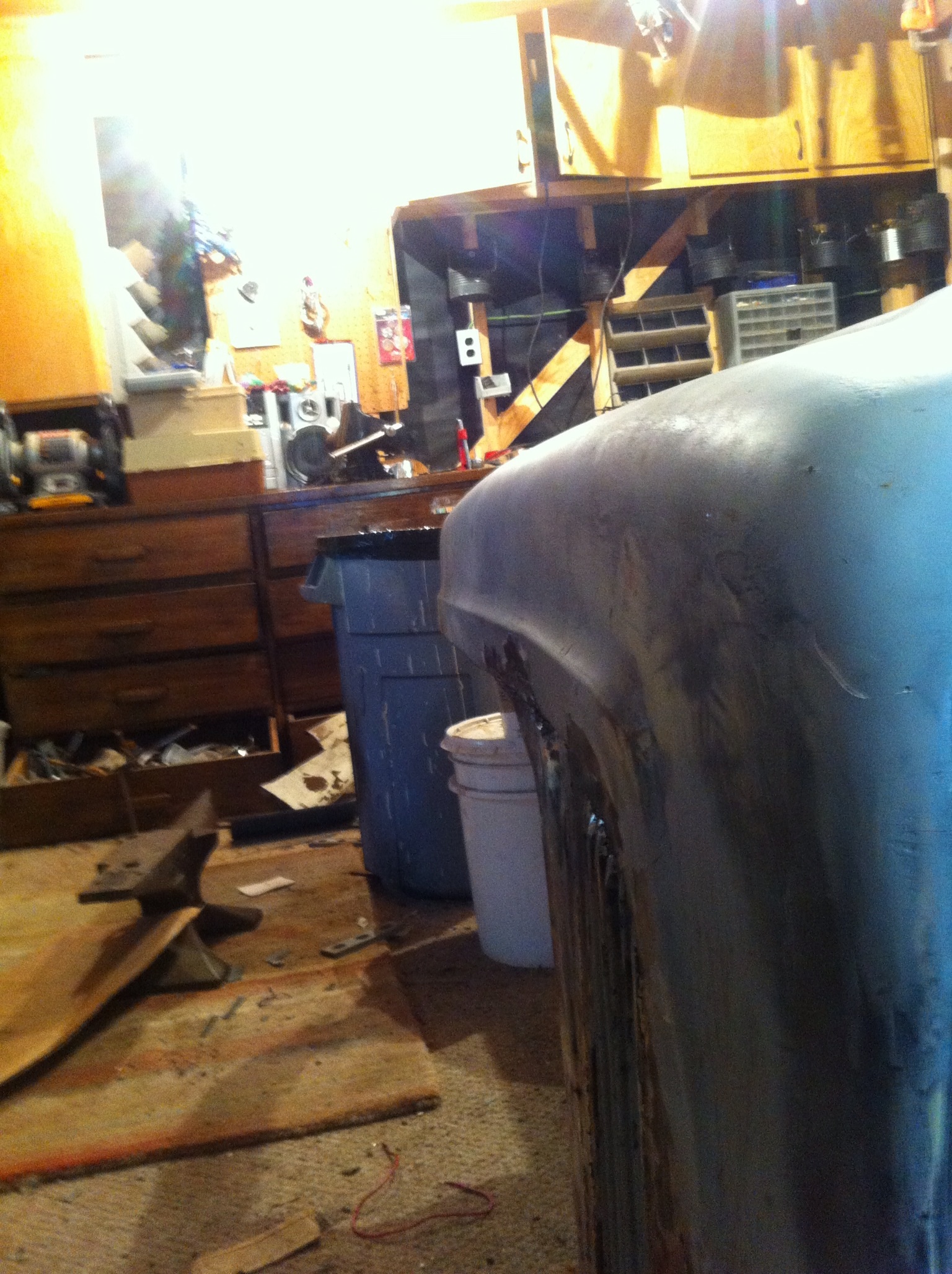

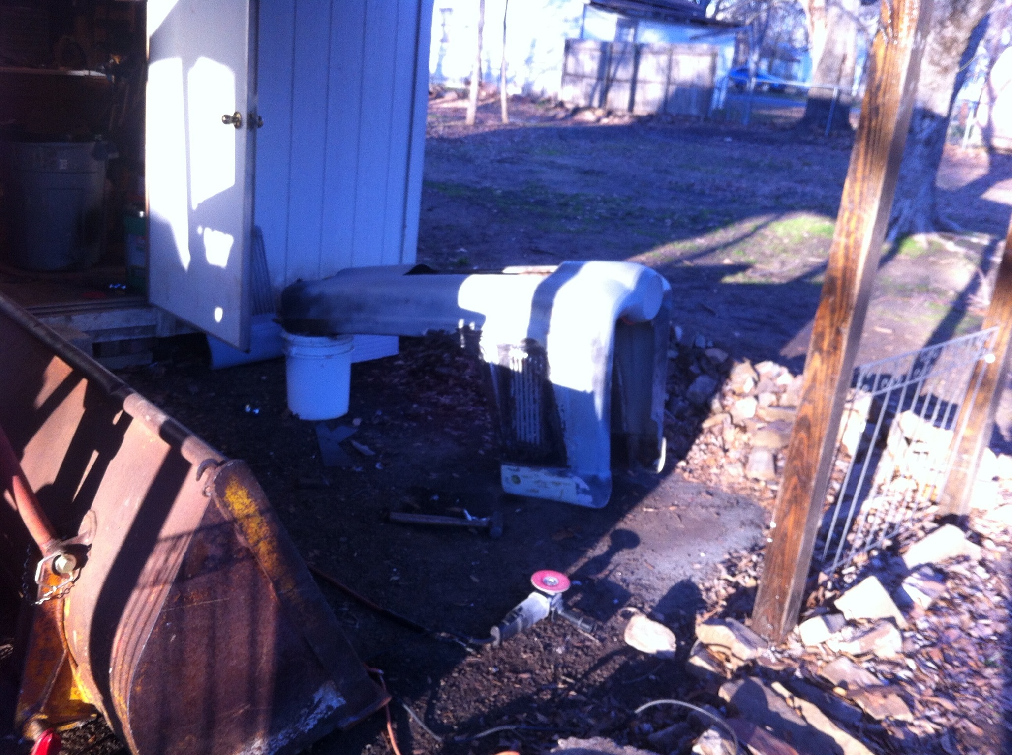

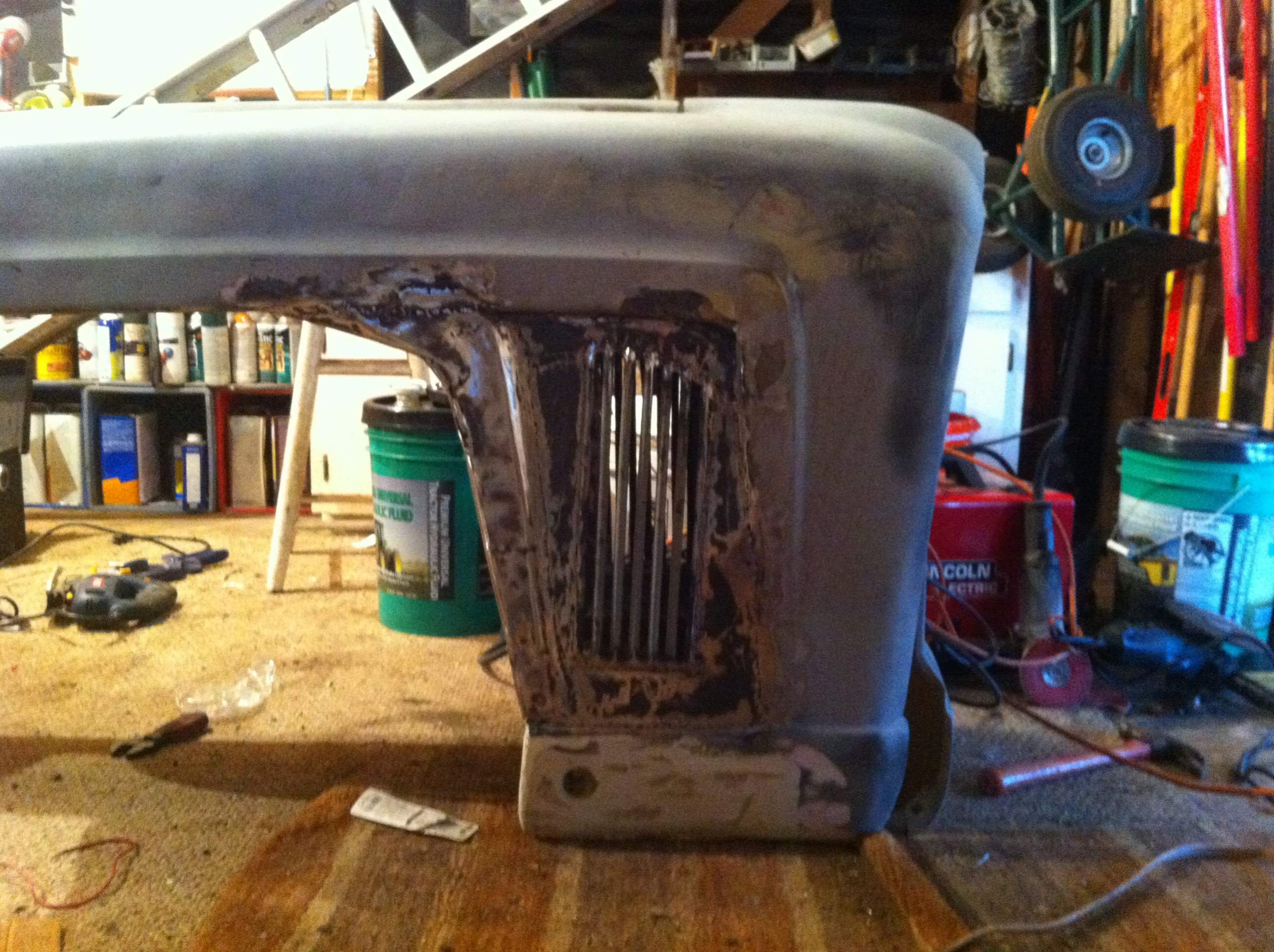

Gonna get this hood sorted out properly & primed this weekend.004.jpg006.jpg
   / Ford 841D - first tractor project (modifications) #25
Looks great. :thumbsup:

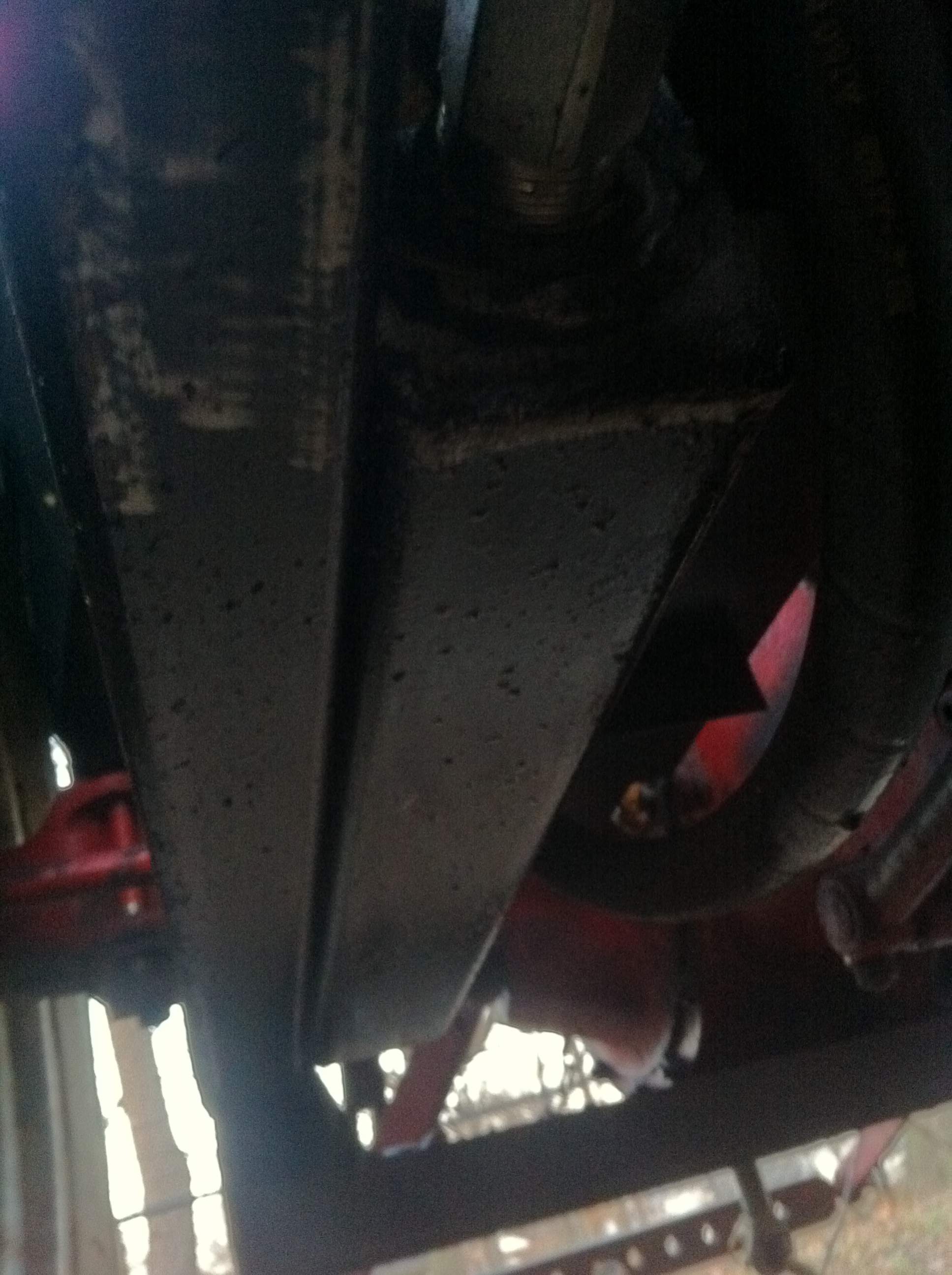

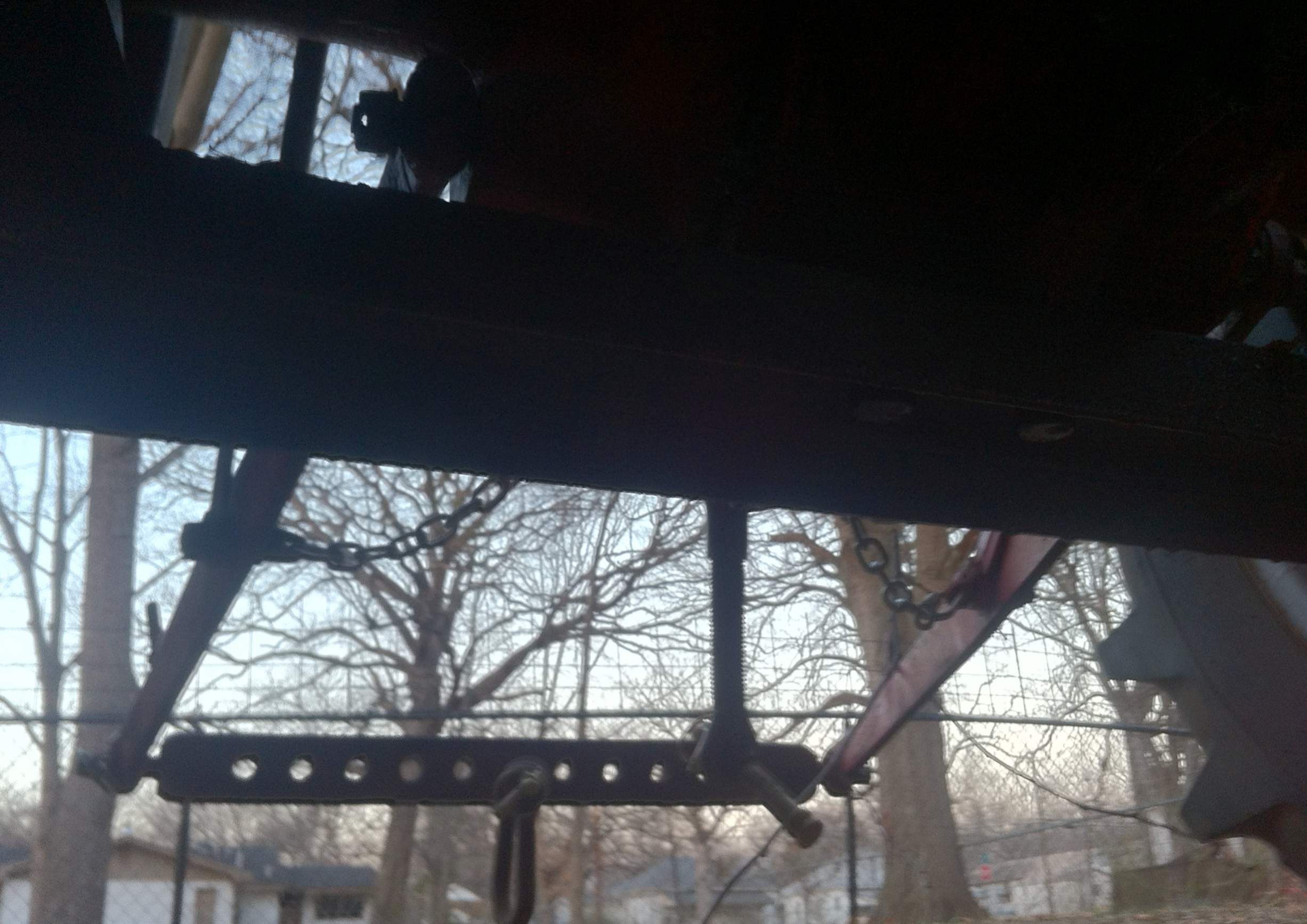

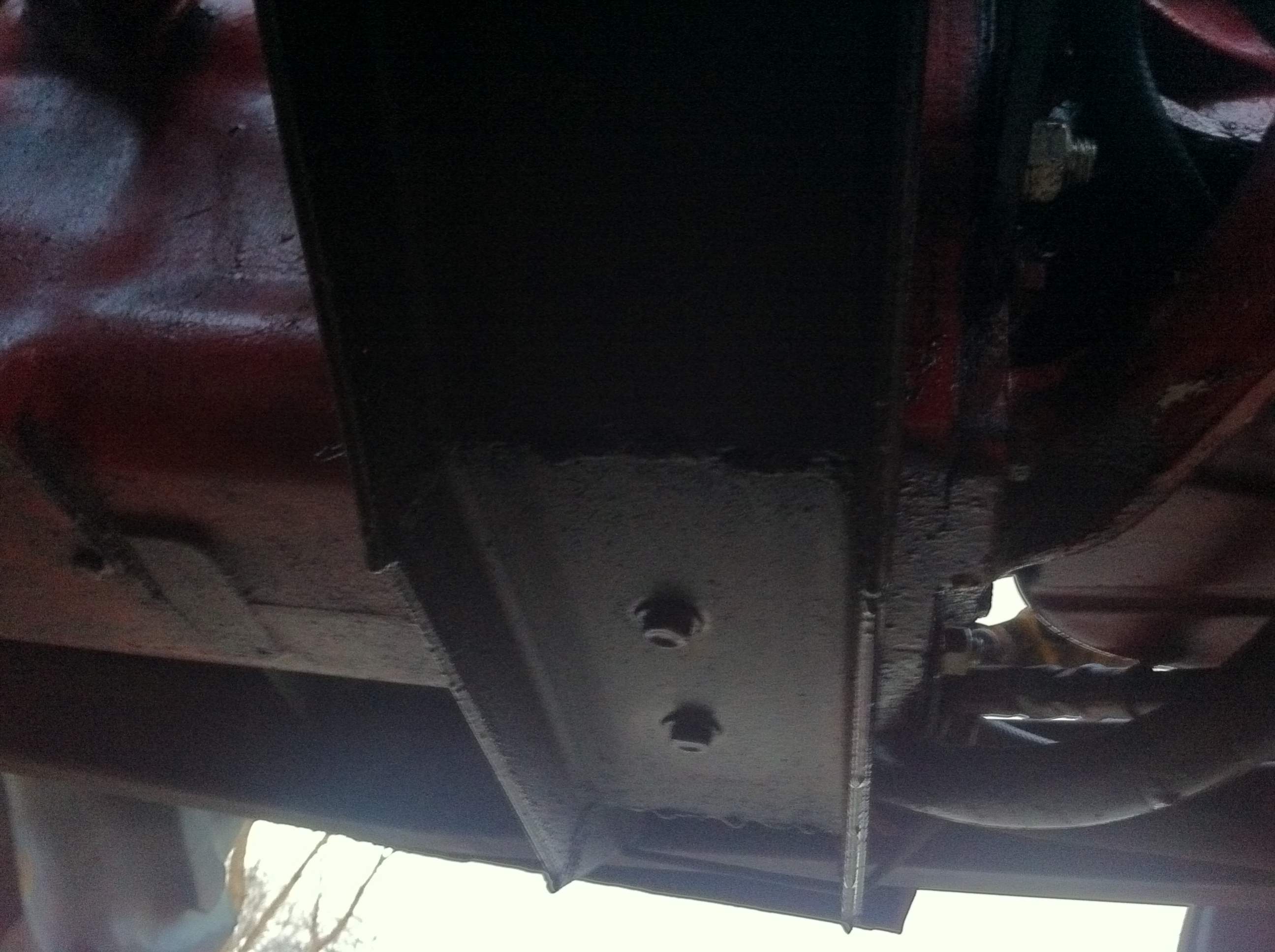

Looks good, could you post a pic of how you have the rear ROPS attached to the rear, I want to add this to my tractor and I just want to see how other people have done it
   / Ford 841D - first tractor project (modifications) #27
rops attach to the rear axle at the fender bolt locations.

I built subframe from front to back & bolted it every place the housings came together. I also bolted a cradle underneath each. I did attach the back end at fender bolts, but also added a cradle bar underneath. Everything is tied together, I don't know if the set-up is proper, but it is pretty stout. I don't have any photos with me, but I will take some tomorrow. If you look at my first or second post, there may be a few there.
#30
These were in the thread earlier, I just copied them. They are hard to make out, will get better ones...IMG_4533.jpgIMG_4535.jpgIMG_4537.jpg(the bit next to subframe in 2nd photo is just a return for rear remotes).
