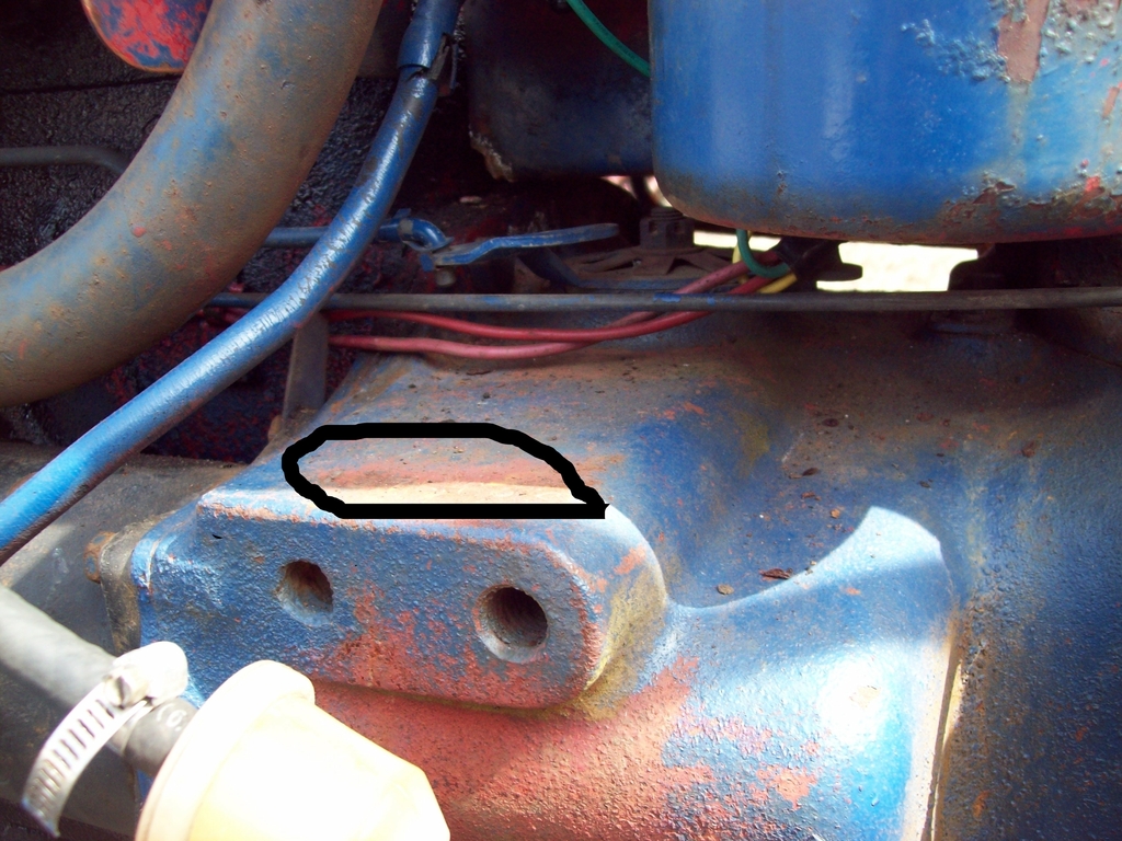

I have a C0NN-6015G - 134 sleeveless late 1962-1964 it is in a ford back hoe and I am trying to get parts for it at the local parts house and they want to know the model. Can anyone tell me the model or series #. I posted it as an 800 series but I am not sure. and where can I get a manual for it? I am planning to rebuild it if it isn't too badly worn out as it is a sleeveless engine.

With the 134 engine, if not a transplant, it would probably be a later 601 or 2000. Post a photo if you can. The IT manual# FO-20 shop manual will cover your tractor and can be picked up at farm stores like tractor supply or even on Ebay.

You can check your model and serial # on the flat spot just behind the starter above the 2 holes.

as kirk said. a late sleeveless 134 will be like a 601 / 2000.
you can have those bored for sleeves.. etc.
