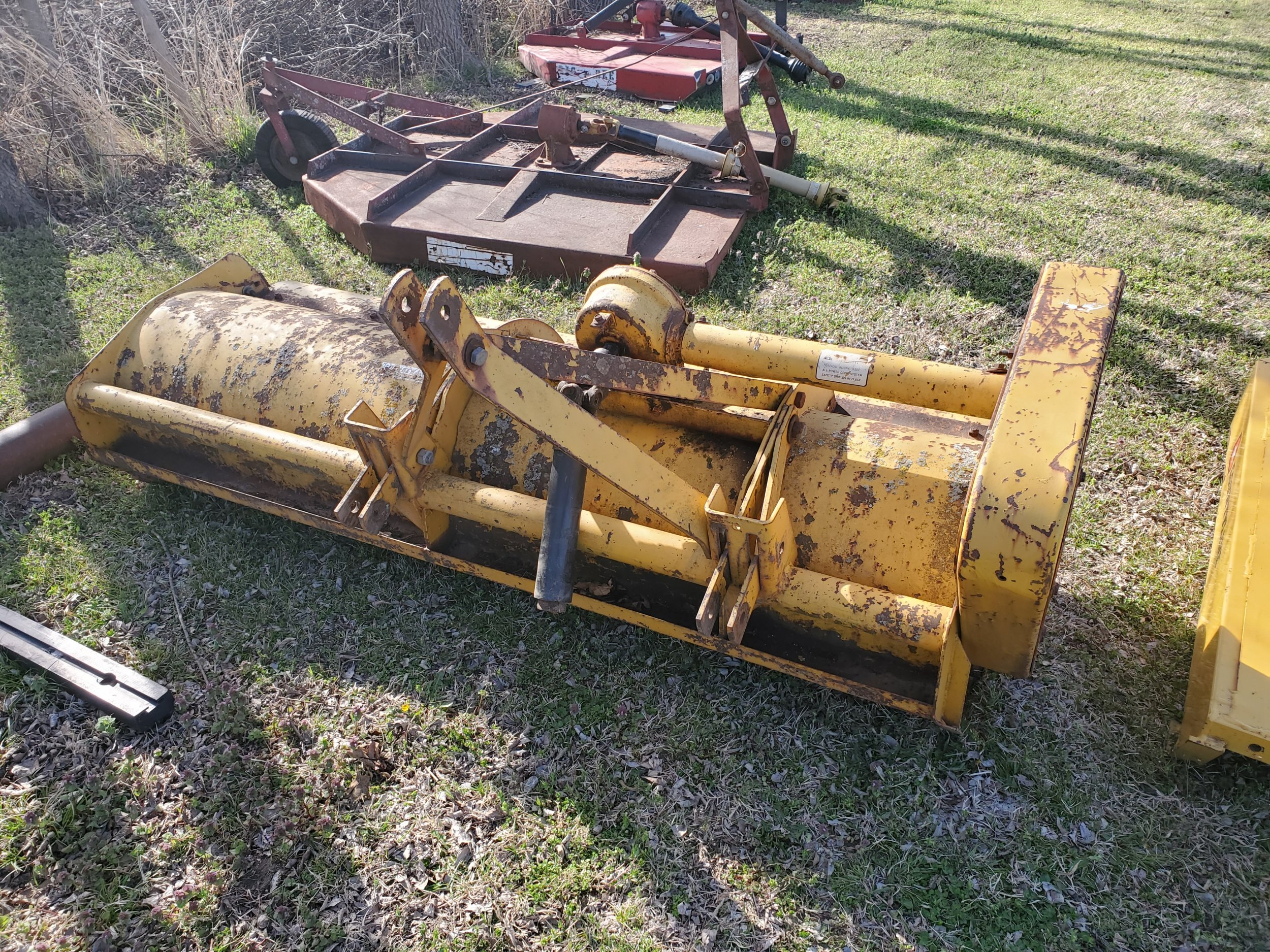

Hi all,
Picked up a 917 Ford flail yesterday for a few hundred bucks. Overall in solid condition and the bearings all seem to be tight and everything rotates freely.

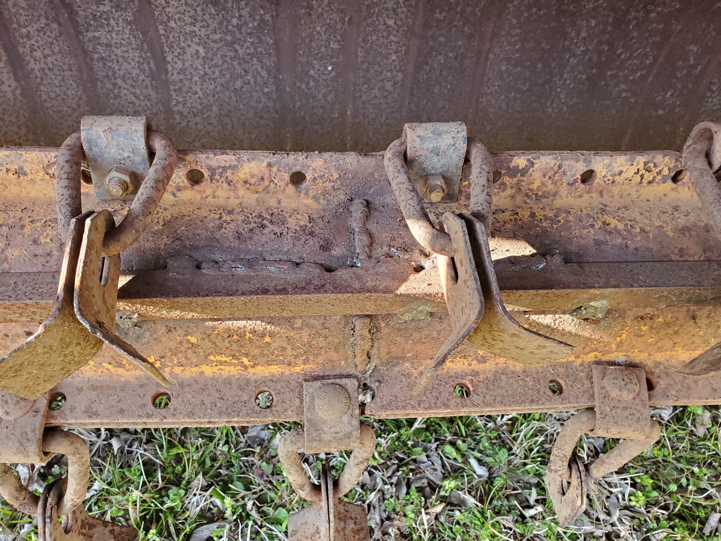

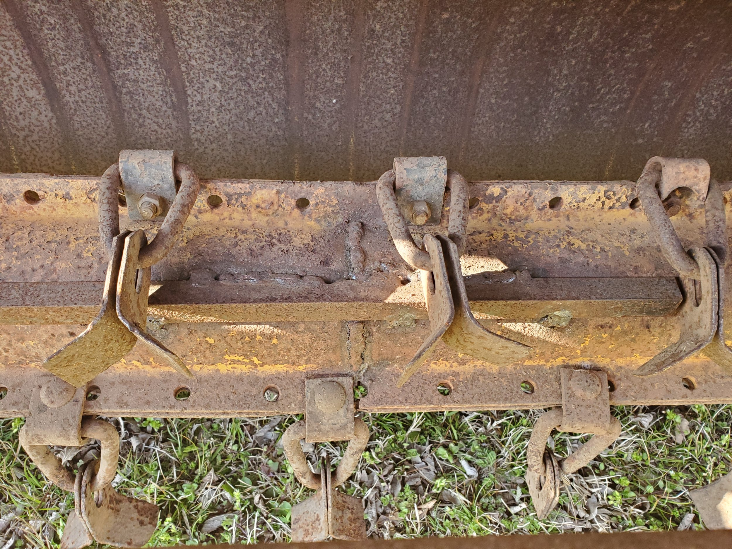

No for the not good! The main rotor is damaged. You can see in the pictures where someone tried to weld to hold it together but it is a little bent and likely not repairably.
So, what options? I'll start looking for a replacement drum.
Is this something a machine shop/welder can rebuild?
Also looking for an Owners Manual. So far my search has brought up Parts manuals only!
Thanks for any advice on this.

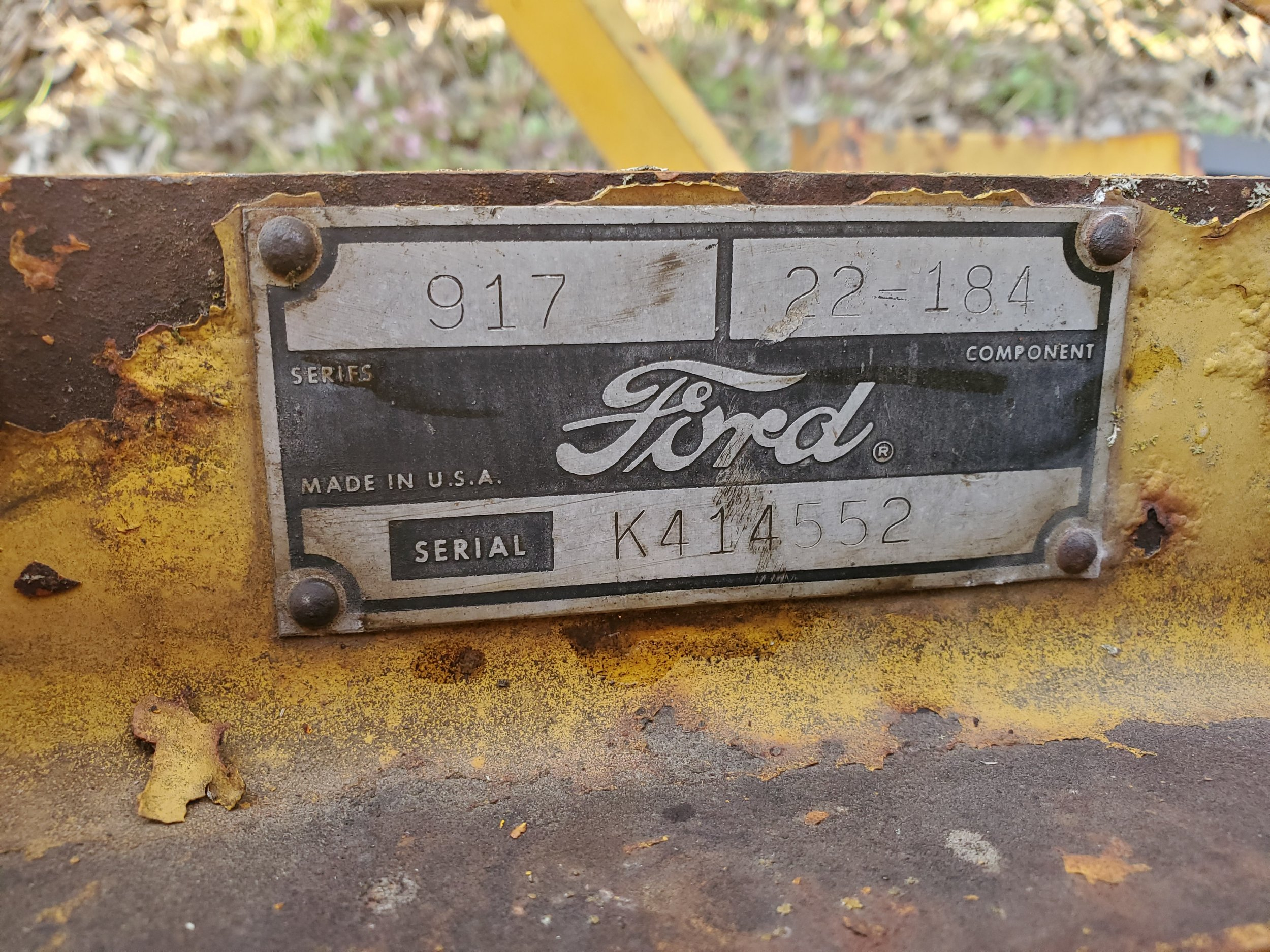

How wide is your 917?
A place like Flail Master in TN may have one?

Sorry but you DON'T know "for a fact" it was abused. There is no other damage. The main body/frame is straight and only typical surface rust.
Rear roller, all bearings etc. are all good.
The damage to the rotor occurred when they hit a pipe that was low enough for the tractor to go over but it hit the rotor and bent it. Someone tried to weld it up it years ago.
We bought it knowing the rotor was bent. For what we paid we can part it out easily if needed.
We've located another one in far worse overall condition but runs and spins smoothly. We'll swap out the main rotor and go from there.
Thanks for the input.

The part number is BU81622. It is discontinued by CNH. it was previously $1621. Buying the parts unit would most likely be the best option, assuming no other damage was done to the unit when it snapped. Catastrophic damage like what is on your unit had to have required some significant force. I would check it carefully to make sure nothing else got damaged prior to putting any more money in it.

Thanks. I haven't found any other damage or indications of damage. Frame is in surprisingly good condition even just considering age. Aside from the surface rust it is solid and undented/damaged.
I've pulled the main rotor and the bearings and end plates all were in good shape. Bearings had grease and are not loose. Even the bolts were in decent shape and without much rust.
We'll see how it goes once we have the donor machine!
