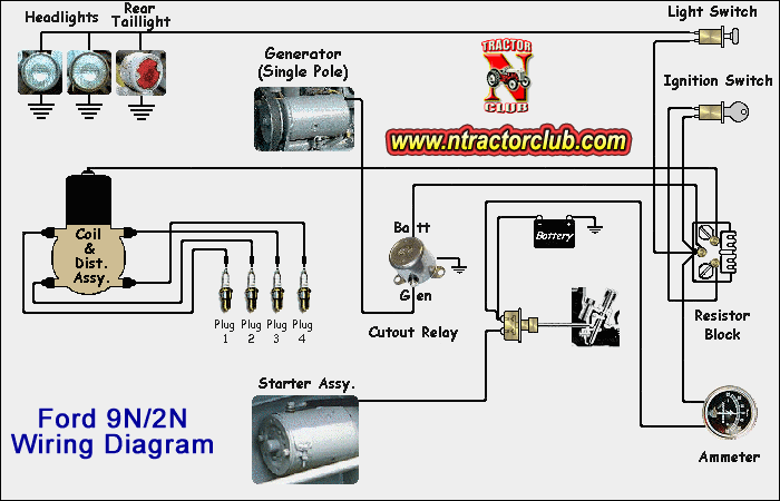

My Ford 9N has been running rough the past four months. Basically it would sputter or drop in power every 5 seconds while mowing (not excessively high grass, maybe 3-4"). At first I just moved the throttle just beyond the highest bump on the throttle adjustment on the steering column to give it more power and this worked fine. But the past couple weeks that didn't even help. Still would run fine and drop in power for a second or two every 5 seconds. I always made sure there was enough gas and the sediment bowl valve was open enough. The last time I ran it I noted that this issue did not occur when I held the choke out about 1/4 of full pull.
Now the new issue is it won't even start. When I push the start button the ammeter goes from 10A to 0A and I here a small click. At first I thought maybe it was a low charge on the battery so I charged it and tried again and had the same effect. Then I tried a new battery I had from my dads 8N and the same result. At this point I did see a little smoke come up from the backside of the instrument panel (note that the small hood door was open). My guess was maybe the resistor blew.
As far as I can tell none of the electric wires have been replaced within the past couple of decades and I am planning on using the tractor to clear my driveway this winter so I was already thinking about doing a 12V conversion. Should I just go ahead and buy the parts for that then start diagnosing the issue?
I appreciate any input:)

I took a look at the wiring and found that the distributor wire was wired incorrectly on the resistor. It was wired directly onto the same stud/terminal as the ignition wire so the resistor was bypassed. I wired it back up correctly, onto the left terminal of the resistor, and tried to start it. When I try to start it in this configuration I noticed that the ammeter goes from +10 to 0 where as in the past it always went from -10 to 0. I also heard a hissing coming from around the battery/resistor. My guess was the resistor was fried so I wired everything up to an extra resistor I had from my dads 8N. Still have the same issue even with the new resistor.
The previous owner painted the tractor with most of the wires still attached so I think I will go ahead and replace the wiring harness to see if that helps.

right now you are just changing wires andf doing lots of guessing.
a front mount like that uses a ressitor block with 3 posts. a lower one and 2 top ones. the resistor is between t he 2 top ones.
charge wire from genny cutout lands on that small post, and then heads thru the ammeter ( either wire thru a loop, or in 1 terminal and out the other ), and then to the battery hot usually via the hot lead on the manual starter switch.
from the bottom post on the block, a wire runs to the key switch, and then from the key to a top post on the resistor. the other top post on the resistor to the coil.
that's the ignition.
starting.
you have a big thumb switch that won't push unless you are in neutral., that manually pushes a rod thru the steering column that then pushes a switch mounted intot he back of the column. the back side of that switch is what you see with the 2 studs on the steering column. one side goes to battery and the other goes to the starter. ( your charge line is on the side going to battery ).
check all connections and terminal ends.. especially ground. rusty and painted sheet metal is not a good ground.

I have replaced all wires except the one leading from what I think you called the gen cutout to the generator. The connector was too rusted to come off easily so I decided to leave it for now since the wire looked okay and I figured the generator shouldn't have anything to do with the tractor starting or the starter cranking. Hope that wasnt a bad decision ><.
Even after replacing all of the wires and cleaning all connections it still won't start. Please note hat I also replaced the starter cable, negative battery cable and ground strap along with cleaning the portion of the column where the ground attaches very well and using dielectric grease on all connections. With the ignition on the ammeter still reads 0A and jumps a few in the positive direction when I press the start button. Note that when I press the start button I hear a small click in the starter and that's it. Nothing else.
Oh and the ammeter my tractor has isn't the loop style. It has two posts instead. But it is wired correction from the start button watch to the lower resistor post.
I have also confirmed ground on other parts of the body so the ground is attached properly. I also check continuity and voltage at the start button switch you mention above both before and while I push the start button with no continuity reading and no voltage.
So my best guess is that the start button switch or starter at fault.

hard to fault the starter if you read no voltage to the start switch. and if no voltage to the switch.. hard to fault the switch!
so far i'm wondering if you are using your meter correctly.
and to answer a prev question. no.. the generator does not directly matter on starting.
you could remove the generator completely and just start and run off the battery.
I also question your wireing if the ammeter does not register ignition current.
reread my post and check your wiring.
also check battery and conenctions.. and make sure you are using your meter correctly.

I have been confirming the wiring against the following diagram (See below) I found online since I have a difficult time deciphering the standard electronic wiring diagrams listed in the IT Shop Manual.
http://www.tntwebdevelopment.com/tff/images/diagram.gif

Summary Post:
I have replaced every wire, including larger battery, ground and starter cables, on the tractor except the one running from the generator to the cutout. The connector on the cutout is severely rusted and the screw will not come out. The wire seems to be in good condition so I am leaving it for now.
I replaced all of the wires based on the following wiring diagram which seemed to match SoundGuys description.
The only wire I don't see on my tractor is the ground connection at the Cutout Relay.
Through my attempts at testing the voltage I have come under the impression that maybe the starter switch is to blame. I checked voltage to it (possibly incorrectly) and checked continuity to both switch posts when pressing the start button, which this test failed since I didn't hear a noise or get resistance.
I am unsure if I am using the multimeter correctly to test everything, so if you could tell me where to place the probes while on the 20VDC setting I can begin testing.
Oh and I am sure it doesn't make a difference but I did determine that my tractor is a 2N, not 9N.

the ground connection shown at the cutout is simply it's body grounded to the frame.
check from chassis to hot side of start switch using meter. with starter disconnected, check the other side with button pushed.
use a headlamp as a test load in place of the starter. ie.. press start switch see if lamp lights up.
Reading -6.35V on hot side (where negative side of battery connects to starter switch) and chassis.
Reading -6.35V with probes on chassis and starter side of switch (cold side?) with starter disconnected and pushing start button.
I don't have headlamps on my tractor and can't think of anything readily available that runs off 6V for me to test with.
UPDATE:
My dads friend came over to look at our 8N restoration and he took a look at mine. He agreed that my wiring was correct and we tried to "jump" the starter. It didn't crank so he had me pull the starter. It was hard to get out which he thought was odd. He thought the internals looked good but thought it might not be a bad idea to look at the ring gear on the flywheel for damage to see if the mechanism on the end of the starter had been stuck. Once we got the starter out it seemed to turn fine by hand.
Does this sound plausible to you guys? I want to find a way to run it without it hooked up to see if it works.

it's possible the drive gear was hung int he ring gear.
the drive gear normally sets out at the end of the shaft and travels toward the starter, to engage the ring gear and start the tractor.
you can use jump cables to hook the starter case to chassis, and the starter power lug to the start switch. with drive gear attached, it likely will suck in when the starter turns. this will make it hard to install, but not impossible. i'd remove the drive gear by pressing down onthe big washer at the end then driving the small cross pin out, then slip the drive off, then spin test the starter.
reinstall of the drive gear is opposite removal.
