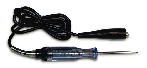

what type of "test light" can be placed between a coil and ground that shows if the points are good?
A dwell meter, sure. but a test light? Doesn't seem right considering a typical point's condenser circuit.
   / Ford 9N intermittent spark, won't run
#13
It's a 6-12 volt probe with a point on one end and a cable with an alligator clip on the other and a light in the clear plastic handle. I put the clip on the top post of the coil and put the probe to ground, when the ignition switch is on and the points are open it lights up and when you crank it and they close it turns off. At least that's what assume is happening.
