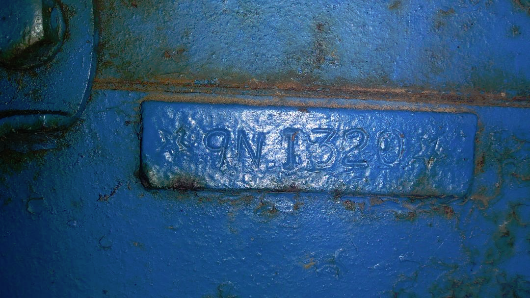

   / Ford 9N intermittent spark, won't run #27
Pretty good chance the engine has been replaced. Can you read the serial number on the block? If so, does that number indicate a 1939 tractor?
   / Ford 9N intermittent spark, won't run #28
#29
9N 1320

#30
Randomly clicking through the pics on the 9N registry shows all of them with right mounted generator like mine.
