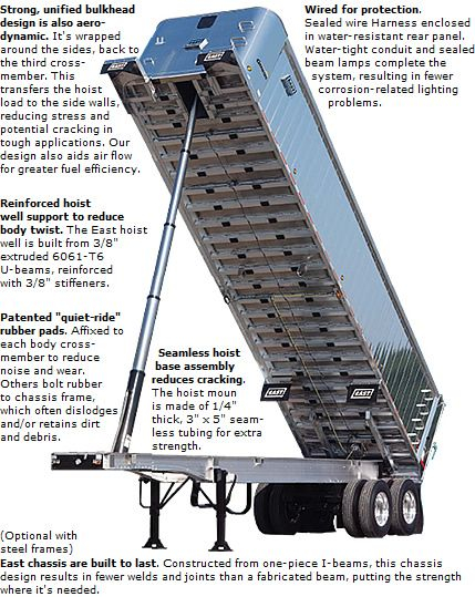

What is the floor of the bed made out of and how thick?
Manufacturers have been doing aluminum beds for decades.
