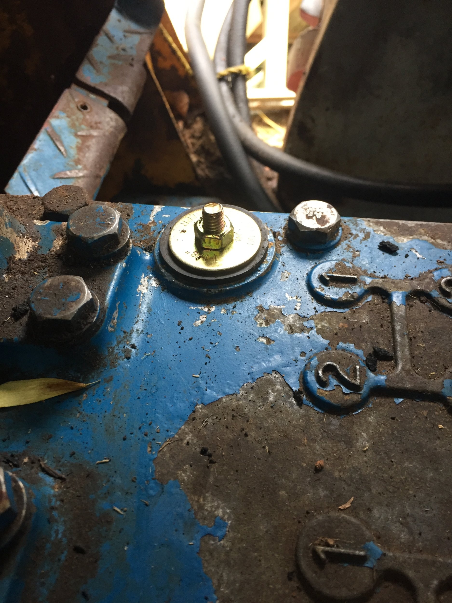

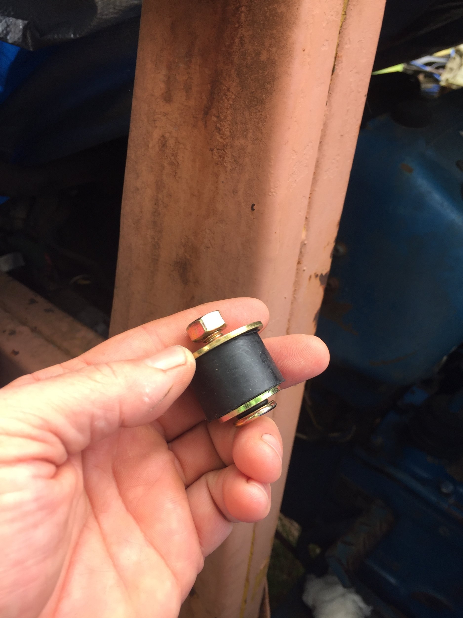

Follow up! As a temporary solution for keeping water out, I got a 1 1/8th adjustable drain plug, milled it down lightly and closed it up.
Any suggestions as to where I can get a replacement for the original plug would be greatly appreciated. I just got off the phone with Messick's and an OEM part will run $150. I was hoping for an aftermarket solution.
I did find this at Yesterday's Tractors - Transmission/Differential Filler Plug
Many thanks!

   / FORD F 1700 REMOVING HYDRAULIC FILL PLUG #16
That is what is in my 1210.
David from jax

You may can put a radiator hose clamp around it real tight. Bump the knot where the screw is in the clamp. Since it is a little chewed around edge, clamp will hold. If you salvage it, get an aluminum or steel replacement made. Rubber freeze plug will work until you get the cap figured out. You may can find a bolt that will work, or make one work.
Thank you for the idea about the rubber drain freeze plug. I used a 1 1/8th shaved slightly to insert and tighten.
My question is can I run the tractor and operate the front loader with the freeze plug.
Thanks Roustabout!

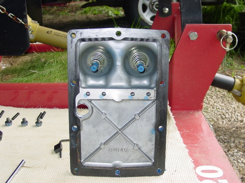

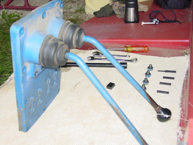

Take the cover off and then go to town, Hammer,, chisel drill whatever you can throw at it without getting any crud in the sump. Pics are self explanatory.

Thank you JC!! Never too late for the next person! For a replacement, screw a piece of wood or champagne cork in the hole? Do you think the freezer plug is ok?
