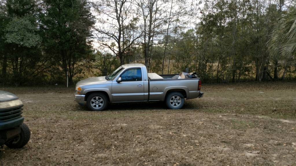

I have a 2000 GMC SIERRA gasser with a 4.8
When it's not in the woods or on dirt roads it's dragging a trailer. 182,000 hard miles regular maintenance fluids, brake pads and tires oh and a after market transmission cooler. Other than that this one still looks and drives excellent with everything still functional Ac, gauges, power windows etc. I think even if or when it starts giving me trouble I'll keep it rather than trade up. I too had problems with a Ford I bought a 01 F 150 with the 5.4 modular engine. At little over 38k in tank fuel pump went out. Right after it spit a plug out of the poorly designed 4 thread aluminum heads that Ford claimed no responsibility for but were the original plugs, miraculously in 03 they changed to 8 thread............
