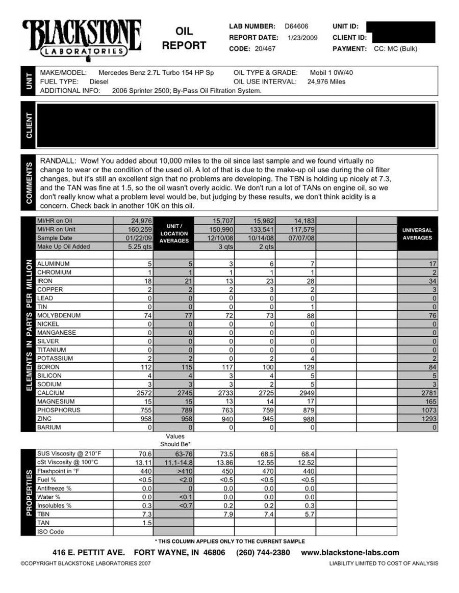

A bypass filter that uses a roll of TP as the filter media is capable of filtering to the sub-micron level.
The proof is in the numbers:
The "Make Up Oil" numbers (in the first row) in the above report are not cumulative.
As of 01/22/09, there were a total of 24,976 miles on the sump since the last full oil change.
I ran it another 26,398 miles after that (186,657 miles on the vehicle or "unit") ... before I actually drained the sump and did a full oil change.
So ... a total of 51,374 miles between full oil changes.
With the way it was going, I probably could have ran it for another 50K before doing a full change.
(Edit: Corrected numbers after verifying with maintenance log)

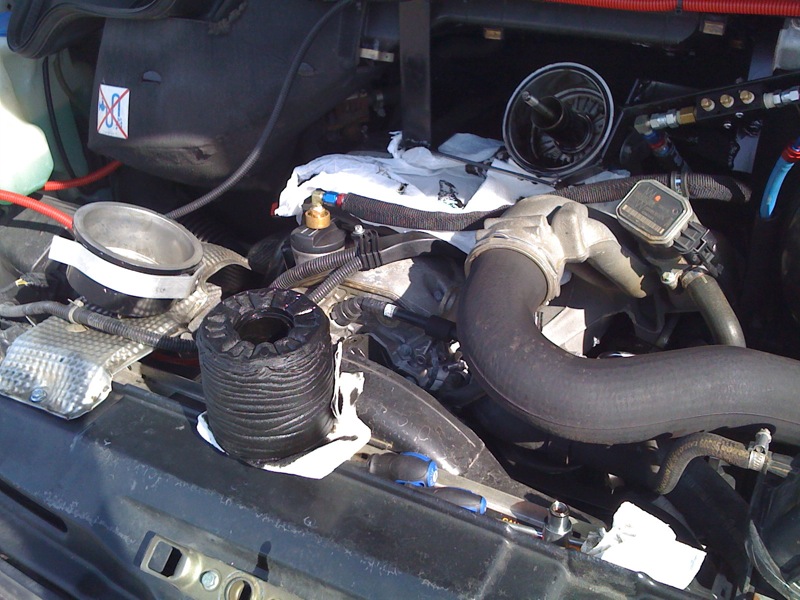

Why wouldn't the inner cardboard core of a roll of toilet paper not turn to mush when immersed in hot oil?
Why wouldn't the internal paper media in a spin-on oil filter turn into mush when immersed in hot oil ... it's made of the same stuff (wood cellulose) ?
That wood cellulose can be pretty tough stuff.
No "mush" here:
You seem to be assuming that it would turn to "mush" (whatever that is) ... based on what exactly ... ?
Decades of use of wood cellulose (aka paper) as internal filtering media in fluid filters by filter manufacturers would seem to contradict that assumption.
Have you ever actually used a roll of toilet paper in place of the actual Motorguard filter?
Maybe we have a confusion of terms here - maybe I wasn't clear in my previous comments:
When I said "Motorguard filter that were modified for use with fluid", I'm referring to the filter housings - not the filter elements. The modifications that were done allow them to accept a roll of TP.
To answer your question though:
Yes, I have used rolls of toilet paper (kinda partial to Scott 1000) in place of the actual Motorguard filter elements ... in two different filter housings for filtering engine oil and transmission fluid ... well in excess of 100,000 miles of overall usage.
In filtering diesel engine oil, the elements get changed out at around 5K miles ... basically because they are so good at filtering the filter flow rate slows down considerably.
Filters used on the transmission can go much longer, as the fluid doesn't have all the soot that diesel engine oil has.
