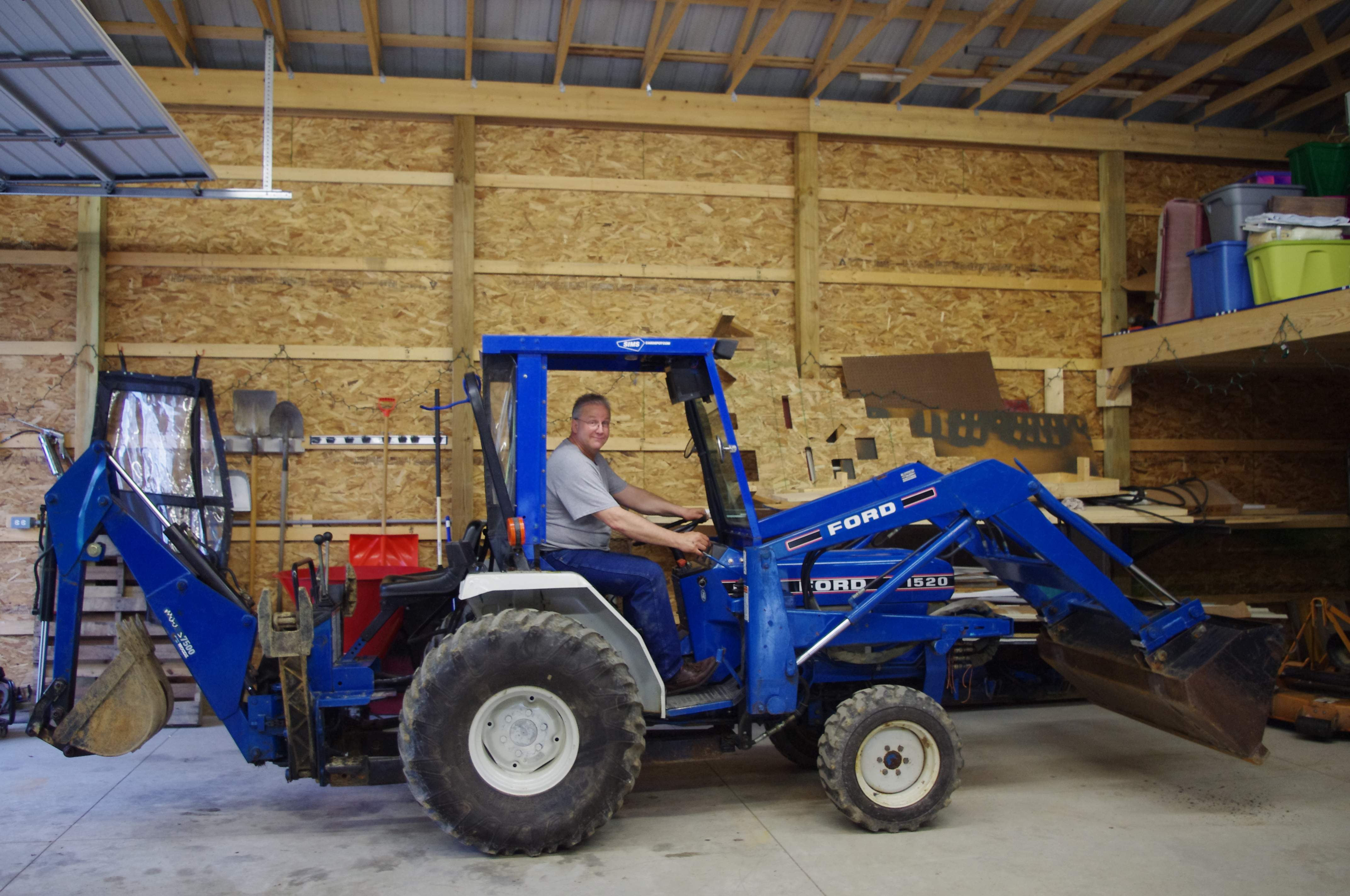

Well, I will be the proud owner of a shiny new (to me) blue tractor on Monday. It has a 60" mid mount mower and a Rhino 2408 loader with it. I am a little worried that the loader is a little big for the tractor though. The factory loader has almost half the capacity this one does. Anybody have any experience with a larger loader on this size tractor? What are your thoughts, should it be ok, or is it pushing it too far? The lift capacity of the loader is 1300 to full height and 2200 breakout.
Jnasystems,
My 1520 was a great tractor. One of the big reasons I traded my 1520 was because the lift capacity was limited to 800 or 900 pounds with the 7308 loader. With the Rhino loader you will probably have more than enough lifting capacity.
The one I had came with a 60" bucket, but I honest feel with the additional lift capacity you have and some weight bars on the three point hitch, you could handle a 72" bucket just fine.
The turf tires were nice but had a tendency to load up with mud. After they got bad, I replaced them with a wide Ag style tire. The replacements were fantastic in mud and snow.
The only thing that needed done on mine were the seals on the front wheels that leaked a little oil. That was an easy fix. I changed engine oil every 100 hours and replaced or cleaned the air filters religiously. The Shibura engine ran like a dream and that's why I bought the 4 cylinder model on the 3040.
Good luck with your rig!
