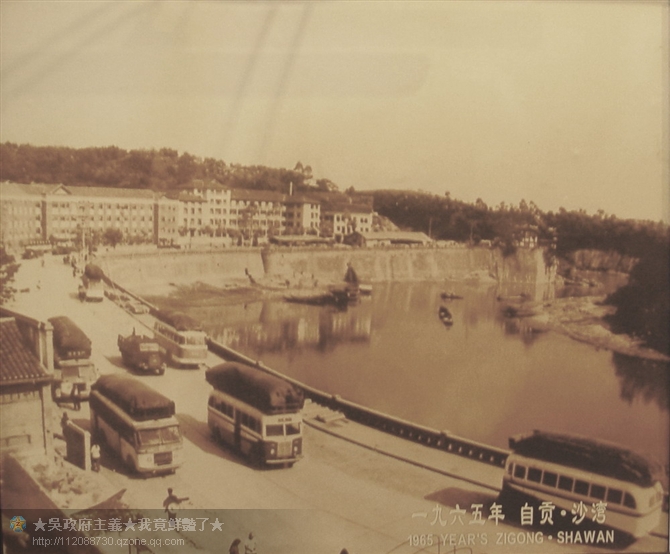

Could use the old russian/chinese natural gas bags strapped onto the roof!
   / Ford says YES to CNG F-150! #47
I think Ford will do it better. Funny thing is it did work!
