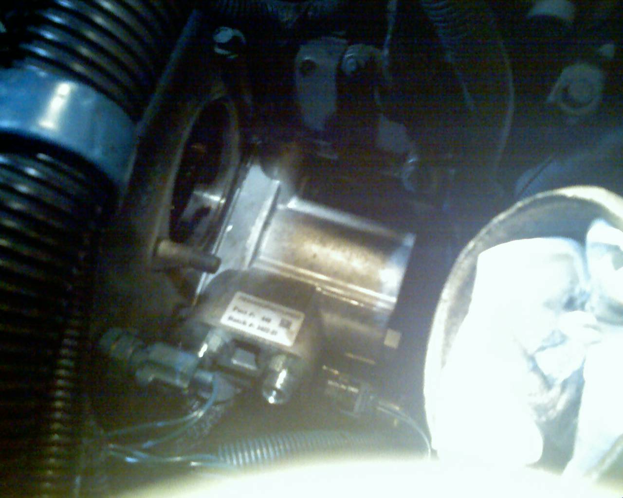

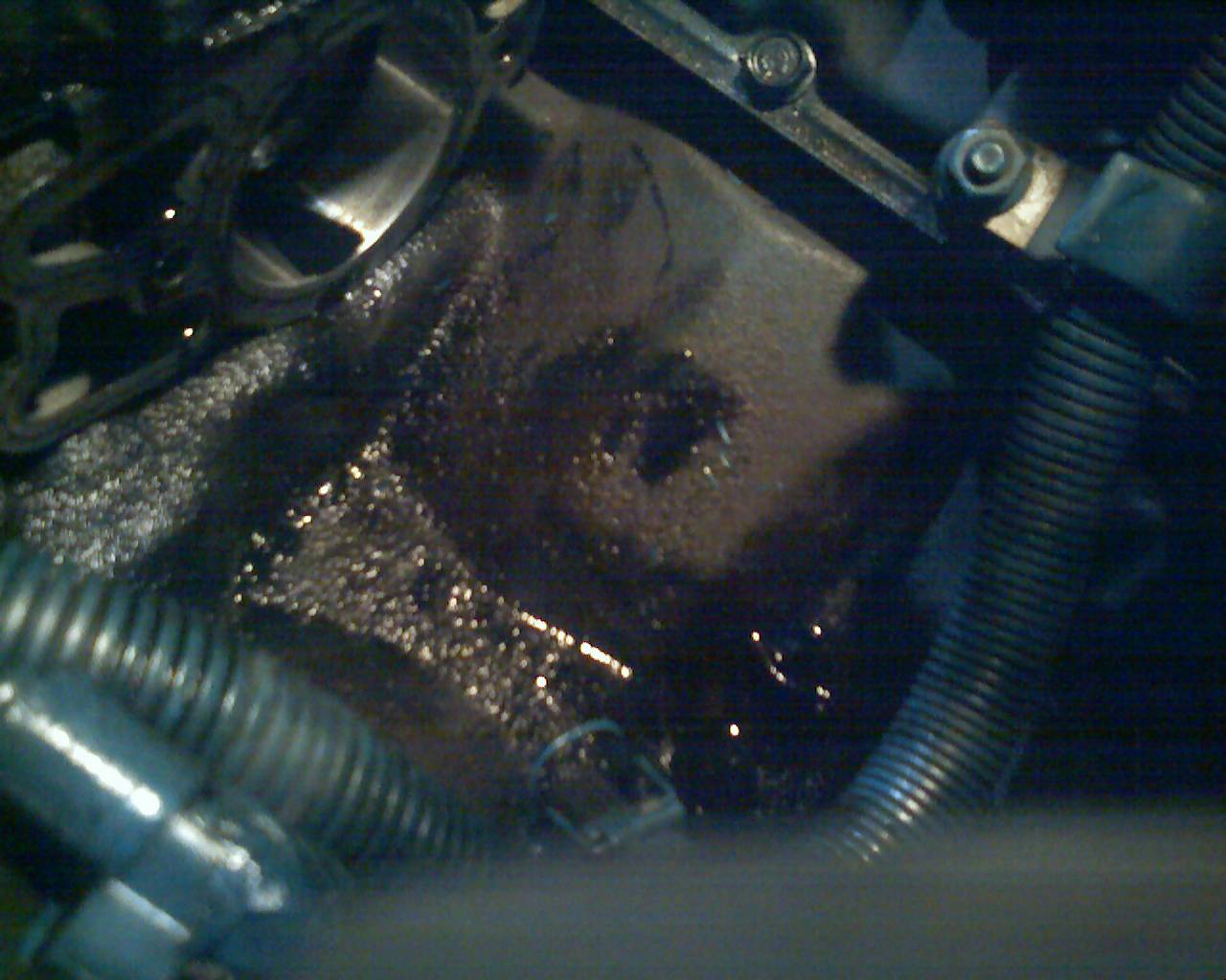

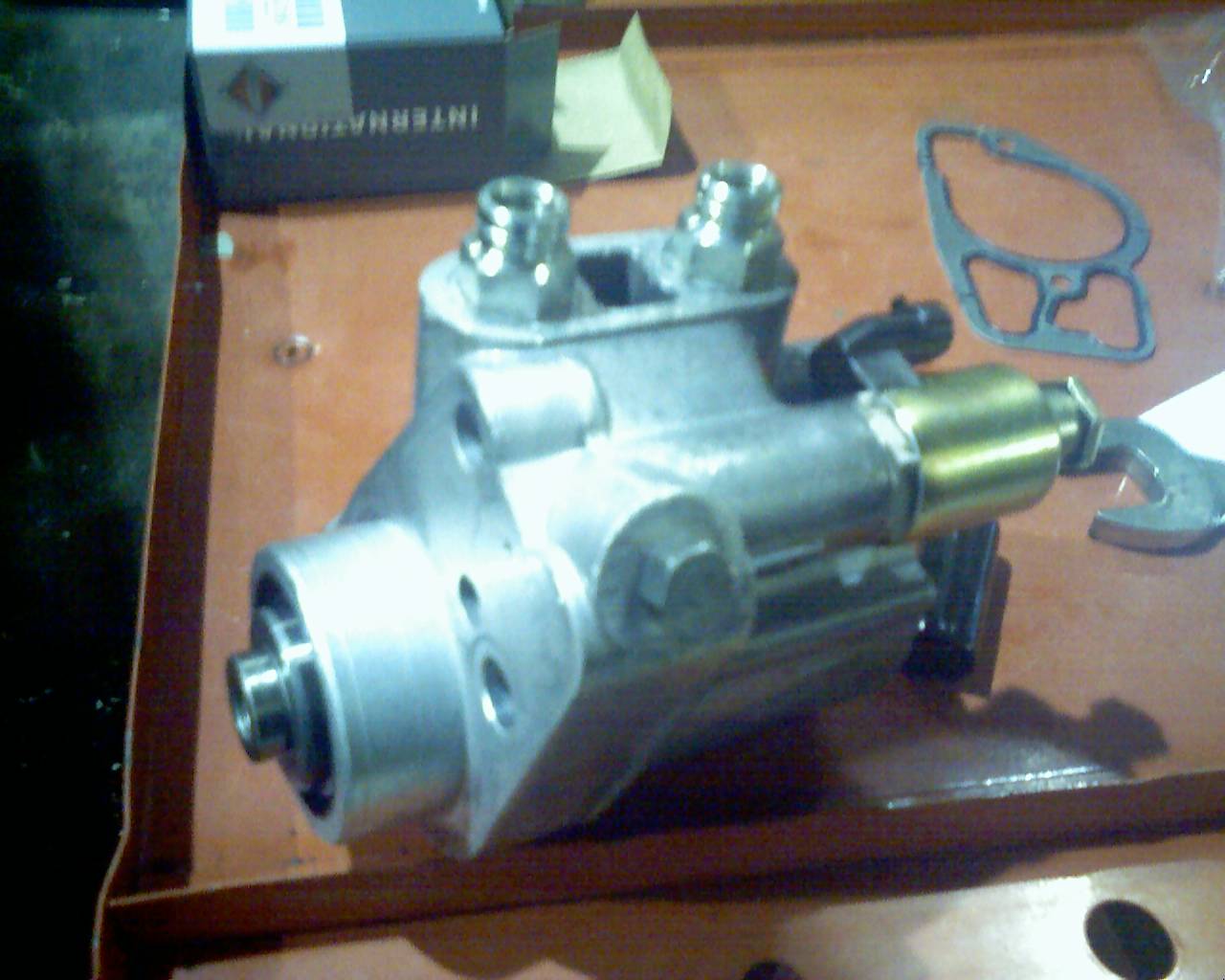

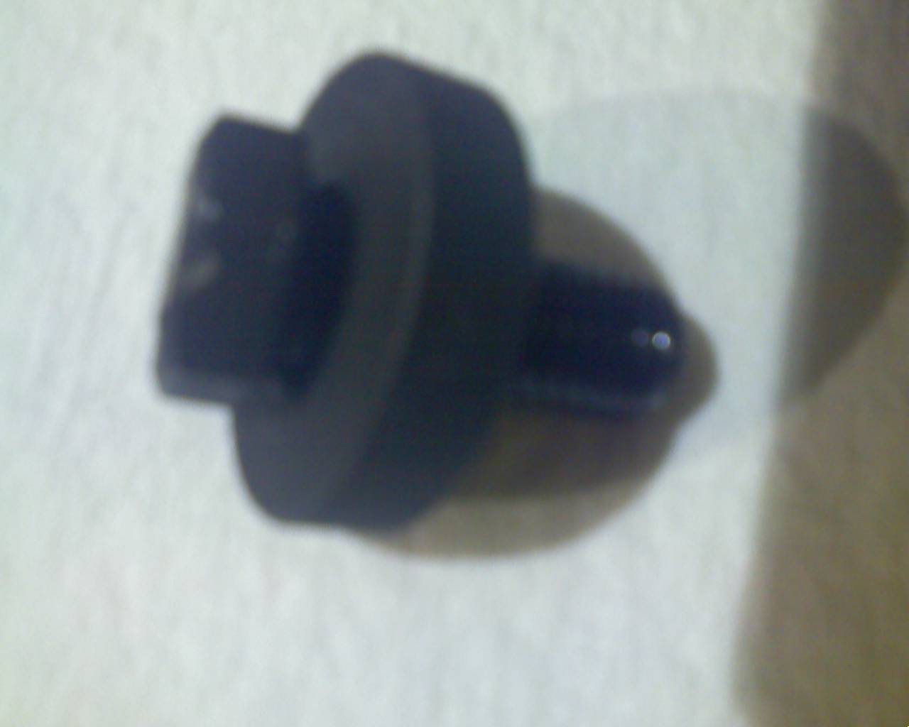

Since 7.3 oil leaks were mentioned, I snapped a couple pics with my phone of a 7.3psd high pressure pump and high pressure line replacement I did today. This job was on a 7.3 in a IH 4700 low pro chassis. The only difference is the low pro power steering pump mounts above the high pressure pump and drives off of the high pressure pump drive gear in the front cover, where a pickup does not have this power steering pump provision and the fuel filter housing resides here instead.
The first pic is the valley after the old high pressure pump was removed. you can see all the oil in the engine valley due to the old pump leaking.
The second pic is the reman high pressure pump on the bench after I already installed the IPR and IPR coil, which are the gold anodized items on the pump.
The third pic is the high pressure pump bolted on the engine , the IPR harness is hooked up, but the high pressure oil lines are not, as you can see the two quick connect ports side by side
The fourth is the high pressur oil pump drive gear bolt and washer. This holds the drive gear to the pump shaft, and must be removed through the two bolt inspection cover in the engine front cover directly inline with the high pressure pump. The drive gear stays in the front cover when you remove the pump. Be very careful putting this bolt back in, as it would be very easy to drop the washer off the bolt and down into the front cover. If that happens get ready to yank the engine.
On a 6.0, this pump is also in the valley, and shares many of the same features, it is not interchangable with a 7.3 pump and it is in the back of the valley under the Turbocharger. According to IH, this was done to reduce audible noise outside of the truck.
