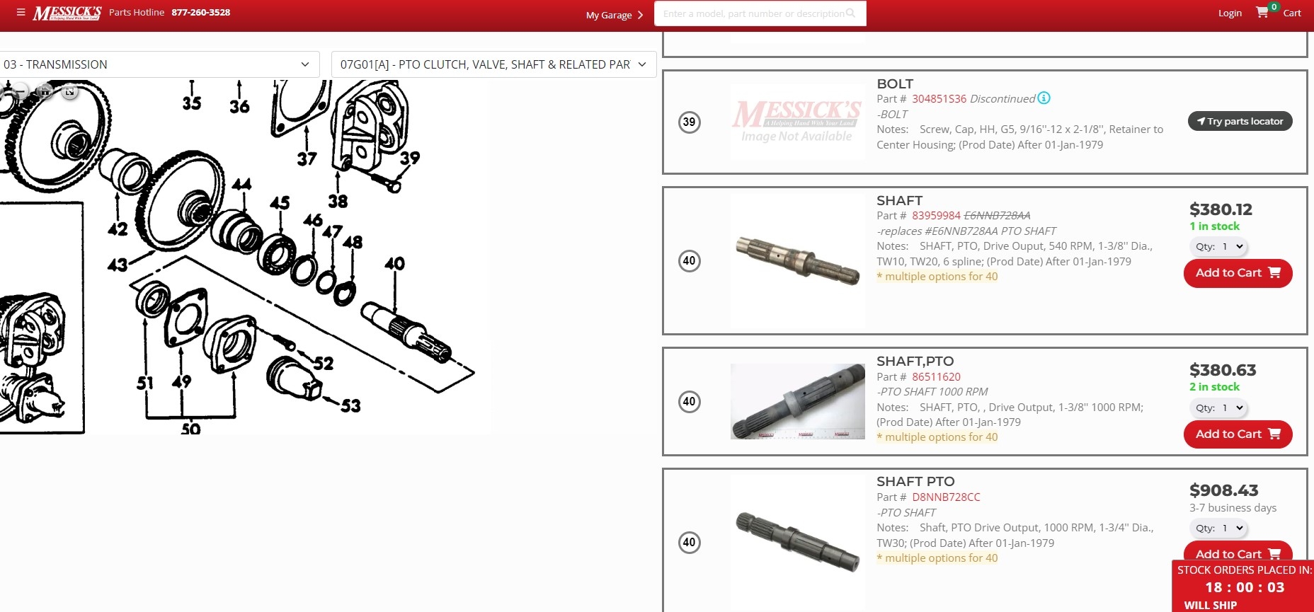

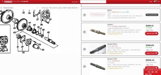

   / Ford TW30 #16
Ray, the PTO speed is changed by removing the existing shaft and installing the needed shaft. Parts picture of each attached here.
There should be a snap ring that takes a normal pair of pliers to remove, then pull the shaft out. You will lose little or no oil when you do this. Install the needed shaft in the reverse order.
What shaft/size are you looking for? I may have one.
Ted

#17
Sir, you are saying the only item that will need to be changed is the shaft. I was thinking a couple gears would also need to be changed (just from reading stuff online).
Thanks Ray
   / Ford TW30 #18
Typically it's just the shaft and the JD units we had you pulled the shaft and turned it around. One way was 540 the other was 1000. Personally if it were me I would get an adapter for the 1000 RPM spline the 540 and run my mowers on the 1000 at a lower engine RPM. You may have to use some sort of strobe or tachometer to determine engine speed but it would help running the tractor at lower RPMs.
