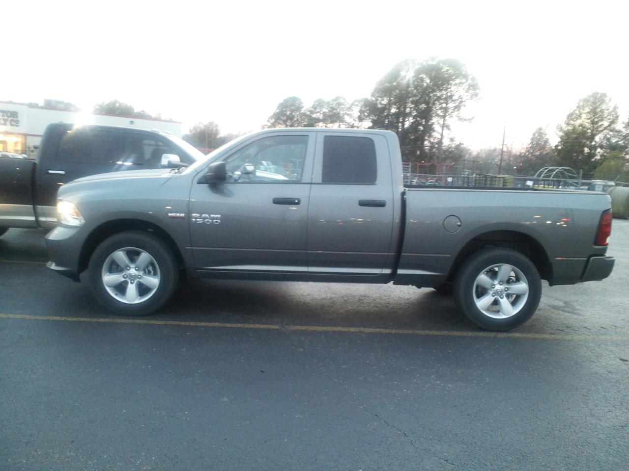

Hey anyone crazy enough to haul around 10k lbs with an 05 dodge ram 1500..have a chance to score up a sweet deal but I need to know if it's possible with some upgrades.
