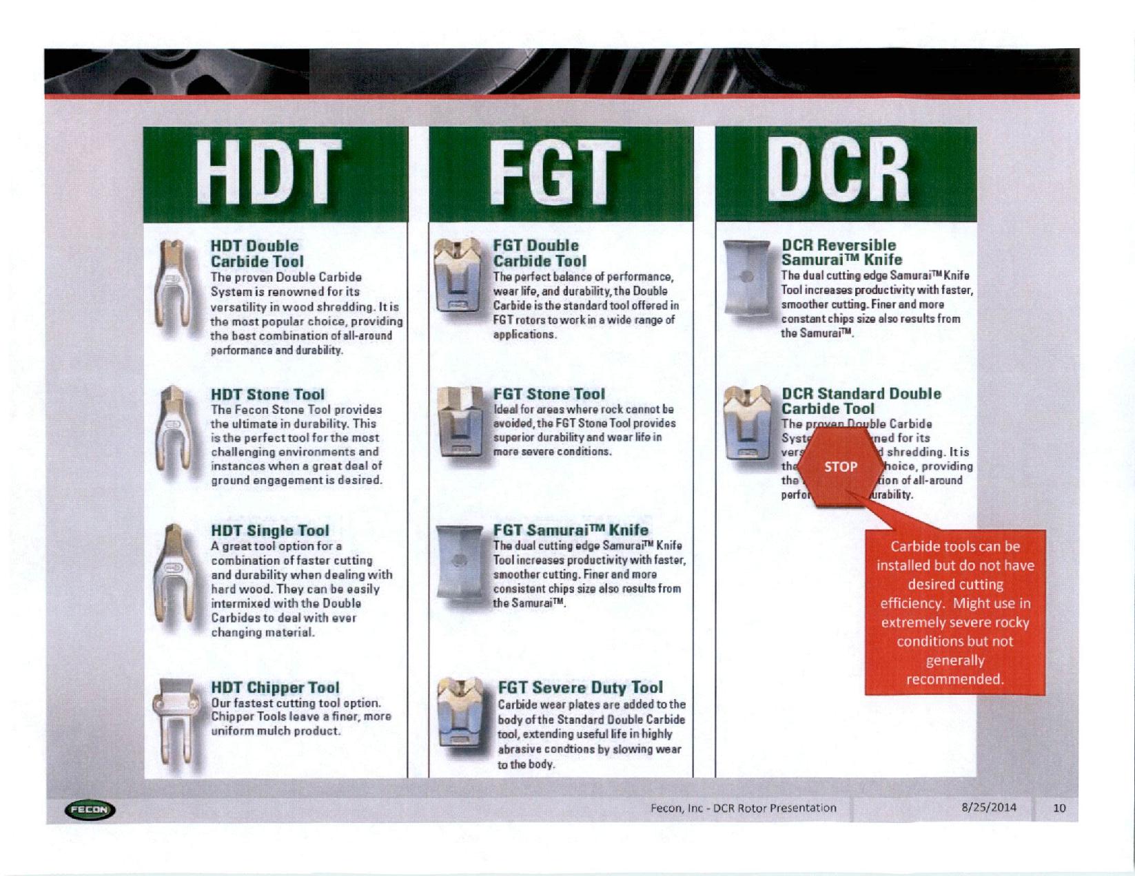

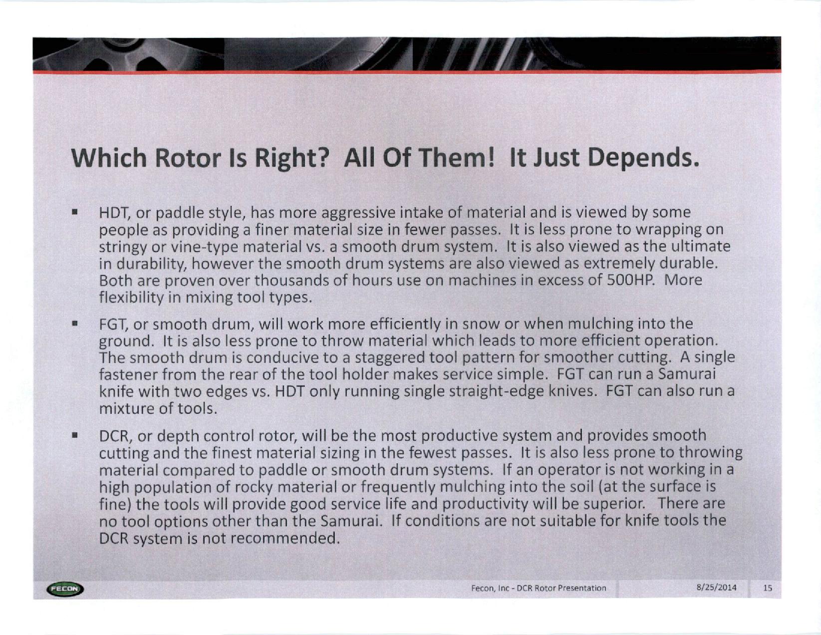

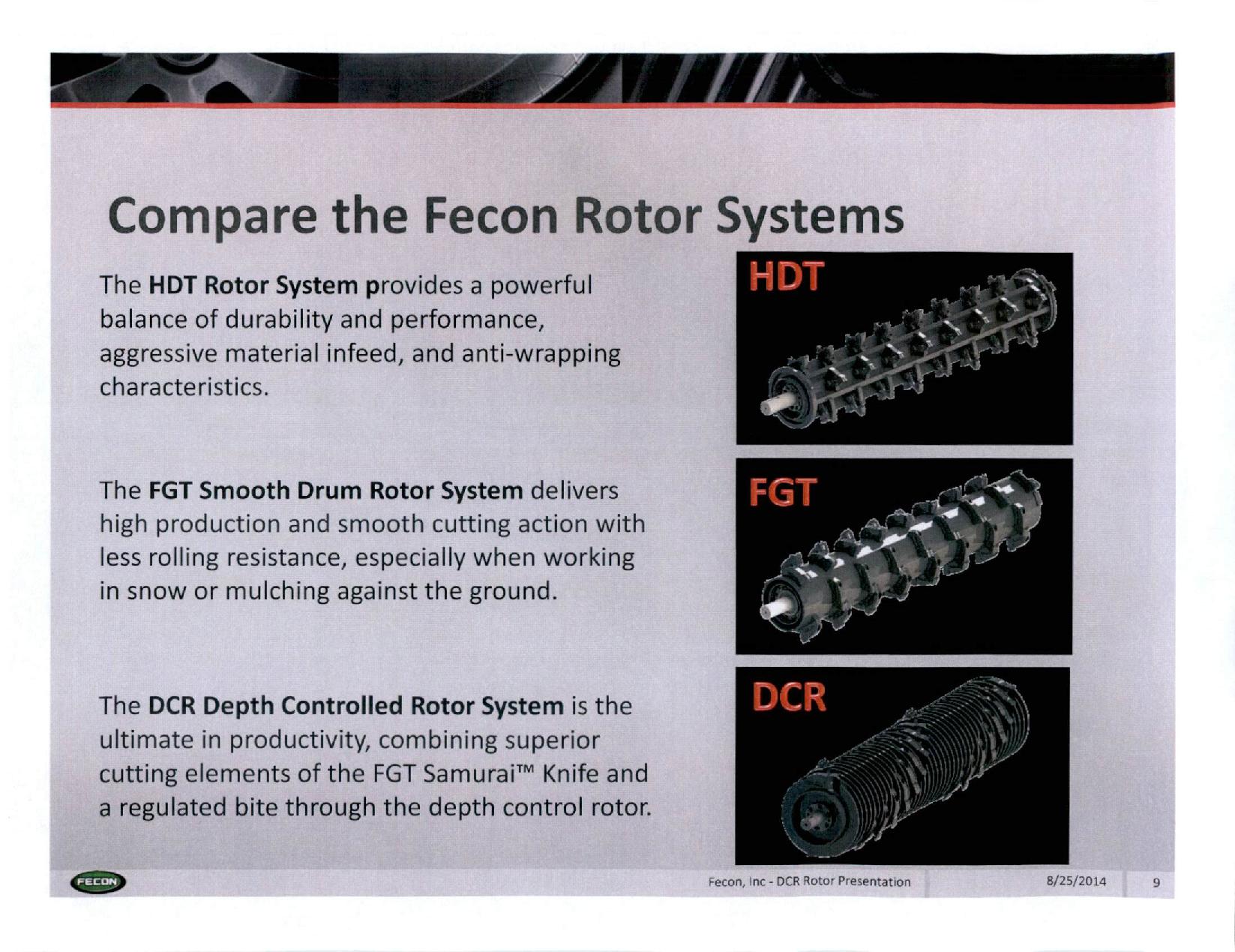

I am not certain if Texasmark understands what a drum mulcher is. They are not a drum mower. They are not a flail.
They are specifically designed for forested/wooded areas and are applicable for clearing wooded areas and do a fantastic job.
The decision between a Fecon/FAE/Denis cimaf type mulcher or a rotary mulcher is a tradeoff. The drum type is a lot more expensive than the rotary (more than double). The drum will mulch to a finer consistency. The drum tools (teeth) will last much longer than the rotary blades and teeth but are much more costly to replace.
A rotary cutter is not a rotary mulcher. The rotary cutter is basically a big heavy duty brushhog. The rotary mulcher has significantly more inertia enhancements to the disk and blade but also has teeth attached to the inertial disk that shred and chews not just cut. An example is the Bradco Extreme Land Shark. I would not consider the Bradco Land Shark there is a big difference.
If you have a lot of finer woody debris and brush then the rotary might be the best for you. If you have much that is larger in diameter (6-8 inches and larger) I would not even look at the rotary. You, the OP, state you have high flow but there is a large range of what some manufacturer's classify as high flow. Make certain what you have will match what you want to get. The rotaries in general can be run successfully with less flow than the drum.
I have looked at and evaluated both and I much prefer the drum type but there are limited times where the rotary would be better. If I could only have one then it would be the drum. I have a Fecon. The dual stage hydraulic motor is well worth the price difference over the single stage motors.
I like the HDT rotor with dual carbide tools
