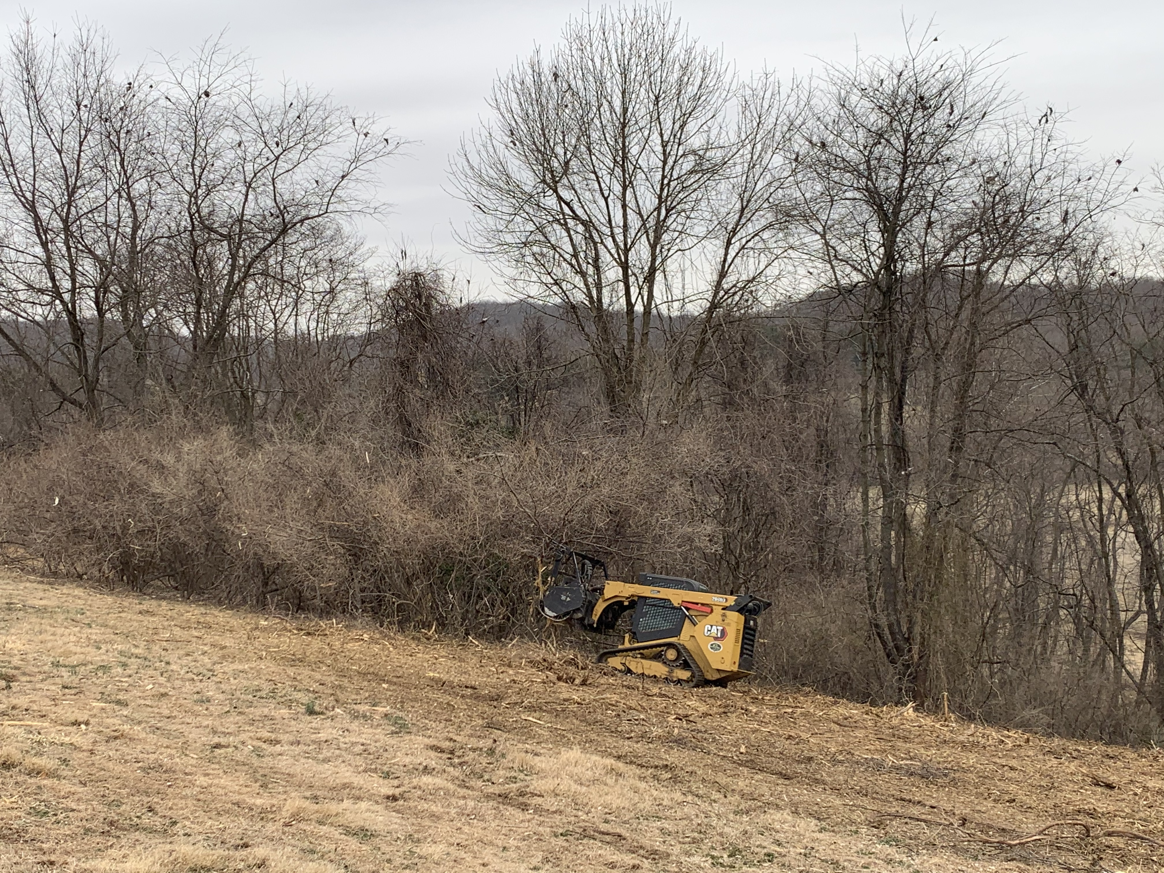

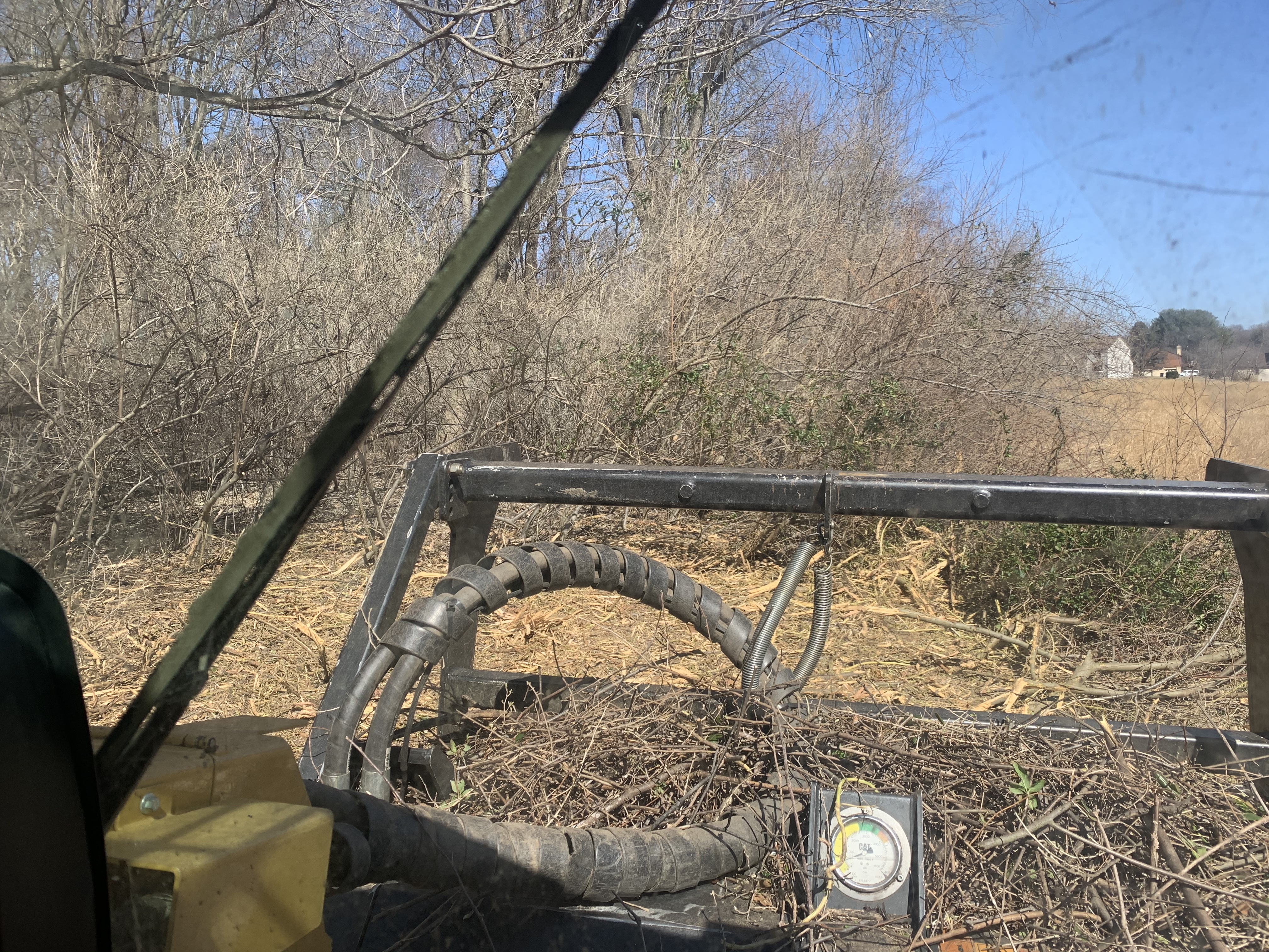

Just did 52 hours over 7 days in a rented CAT hi flow tracked skid steer with a drum mulcher. Did a good job. Did all I could with my CX 15 rotary behind my M-135X. The skid steer with drum mulcher is great because of the tracks and you can raise the cutter up 8 feet to get on top of trees and brush and mulch it down from above.
