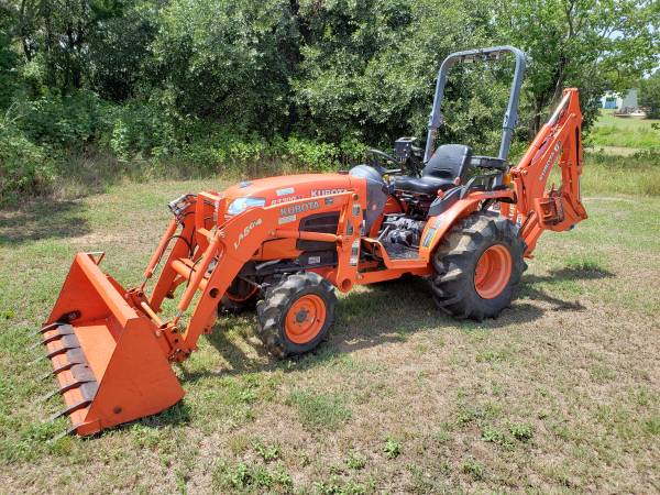

For stability, traction, and less compaction I too am interested in wider AG style tread tires. More plys/stronger sidewall the better.
Based on the replies I am thinking that it's just not common for people to seek out the best tire on a compact tractor, they just deal with what they got and/or add chains if more traction is needed. I know chains can't be beat, but having a tire that is wide and has deep lugs seems like a no-brainer to me if working in sloppy conditions and slopes.
I've been researching the big AG guys that typically run duals are now running huge super single type tires for all the reasons mentioned above. They are claiming great results and I would like a similar setup on something like a B series Kubota...I'm having difficulty in finding proper sizes and a source for this information??
I've attached an image I found online of a small tractor running what appears to be a 15-16" rim size flotation tire with ag/forestry tread. This seems rare and no tractors for sale around me that I have seen are running this setup.
I need to get a couple more posts in and I'll put a link to a video of farmers talking about benefiting from wider tires over standard AGS/duals/etc.
