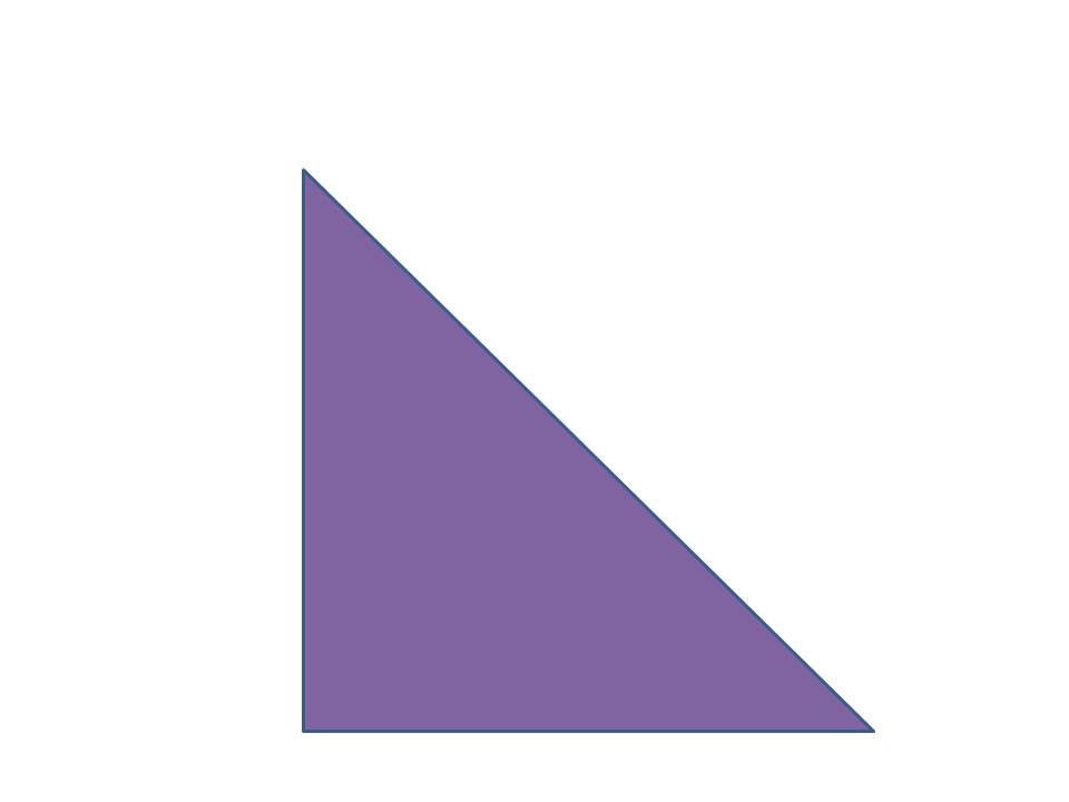

I think I'm gonna go get some steel this week and copy your design if you don't mind. Seems like a fun project! I think I'll just add some little right triangles oriented like this image.jpegto the outside of the L which won't protrude past the inside joint so as not to interfere with pallets, and to make up for my inferior welds haaaa! BTW sorry for the hijack SA

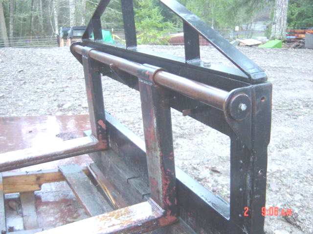

I just bought 1 1/2" cold rolled round stock. I had some thin wall pipe / tube that goes over the round stock real nice.
Not my design, I stole it from Ingersoll Rand. I just adapted it to mount on a tractor.

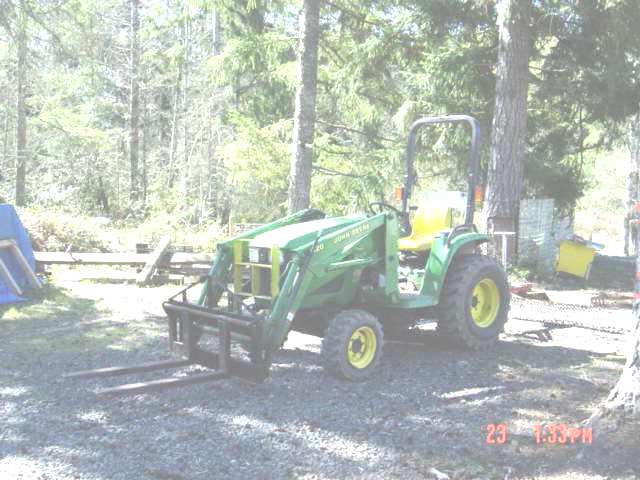

A good friend of mine has a Kubota tractor, but no quick release. I've been begging him for years to bring his tractor over so I could build him a quick release. He just doesn't see the need! :confused:
SA, I can be a good friend and I have a Kubota that needs a quick release! :D Also needs a trailer! Maybe you can build me the trailer first so I can bring my tractor over so you can build the quick release?
/ Fork attachment build.
#44

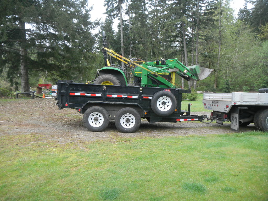

Sounds like a good winter project for us!;) I have a dump trailer, and a gooseneck trailer. I'm sure one of them can haul your tractor:D.

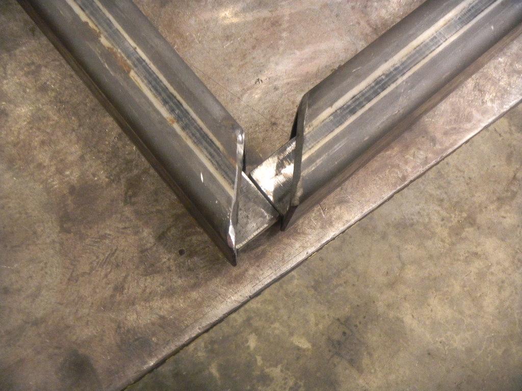

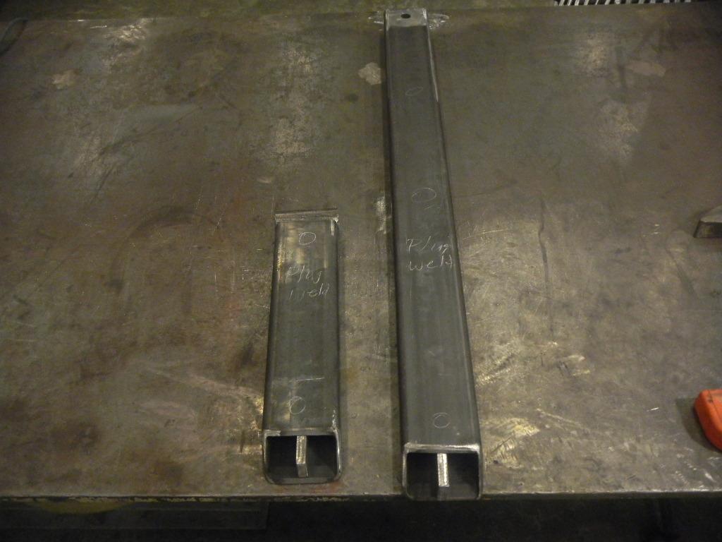

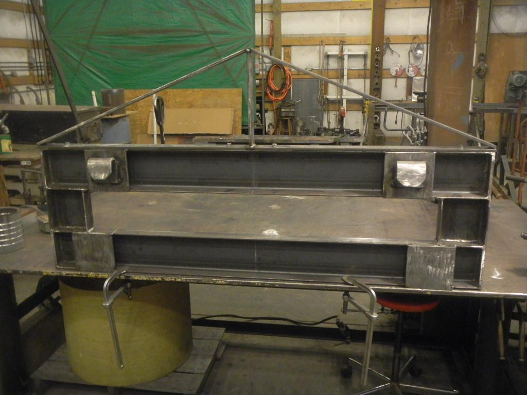

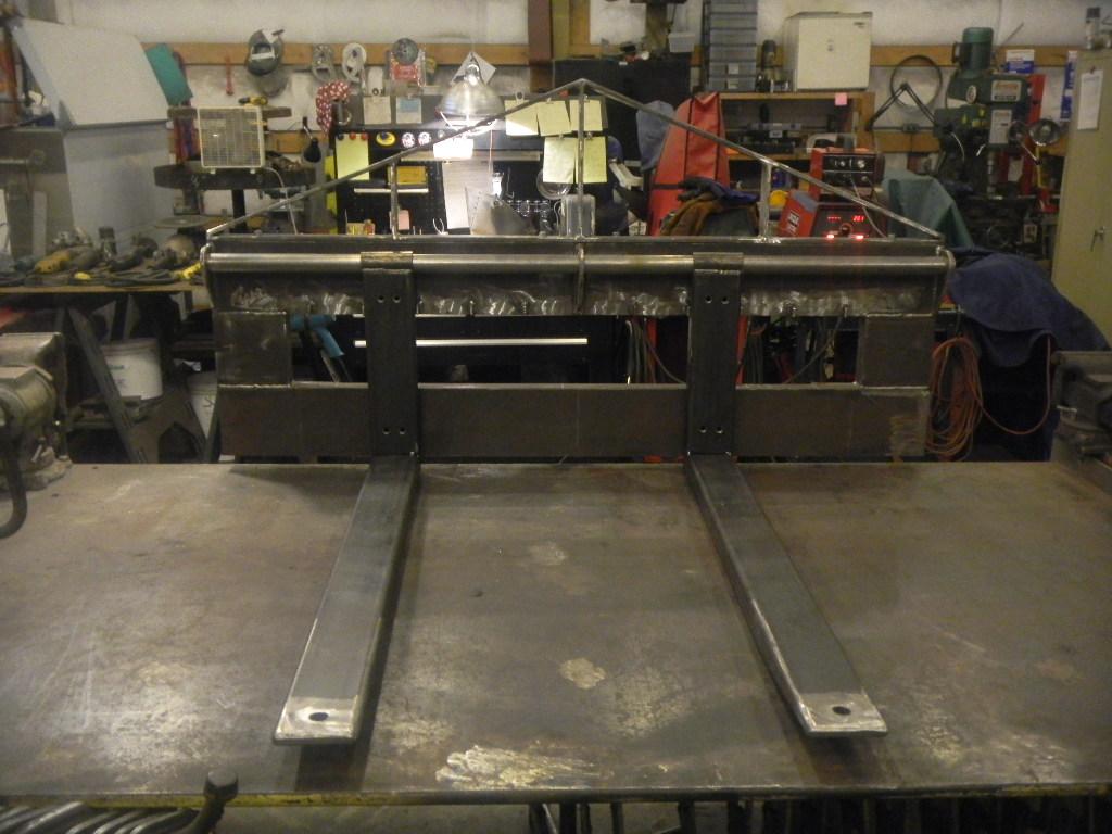

Little more progress this morning. Drilled and counter sank holes to secure the flat bar inside the tube. Started building the rack too.

/ Fork attachment build. #50
Looks nice, I am jealous of you welding table! Looks nice and heavy.

The frame to my welding table, I built in the early 1980s, it is the same height as a flat bed truck I had at the time. I could use a come a long to drag a diesel drive welder I had off the flat bed onto the frame. Or from the frame to the flat bed.
When I retired I wanted to use the frame for a table, but didn't have a plate. A good buddy of mine had just been reassigned as project superintendent in the local Navy ship yard to build the Pier D air craft carrier pier. I called Kurt up, and ask him to grab me a 4' x 8' x 3/4" plate next time he was at the yard in Seattle. Couple days later Kurt shows up at me house with a plate. I ask him if he made a special trip to the yard to get the plate. He replied "no way, I'm not driving in that traffic. I just went down to the steel yard and bought it for you".
Pays to work for a large construction company!;)

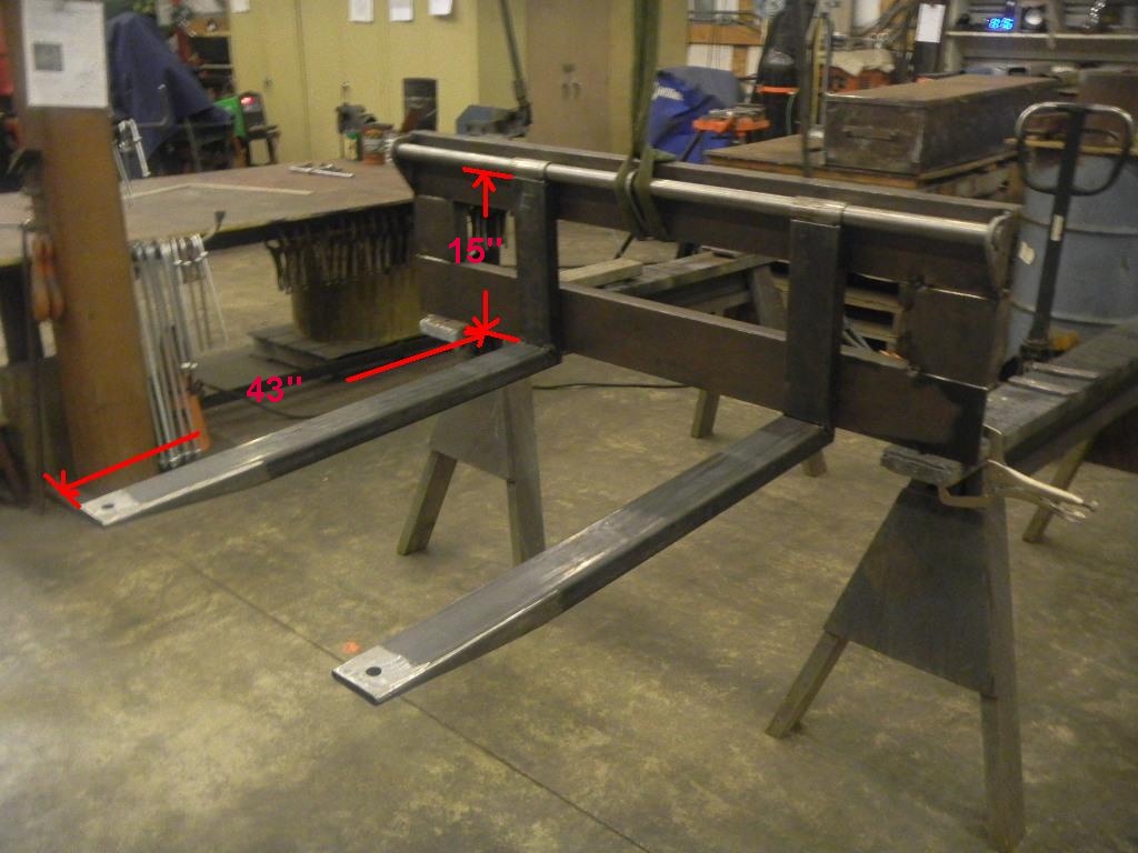

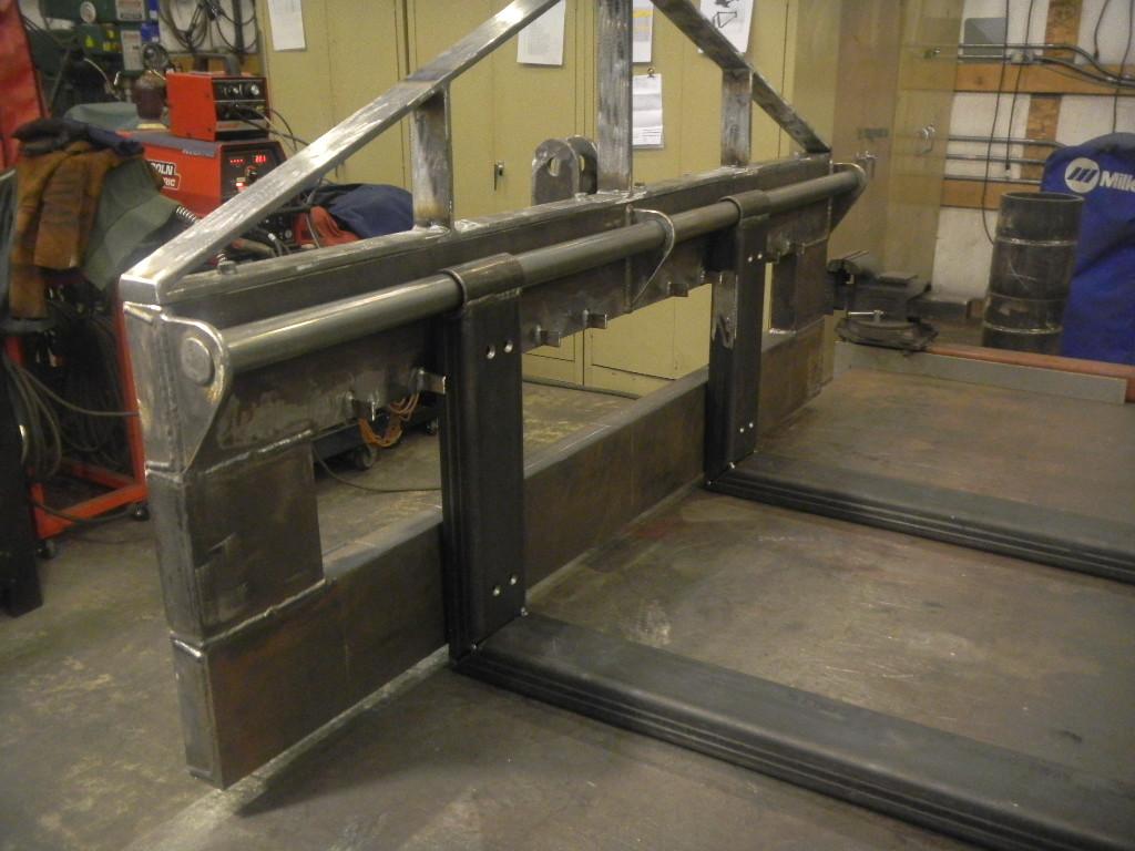

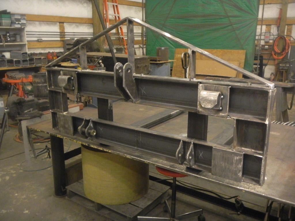

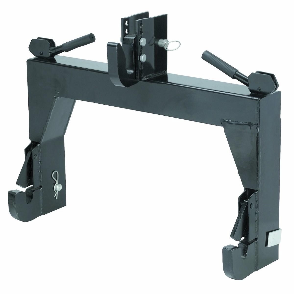

Well, what do you think?
Welded little tabs to the frame so the forks don't bounce all over the place. Had to make new upper pad eyes on the upper back. I forgot he has a quick hitch.:eek:
Pretty much done, just need to do a little clean up. Will weld it all up once I hook it up to his tractor to make sure every thing is going to fit / work.

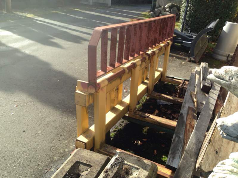

Beauty !!!!
Maybe use your existing bridge type bracing to incorporate a full see through backrest?? Using same width flat bar placed vertically?
If you go that route, I like to place the center bars straight (perpendicular to machine) and the ones on each side slightly angled for better see through vision from tractor seat. Terry
Edit: refer to my earlier photo showing ugly primerd 'back rest'.

Turned out nice.
The way you did the bar inside to beef up the heel is nice. Not what I was picturing based off what you were describing. I thought it was only going to be inside the horizontal and stop at the heel. What you did should.make that heel area a good bit stronger.
