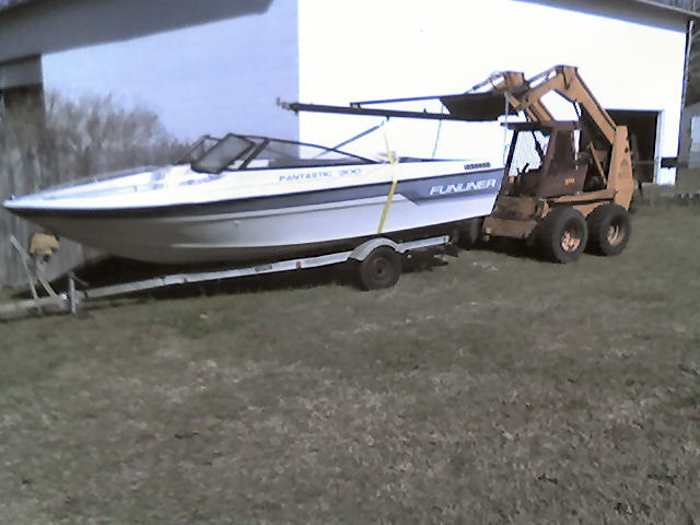

You could always lift you sled like I'm holding this boat with my boom pole. a couple of straps and your good to go.
I have to buy $300 of steel at a time but at that rate it comes out pretty good, I use a 19' boat trailer to haul it home then I use my SS to unload it
for instance, the 2"X5"X1/4" comes 24' long, I will have some for another project
