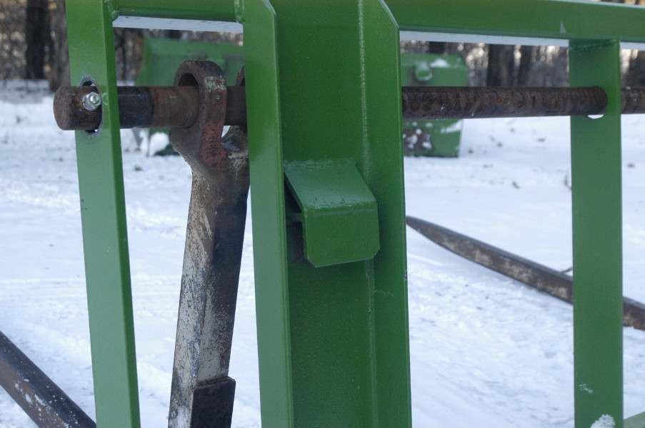

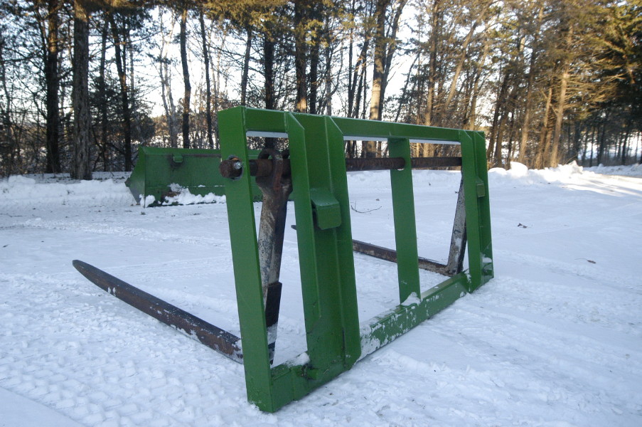

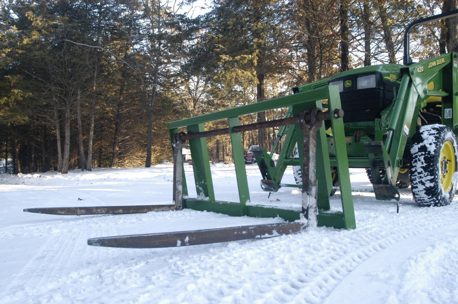

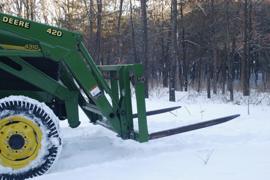

/ Fork lift Frame #5
I don't know if this is what you are looking for. I used 2''x4'' 3/16'' for the top and bottom. 3/8''x 4'' for the sides, and 6'' x 1/4'' channel for the loader mount. 1 3/4'' round for the forks, that are old brick forks.
