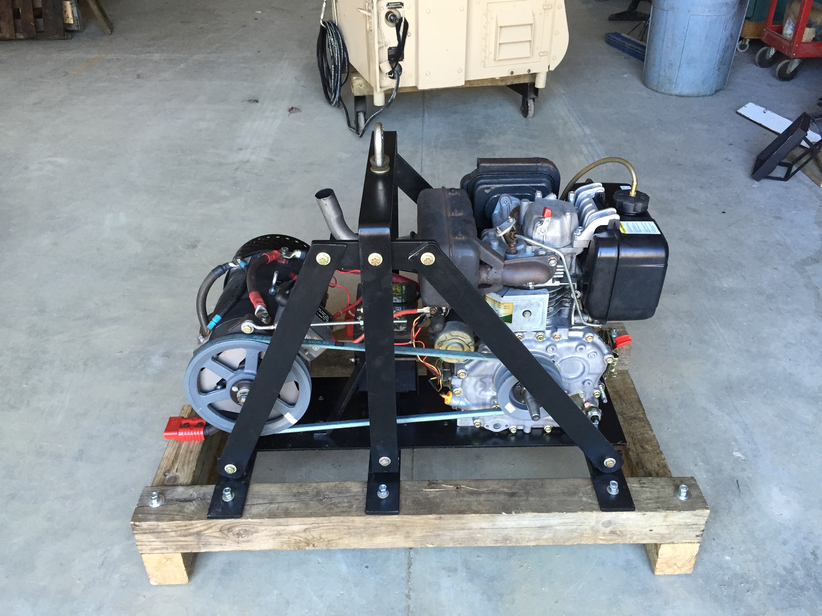

IMG_5508.JPGYanmar L100 Project
My most recent Yanmar project.
I bought this engine on CraigsList with a knock. It is a Yanmar L100 that I completely rebuilt with a new OEM crankshaft, piston & rod.
I have it driving a new Niehoff N1603-2 28v 450 amp alternator and built it as another way to support my off grid battery pack.
The frame is made with 1/4" steel and I bent the angles on my 40 ton press.
Bolts were used for assembly because they allow me to easily change/modify the design.
The engine is turning at 2750 rpm which is the sweet spot for minimum fuel consumption and the alternator is turning shy of 1500 which is near max efficiency.
During testing I found that it would run 5+ hours with a 1kw steady state load and could easily handle a much higher surge load when connected to my 24v 370ah battery pack that powers my 4kw inverter.
Running the engine at maximum speed 3600 I can pull 200+ amps of DC current.
The crankshaft is tapered for generator use but I used a bushed bore pulley so I could belt drive the generator.
Overall I'm very pleased with the performance and will be adding a low oil pressure shutdown.
I would like to add an external governor that would adjust the engine speed according to the load.
This summer I plan on building an insulated & power ventilated enclosure to shelter and control noise.
Attached are a couple photos and a video.
Hope you enjoy

Nice job. It's been tempting to go off the grid for electric where I am as the price of natural gas has reached a new low of $1.73/MMBTU (~1000 cu. ft. gas) this month. I have a generator that runs on natural gas and can generate power for less than 1/2 the price I can buy it from the power company (electric runs around $0.16/kW*hr). Ideally I would have a setup similar to yours with a generator that would auto-start to charge the batteries as needed to reduce run-time on the generator, keep it in the better efficiency range near maximum output, minimize noise duration, maintenance, etc. Reliability, initial cost, and the time to put it together are keeping me from doing it. Plus it would limit the maximum power I could draw at any given time which is really only a problem for my garage tools (air compressor, welder, etc. when other things are running) My electric bill runs about $50-60 month so I'd have to see what the payback time would be but I'm guessing it would be in the 2-3 year range.
Ultimately, home fuel cells should be replacing residential grid power. Fuel cells can convert natural gas to electricity at a current efficiency of about 48% (compare to the system I describe above that is around 15-20% overall) and utilize the waste heat for living space heating or to heat water for overall efficiencies of greater than 80%. Of course their initial purchase price is still prohibitive but I suspect if enough units could be sold it would become quite affordable and seem to be the sensible thing to do. I don't believe the power companies would be advocating such options though.

Thanks;
My post was a bit misleading I'm not (off grid) I'm off grid capable with limitations.
The purpose of my setup is to have an economical backup system in place that would provide uninterruptable power if the utility goes down for an extended period.
My intention is to have several hours of basic electrical power using batteries.
When more power is needed I would start 1 of my generators to recharge batteries and provide additional power for normal operation.
