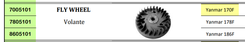

Hi anyone have a spare flywheel with ring gear laying around for one of these 186f yanmar clones? Mine will not hold the flywheel to crank taper any more. Flywheel just is crumbling apart evertime I attempt to fix it. Cant shim it wont hold. need a new one. Only got 85 hours on it and is now an anchor that I cant use. Hopefully someone has one. Thanks, Keith.

Keith,
How about the OPS manual and Part Manual diagrams on a Yanmar 186F to get you going.
https://www.powercare.com.au/maintenance-file/Diesel_Engine186.pdf
If your machine is a Yanmar China clone, is it a LiFan? Here's the manual too. See page-24, item 92. :)
https://www.wiltec.de/media/manuals/92/92477/EN/Lifan_diesel_engine.pdf
Plus, the flywheel is used on other models in the xxxF series too.
And another helping reference. See the Parts Manual section.
And this one from KiPor

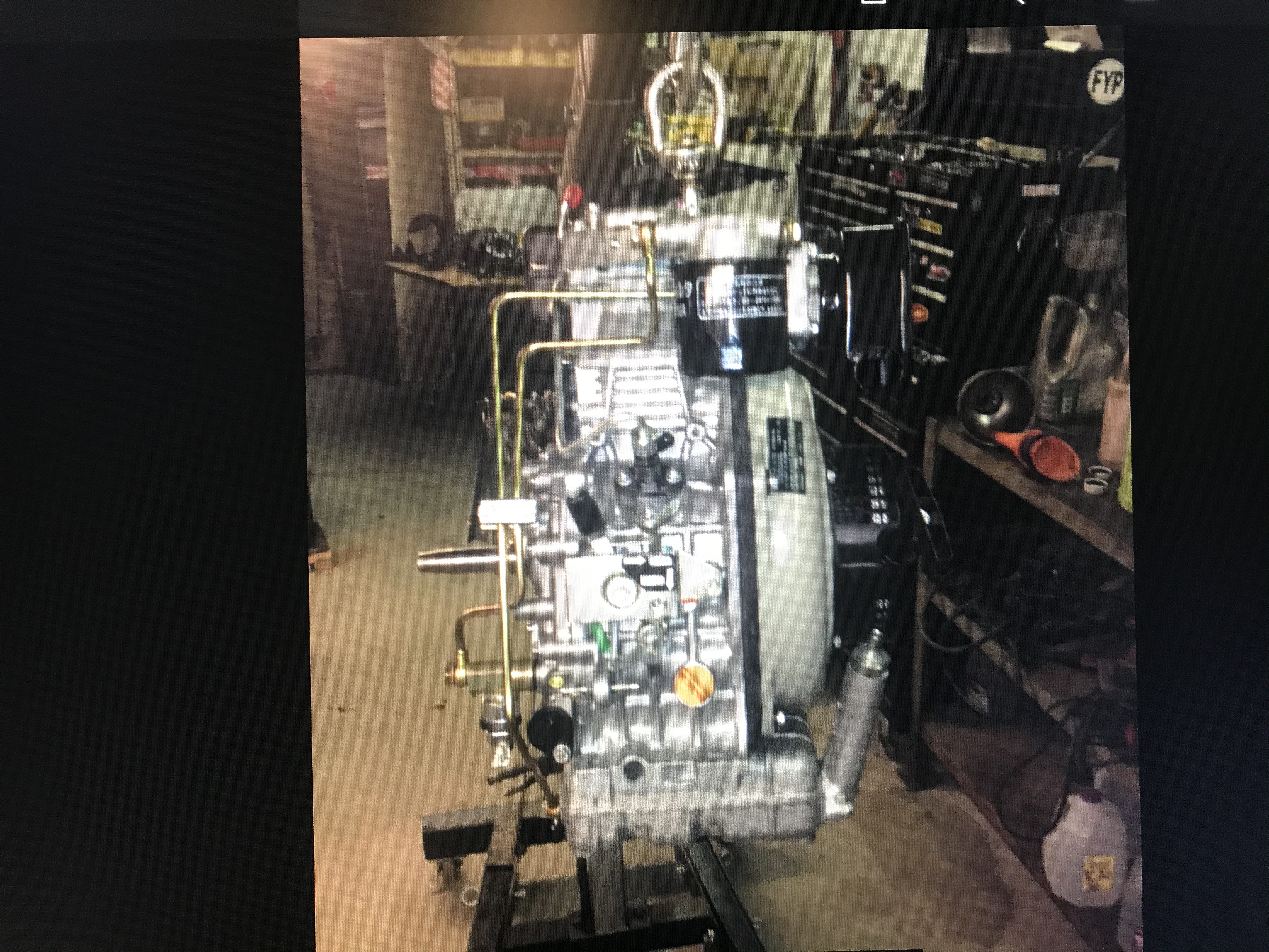

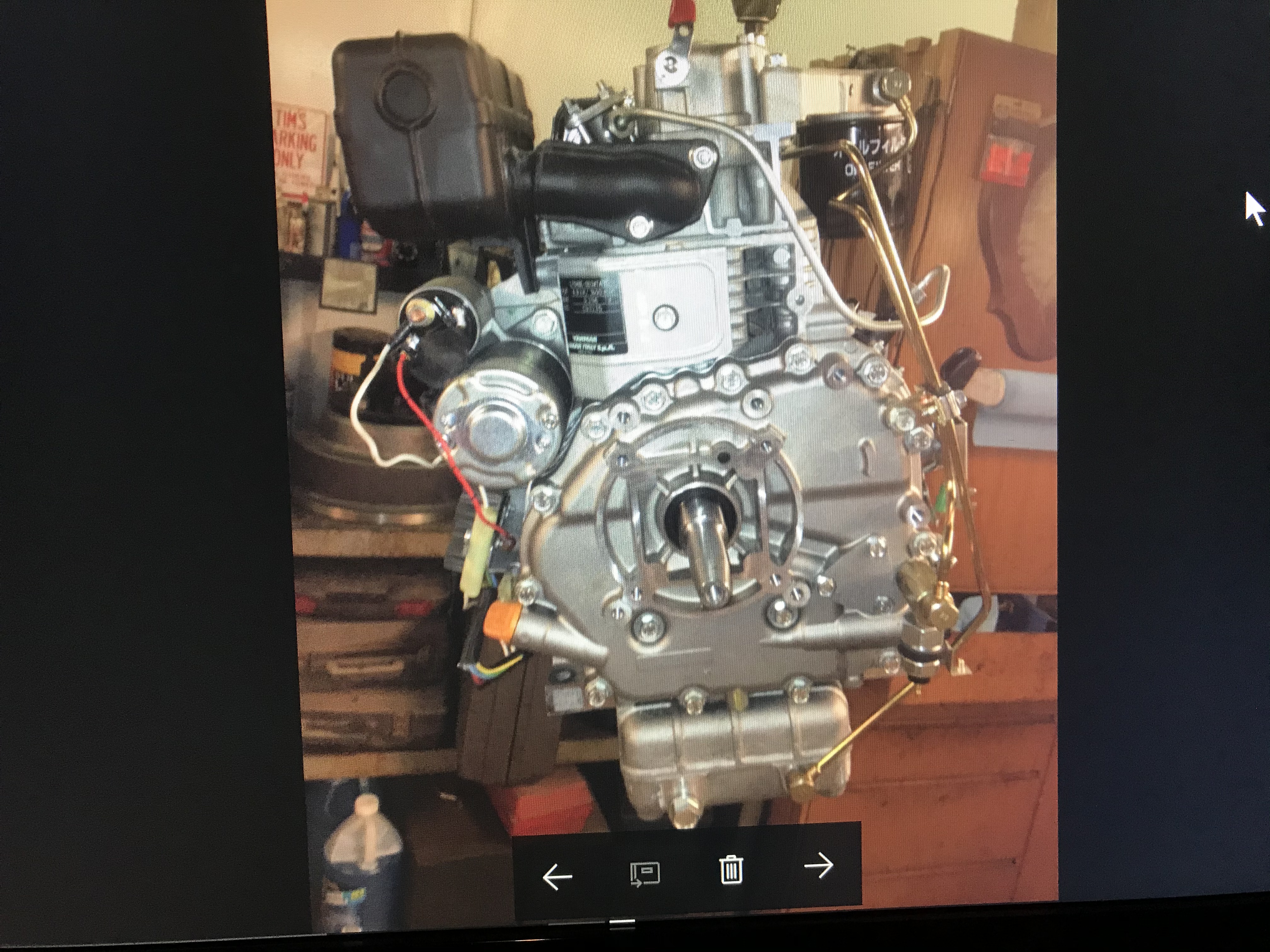

View attachment 677518View attachment 677519
As I mentioned some time ago I have an L70 Yanmar with a Factory option extra deep sump with a bypass filter.
The sump holds approximately 3 quarts. This engine was designed for remote applications requiring extended run times unattended. It also has an intake grid heater for extremely cold starts and is designed to run 500 hours between services.
There is a utube video of me starting it during a subzero cold stretch under username 90cummins.
I purchased it specifically to replace the 9hp L90 originally mounted to a 5000 watt generator head.
This was done to minimize fuel consumption with a short term capacity of 4kw with excellent surge capacity and voltage stability while still meeting my electrical requirements.
This works very nicely with my 4kw Xantrex hybrid off grid battery backup system.
During an outage if the load exceeds 3.2kw the inverter is programmed to assist the generator by pulling power from the batteries.
