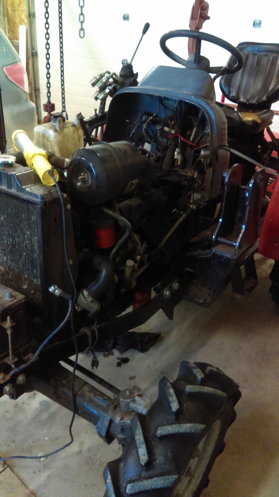

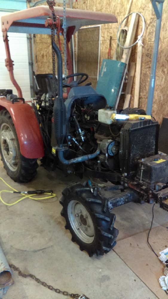

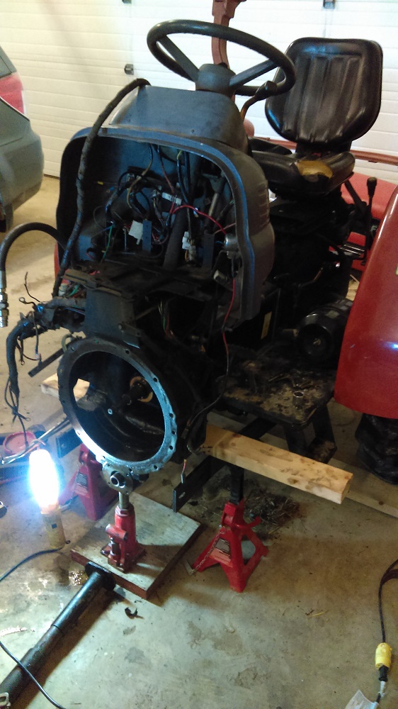

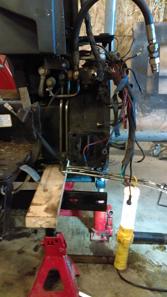

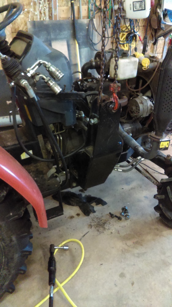

Alright everyone, got the tractor split. sorry for the delay but bits and pieces over the last couple of days got me to this point. The whole process was in fact very easy IMO. I would say a total of 3 man hours to do this and not rushing. Again Kudos to the forums for these tractors! of course there is the rebuild which I will come to shortly but not without parts first and foremost the loose bolts to the engine and leaky gasket! Heres some pics to start..
Also kudos to dad for supplying me with some much needed tools like this hoist and chainfall he built years ago! Sorry if the pics are not clear enough. I'm fiddling with file size right now. You can see some mods that I did from the info on this forum. This came in from the 30 acres of hay so it needs cleaning!
More coming..

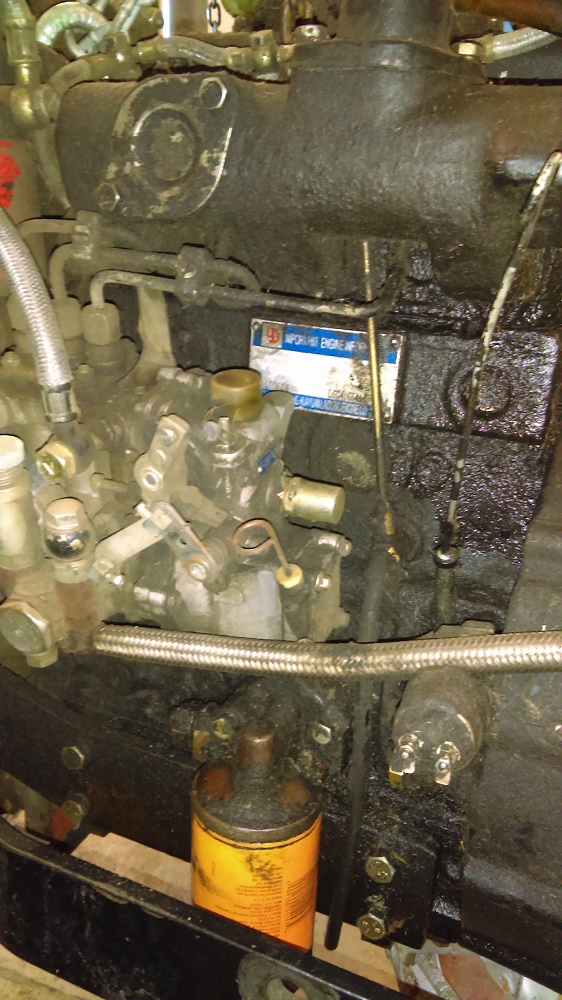

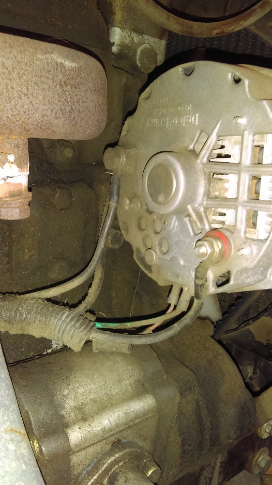

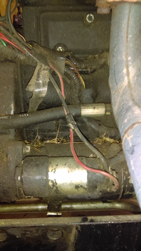

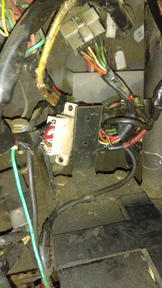

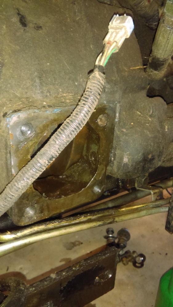

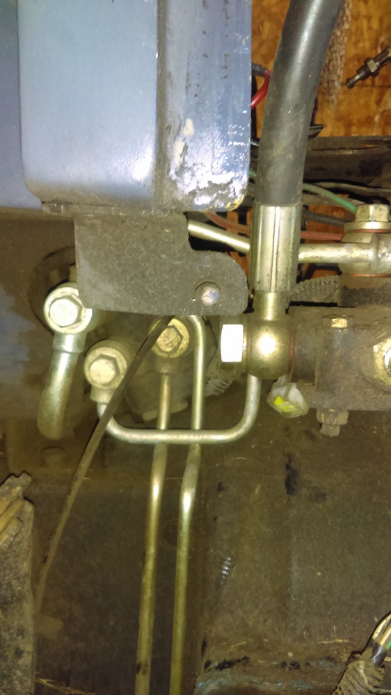

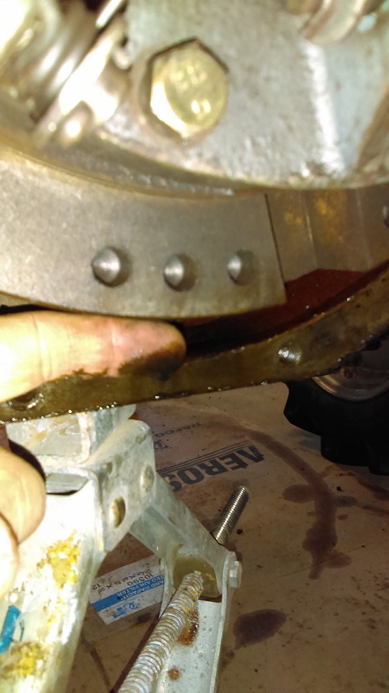

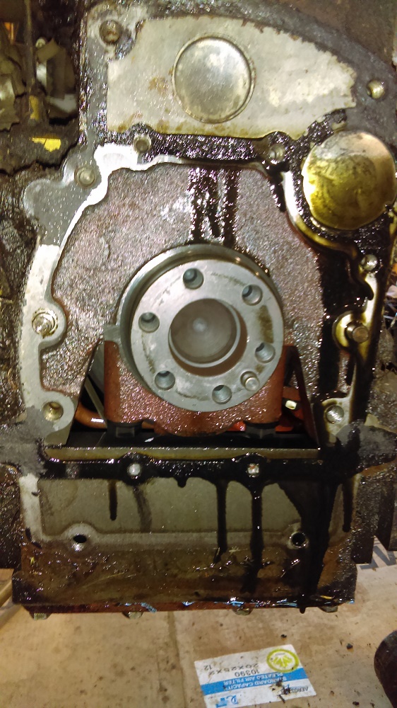

Ok everyone just updating my pics here. basically everything here was required to disconnect for the split which wasn't very much. On the right side of the tractor was my custom wiring for the alternator (gm 3 wire) grounds and wiring for the starter. the hydraulics came off the pump as well as the 2 lines for the power assist. the first picture shows my wiring which i will need to clean up again behind the fuel tank that i removed. The 5th picture is a shot from the right side of the steering system. Notice mounting is before the split area so didn't have to remove! The last picture was trying to show the slow leak I had underneath before the split.
The one thing i like about this tractor is that it came with front to rear loader brackets for support on the middle which was discussed from Rich's post. These i believe have prevented a major disaster. Also while i am this far Im going to clean up my wiring. I added extra grounds because of the poor factory grounds that exist. More will be coming stay tunes...

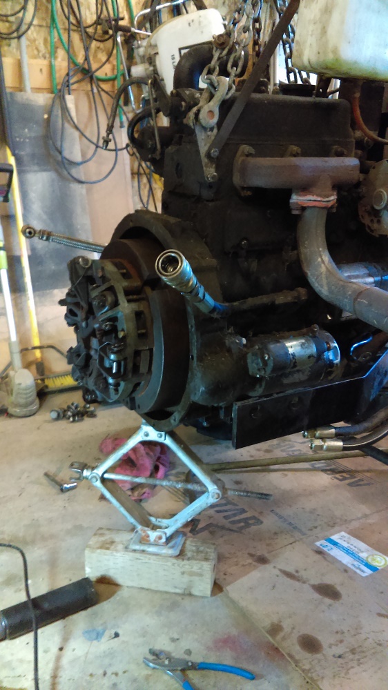

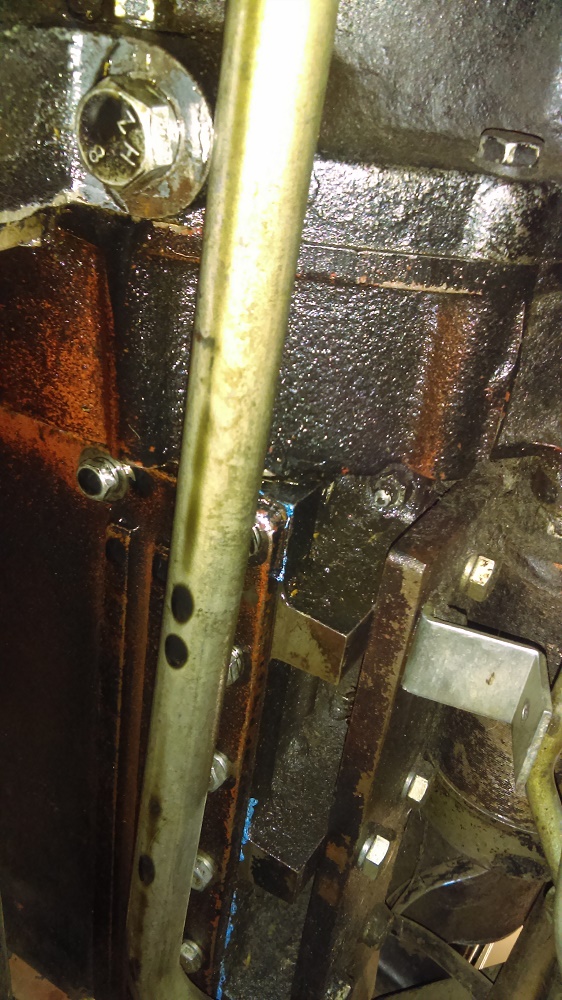

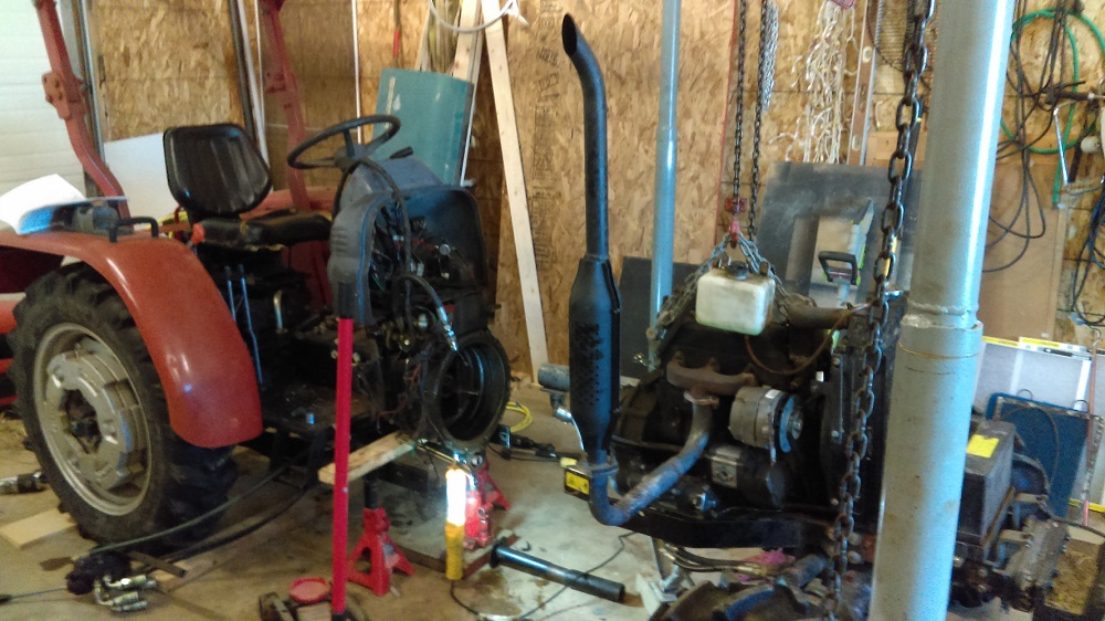

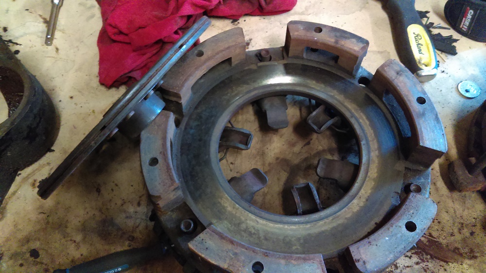

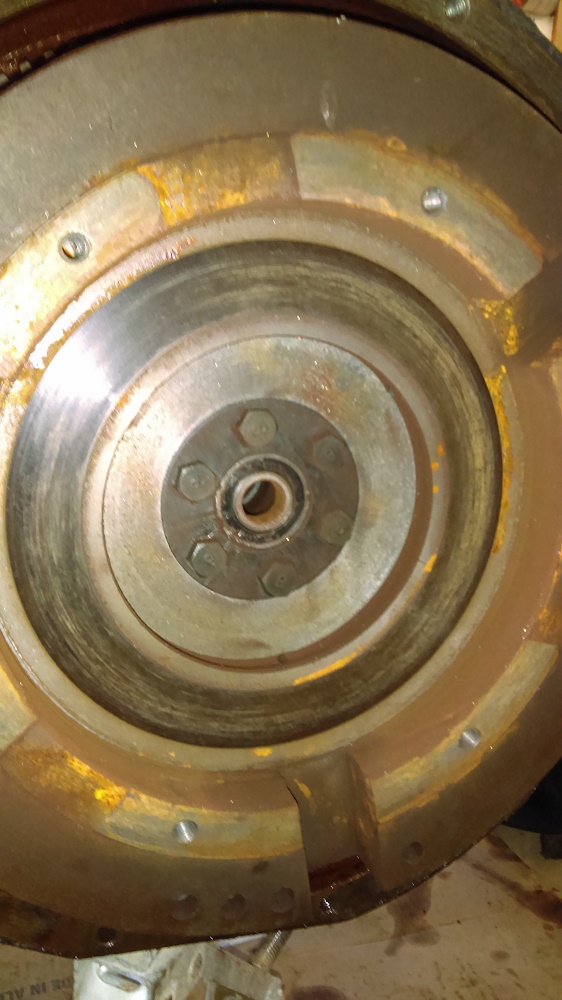

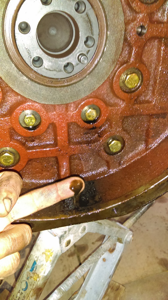

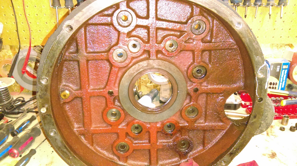

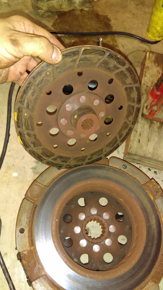

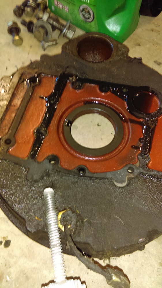

So anyways movin along here, I got some time to keep posting. My progress is further but i'm waiting for a gasket plus a couple of other parts so i will post a bit at a time. The first couple of pictures shows the the tractor split. with the hoist I can slightly adjust as I wiggle apart. the next pics show the mess that was occurring. You can see the rust that was forming:yuck: so this needs to be cleaned up as best as I can. ****** need a dedicated shop!! The last pic is showing the oil leaking in behind the clutch.
/ Foton 254 split

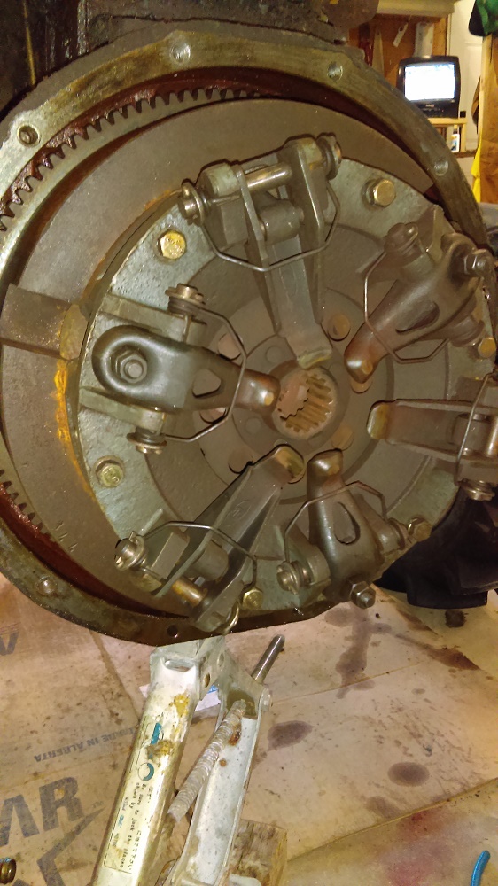

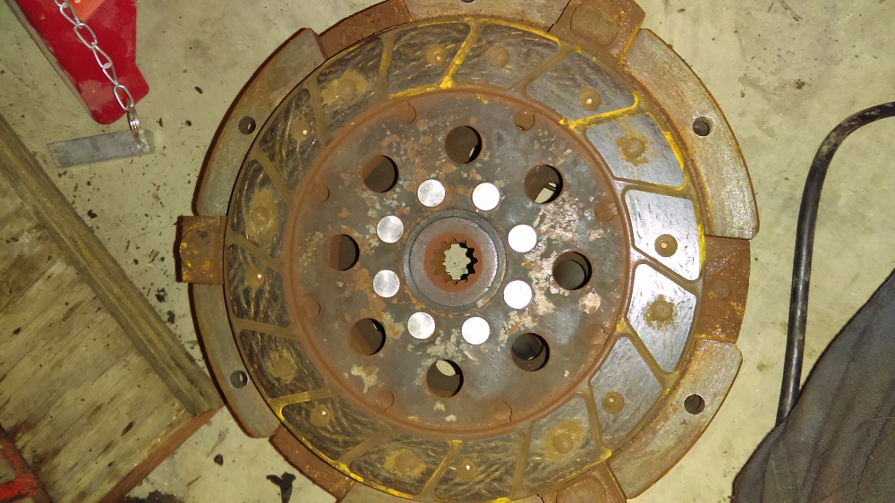

I forgot to mention before the split that on the other side the throttle cables for the fuel pump needs to be disconnected as well as some other connectors. Its pretty easy when you can see where you need to split and what needs to be disconnected. Next comes the clutch removal.

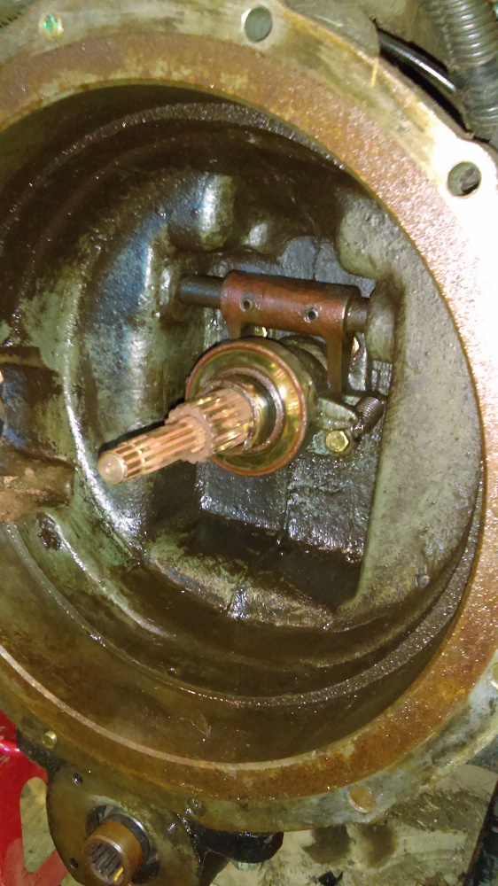

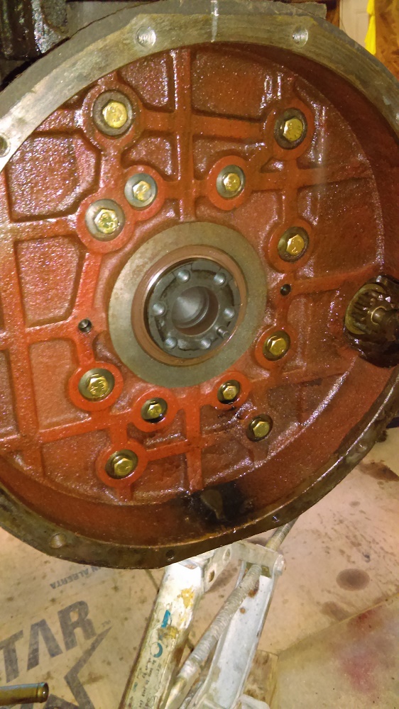

With the picture you provided of the tranny/PTO input shafts, I'm wondering if my problem where the PTO will not fully disengage might be due to the shaft being rusted and dragging inside the main shaft? Does your PTO shaft spins freely?

Hey dotcom I got some better pics of the shaft and how it separates I'll put in shortly. As for your PTO shaft is there any grinding when engaging or disengaging? One thing I noticed is I've been having a bit of grinding when going in. I'm going to study this pretty closely before reassembly. You might have a theory there. The rust I'm trying to clean up as best I can.

Yeah with the clutch fully depressed the gears are grinding on ine when I shift the ratio from 540RPM to 1000RPM. If I push the lever hard enough I can stop the gears from rolling but I'm going to end up bending a shifting fork so I just start it in gear. I checked the PTO clutch and the clearances of the fingers just before the winter and even tightened them up a bit and it still drags. After seeing your shaft rusted like that I'm wondering if that isn't my problem. I need my tractor for snow removal this winter but I'm going to split it next spring/summer. I wonder how that PTO shaft slides out? :)

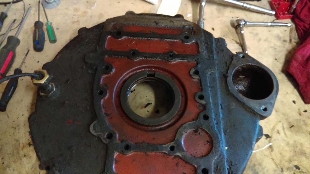

Sorry for the delay, should be gettin my parts tomorrow; yeh! anyways, Dotcom, ive had the hydraulic assembly off to expose the tranny and if I remember correctly the 540/1000 lever moves a coupling back and forth to switch gears. I probably will do that again seeing as im this far and all fluids are getting changed. As for progress i'll post some more pics. Of course the bottom bolts that hold the bell housing to the engine were maybe 5lbs if that. All of them no more than say 10-15lbs. Thats pretty sad! This is why we have the forums!! A grinder with a wire wheel is good to get that old gasket material off.

Hey good luck with everything and thanks for the documentation with lots of pics. Was that a little slip with your choice of fingers displaying the oil in pic 6 or were you making a statement :thumbsup::D
Dave
/ Foton 254 split
#16
Had to think about that for a second, than the light bulb went on. Didn't even notice the salute but hey I guess its appropriate for the situation lol. Still waiting for my gasket not at the post office yet. Am I guess. Whew can't wait. Meantime I took the rad off and did the inevitable blow the chaff out and flushed it once again. Got me a 12 volt rad fan that I might rig up here with some sort of easy removal protection screen. I hate stopping just to remove chaff. Picked up some more fluids today as well. Its gonna be a mechanically sound tractor once again, I hope!

Succor,
When I split my tractor last fall, I had already planed to retort the bell-housing bolts.
When I put my impact gun on the first bolt, it come out like not torqued at all. So I did pass the tap and clean each hole with brake cleaner then put red Locktite on each bolts.
Jacques ☺
