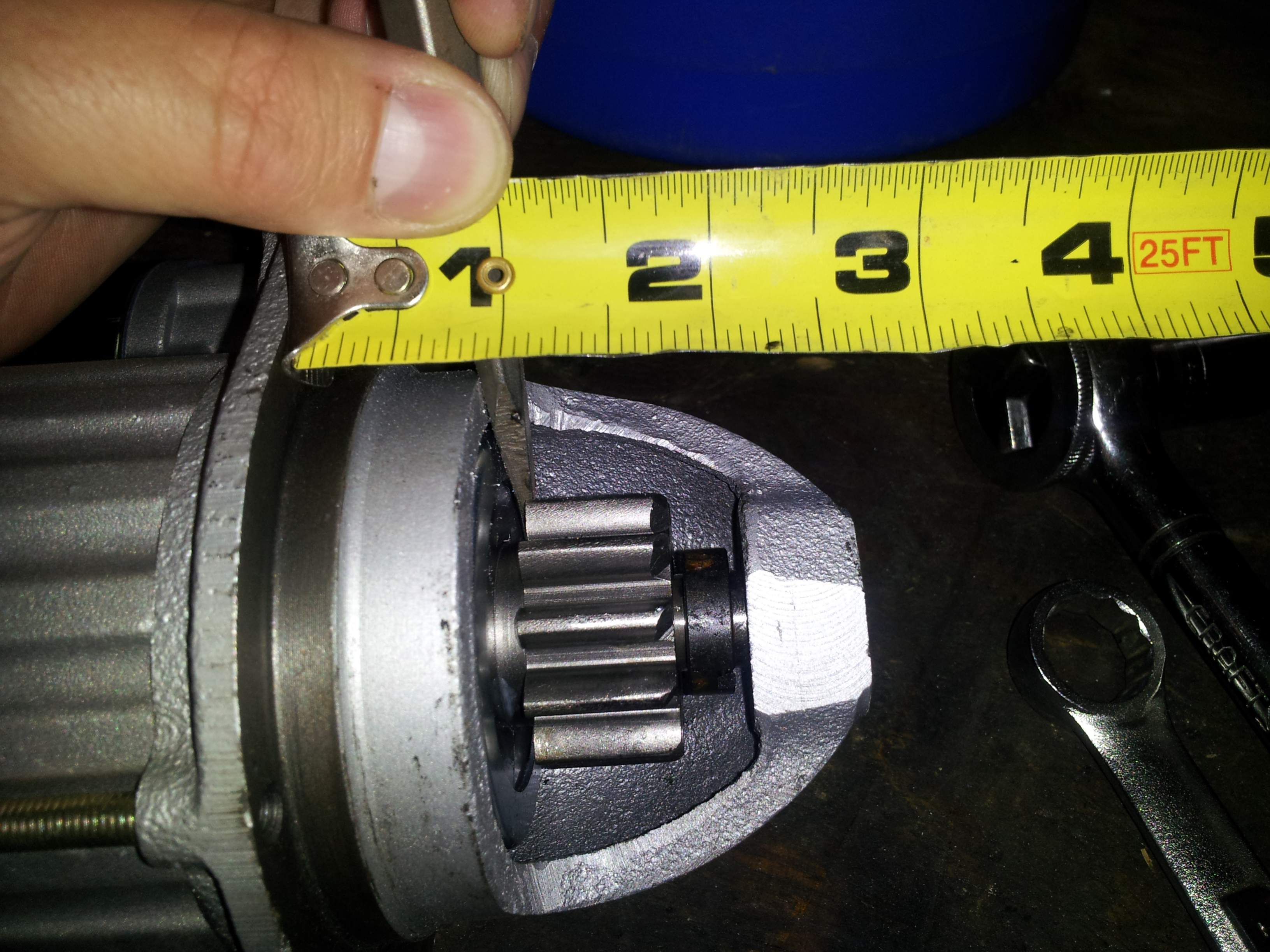

Thanks again for all your help! Just let me know where, and what, to buy for the winch. I checked the parts manual and it lists three starters: QD13L, QD153 (this is number of old one), and QD1401.
Also, is there any other type of internal mechanical issue that would cause the flywheel to be further forward than normal but still allow it to move freely?

I thought about physical problems like a worn ring gear, or pinion, but it never really occurred to me that the pinion would not really reach enough to engage. I have never encountered such a thing.

Nope. The BT and ABT both used the QD13L originally. In the Foton anyway. But that's an obsolete part now, having been replaced by the QD1401. Not positive, but I think the 1408 goes in the 45hp Jinma. It is one tractor I know uses the ABT version of the SL3105. And I'll speculate further that the difference in pinion throw is due the difference in flywheel placement (Jinma vs Foton).
I am pretty sure however, that your other supposition is accurate. Somebody stuck that 1408 in there because the bolt holes matched. When it still wouldn't start, he just said the **** with it and stuck it in the auction.

The starter it needs has to have a total pinion throw of about 2 3/16" from the mounting flange of the starter. The one we have only has a pinion throw of about 1 3/4". If you need to call me about it just PM me or check your records, you have my info from previous orders. I live in Daleville Indiana and my full name is Chris Anderson
Just out of curiosity, did you get that 1.75" measurement when actually using 12 volts to throw the pinion out? Or just when screwing it out by hand? In my experience, the pinion gear doesn't always reach all the way to the back side of the ring gear. If the ring gear is wider than the pinion gear for example, some may mate only to the actual width of the pinion gear. I've even seen some where pinion gear engagement depth is only 50%, but the tractors start normally nonetheless.

I got it by measuring the distance from the starter mount flange to the bushing that stops the pinion gear on the shaft. I then confirmed it by prying and spinning the pinion out with a screw driver. I have talked to Tommy twice today and also to the guys at his shop and they confirmed my measurements. They also took every starter they had off the shelf and confirmed the measurements. Its a head scratcher???
Here is a pic I took with my cell phone showing what I got. With this setup the starters pinion will only engage 1/8" into the flywheels ring gear which is just not enough.
