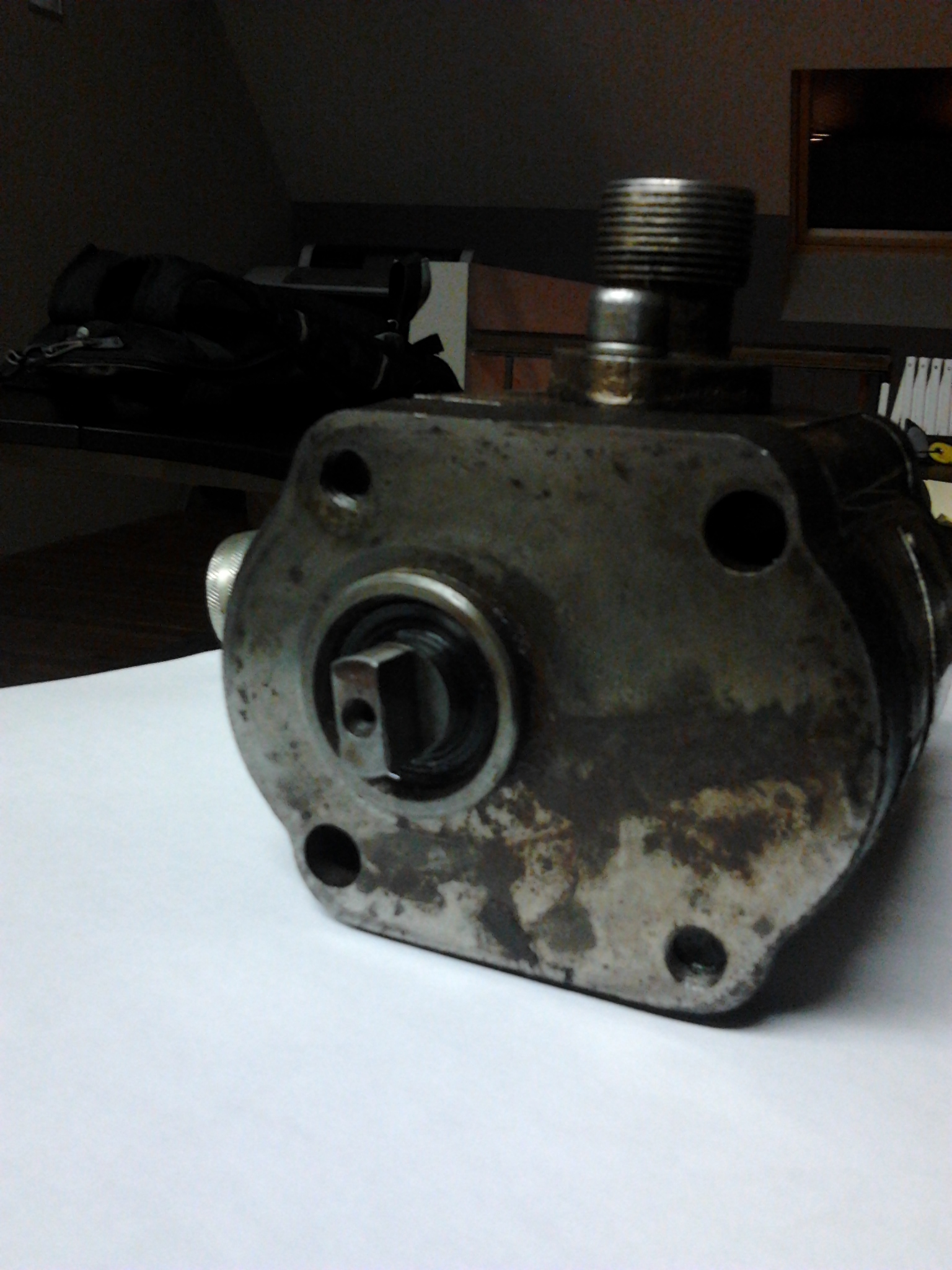

Hi Greg and Brad,
Thanks for your replies.
I had ordered a new pump CBN-E314 (for my jinma 454 with FEL), because this model number was indicated on the original pump.
By visiting several distributors and forums, watching the pictures, I think I will need the CBN-E314L instead of the CBN-E314. Could you confirm this?
This is a picture of the original pump on my tractor:
This corresponds more to the CBN-E314L like on this page: CBN-314L
than the CBN-E314 on this page:
CBN-E314-new style
Also, I find it very strange, that on all sites, they recommend this pomp for tractors from 18-35hp, while my jinma 454 tractor has 45hp.
Thanks a lot for your help!
Koen
   / Foton: Instal an inline filter on hydrolics #70
Truthfully, I don't know why you're considering either 314. The higher capacity 316 (and larger) can typically be added with little or no modifications at all.
//greg//
