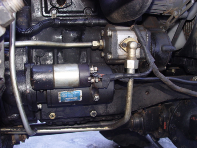

OK! Here they come. This is how the hydraulic are hooked up.

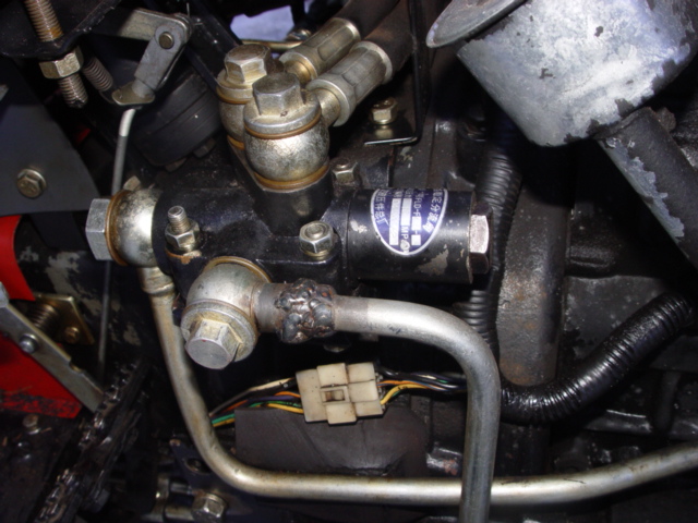

The steel line on the left is coming into the valve from the pump. The exiting line on the right is going to the remote valve on the floor next to the operators seat.

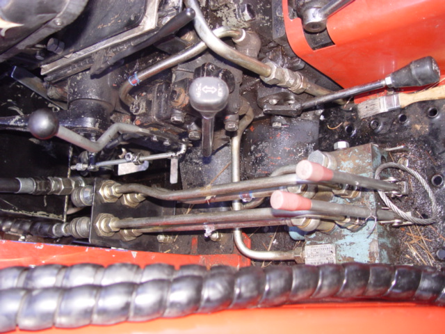

#60
You can see the two hosed going back to the auxillary valve from the FEL valve. The valve handle has been wired back so the valve on the FEL can be used. On the second picture,above, you can see the slobber solder on the right hand steel line just below the banjo fitting, I'm guessing there may have been a fitting where the FEL valve intake hose was attached.
