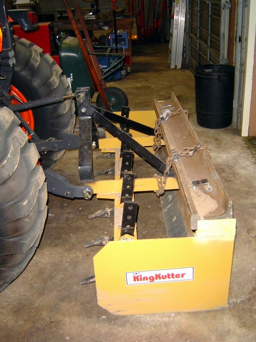

Hi Kebo,
Yes, I have lived and been around railroads a good part of my life. Norfolk Southern runs across from my house. Always had a fascination for rail, engines and that sort of machinery. Some of the small pieces of rail I have gotten have dates as far back as 1898. And it does not look much different than some of today's rail. Some cross ties are dated also, if you look. One place not far from where I live now still has the old cisterns buried in the ground from the days of steam. Steam engines had to be replenished with water, and the water was pumped from the cisterns. It's a dangerous place now, but very interesting.
A couple pics...
My box blade/ballast weight. I have different rail sizes in 6 foot lengths to adjust ballast. One piece weighs about 150 pounds, half the weight of the one shown. Also a pic, (a little off topic), I think you will find interesting about rail...a new RR siding being installed...notice the two rails together...both are all one piece about 400 yards long each, brought in by RR flatcars and dropped off, pulled into place by dozer before the cross ties are laid. They are like long noodles when they move them around. You wouldn't expect that...

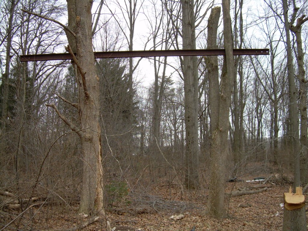

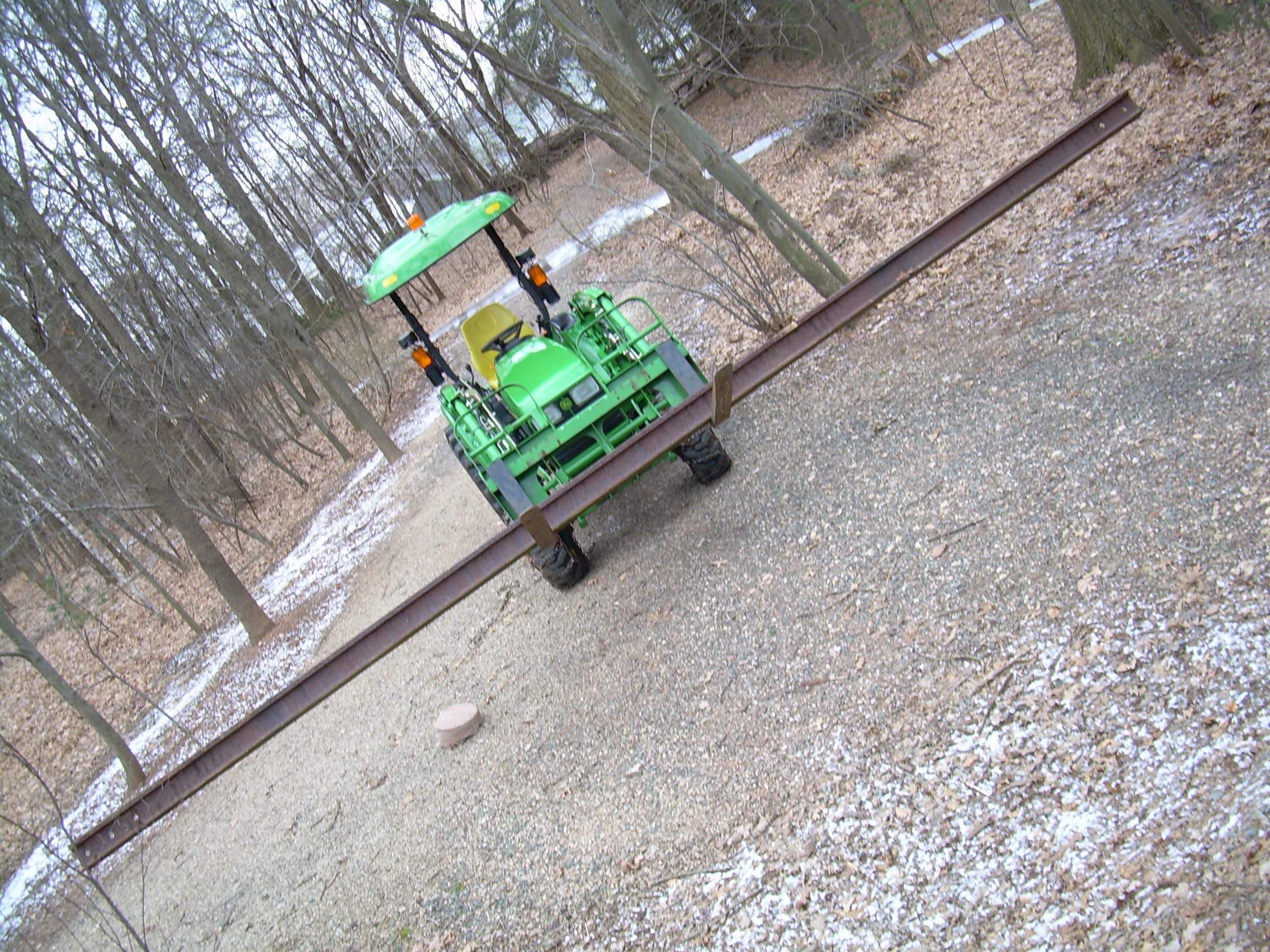

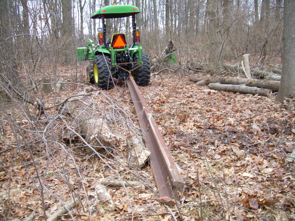

Always wondered, does anyone know is the rolling surface hardened or not? or is it just the mass of steel that makes hardening unnecessary.
the band saw would be the cleanest and easiest of all, but not practical for out in a field.
a couple of pics of mine I got from a neighbor, is the heavy version for sure, never read the side.

JB,
That I know of, the rolling surface known as the "ball" of the rail is not harder than the rest. I do know that some switch parts and frogs are harder than the 1/4 mile strings of rail. We drill it will very low speed 3/8 inch drills for wire connections and one can tell!
The track folks use 14 inch abrasive wheels to cut it. I don't know if there is anything special about them. I know the saws are specially made for rail cutting. Clamped on as not to bind in any way.
