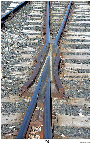

Always wondered, does anyone know is the rolling surface hardened or not? or is it just the mass of steel that makes hardening unnecessary.

That doesn't look like very big rail. Normally you can tell by how many bolt holes are drilled in the rail for the connecting bars. "Angle Bars". That looks to have four bolt bars making not much bigger that 112 lb rail. The roadbed looks like it is pretty well maintained for light rail, possible a business served by the RR.
That rail saw and drill is pretty impressive! I've never seen anything like in the field. In my youth i used to watch the old track guys cold cut the smaller rail. They would whack the ball of the rail with a wooden handle cold chisel then drop the rail over a tie and the rail would cut clean. Those guys never use a torch for rail that will remain in service. Goofs up the temper. In demo they use propane/Oxy.
That's interesting, I thought it was more of a cold rolled, that sounds like how cast would act.

I suppose because it' so hard. You'd be surprised how easily that rail can break. Even the big stuff especially when it get's cold. That's when our signal system comes in pretty handy. Broken rail..... red signal.
