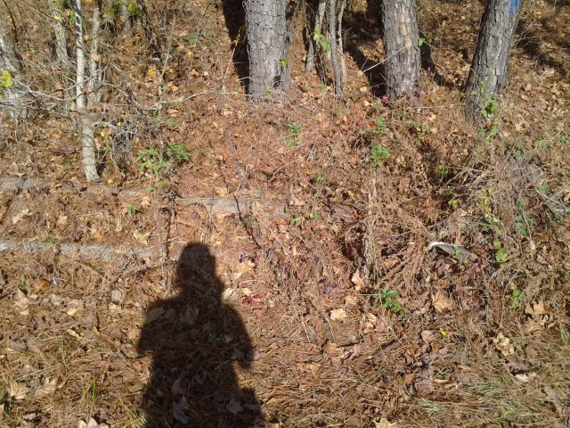

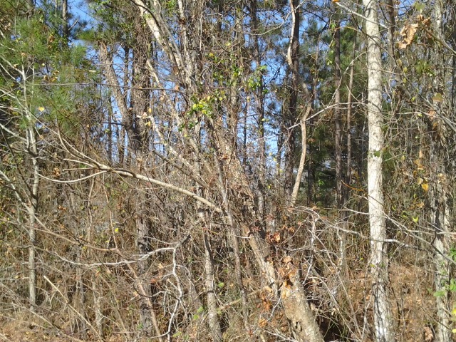

This tree is just inside my property and has to come down. If it snaps off some of it could kick onto the county road which could cause a accident. While looking at it this morning I found one of it's brothers that is broke off near the stump. For both of these I was thinking rope and pulleys pulling away from me and twice length of the trees. What I don't like is that I am going to have to take my tractor off my property to get the second one and it is all ditch. Here is a photo of the second one that is split vertical near the base.

Also remember that when a tree is hung up, when you saw it the "kerf" (saw opening) doesn't open up because the tree can't fall/pivot. All it will do is pinch the blade in compression. That is where a wedge is handy.
...but those first pictures look dangerous. If you cut anything at the botton, it might pivot any which way and who knows where the top piece comes flying down to. Use a big cable and a big tractor. Hook it high for leverage and pull the whole tree over, roots and all. :2cents:

If it is a hazard to the road then contact the road commission folks or whatever they are called in your state and tell them of your concern. They will probably take it down for you due to public safety concerns. At least worth a try

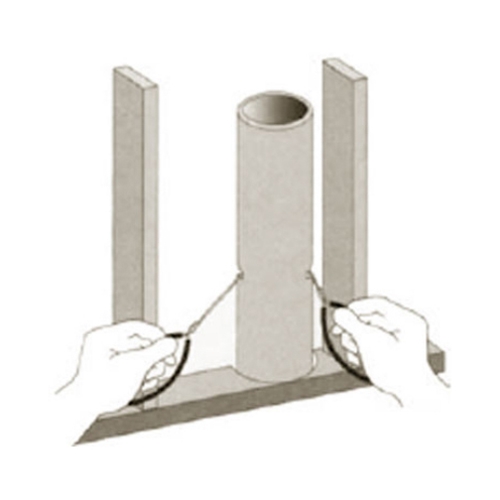

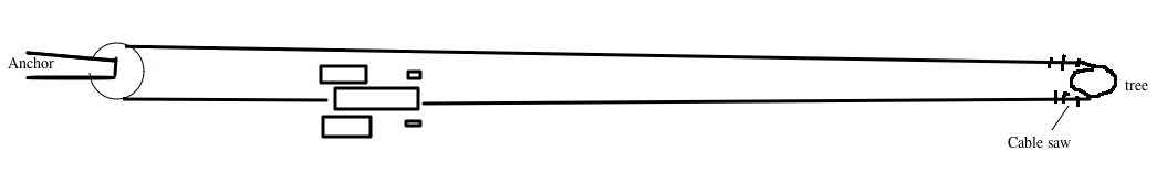

There is probably, in some industry, a large version of a cable saw. If you had one you could back off 50 feet and saw your tree. Hook it up and drive back and forth 10 feet to saw the tree.
