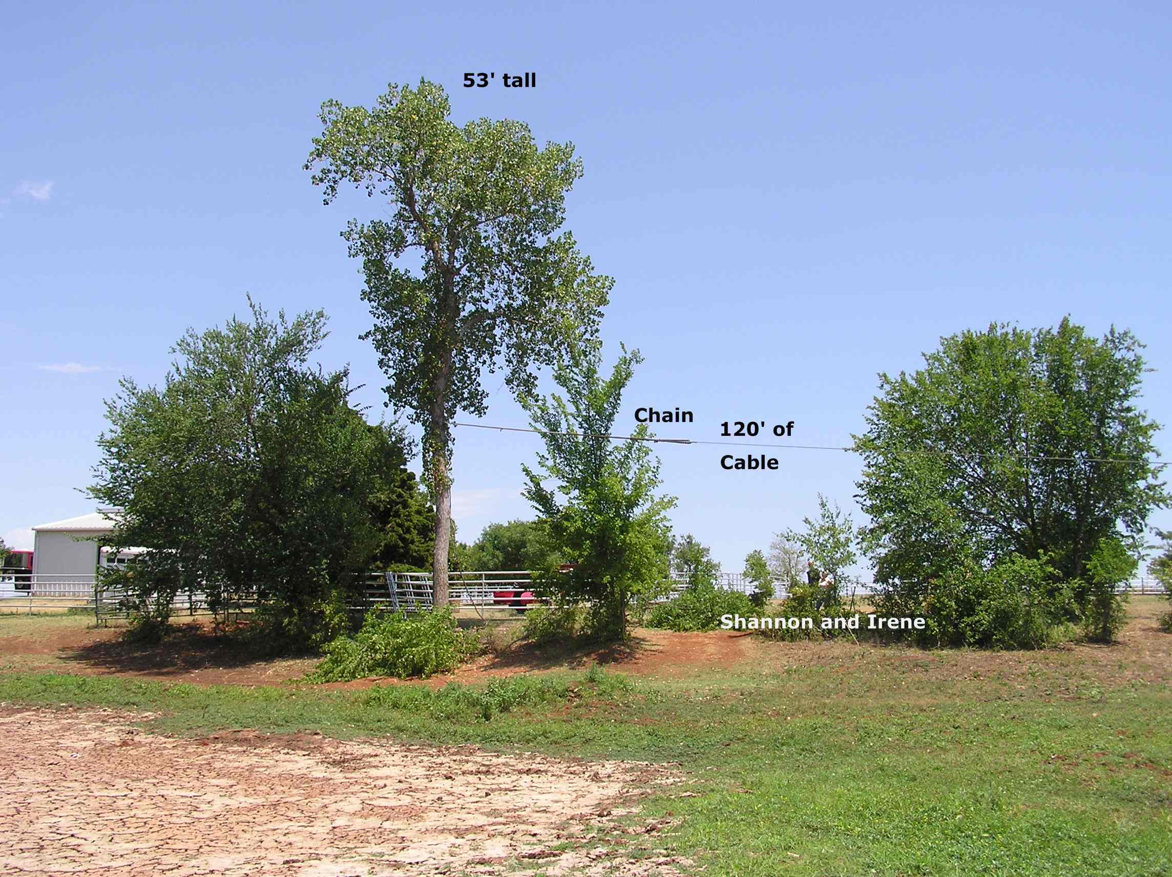

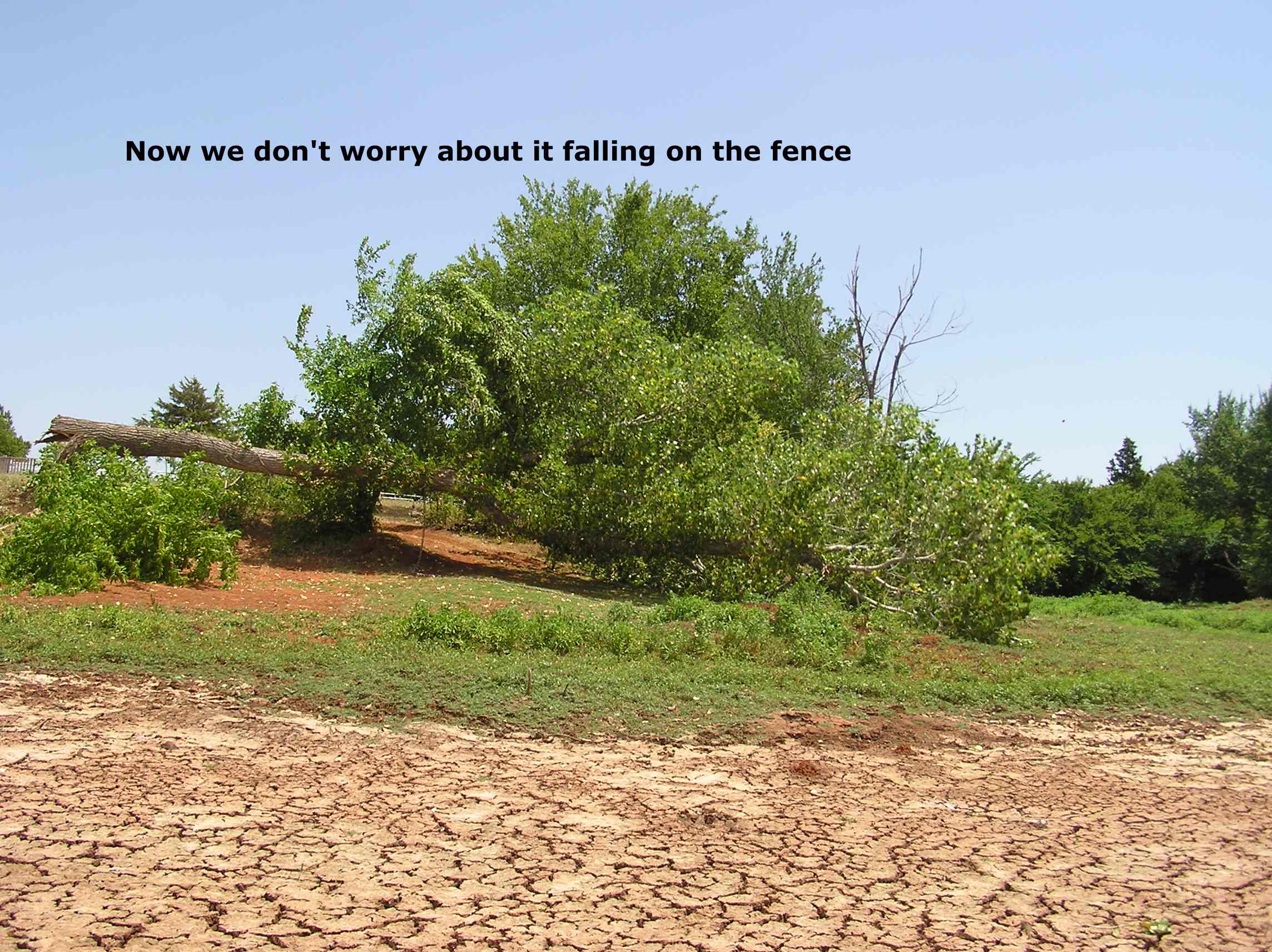

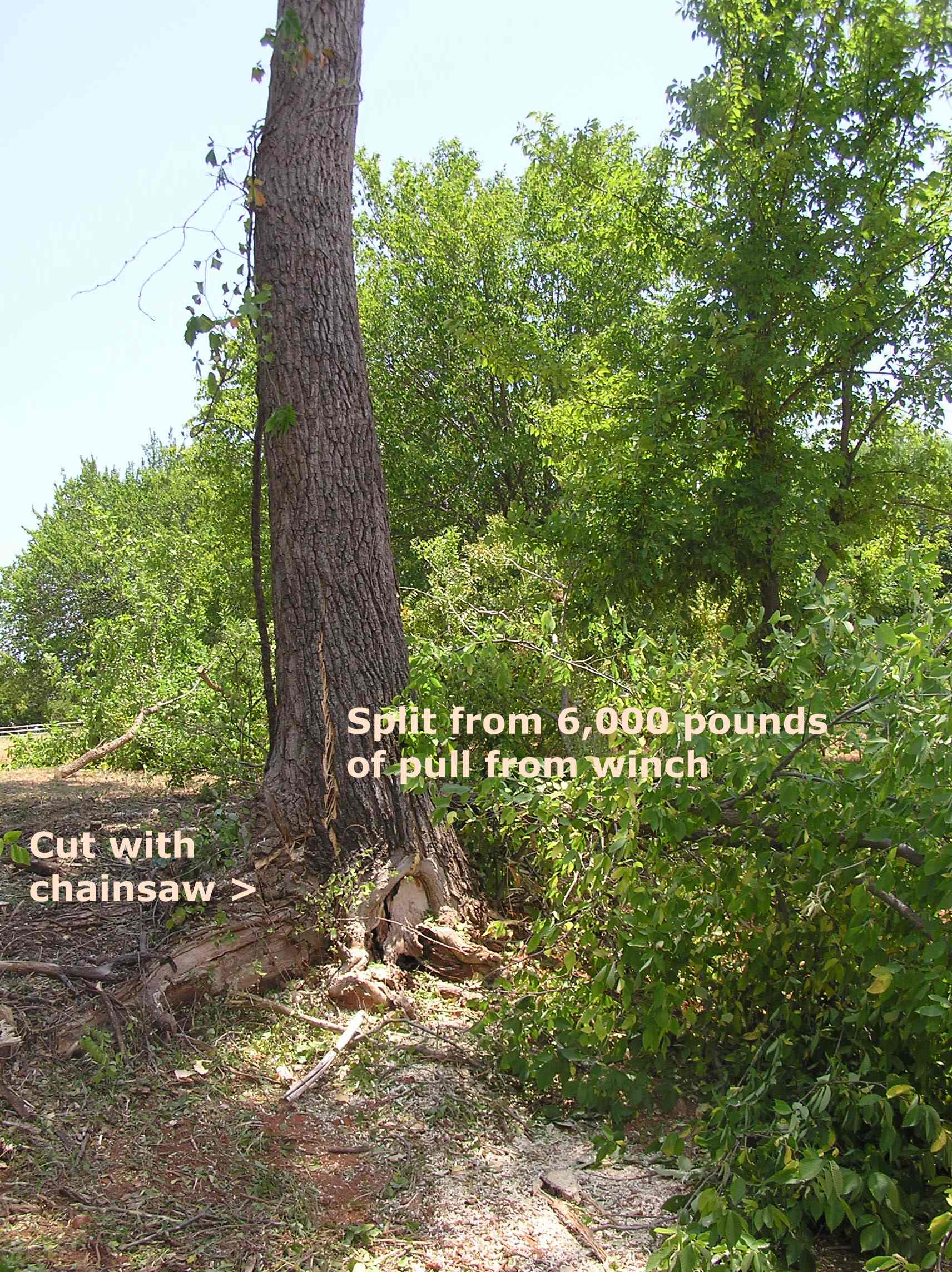

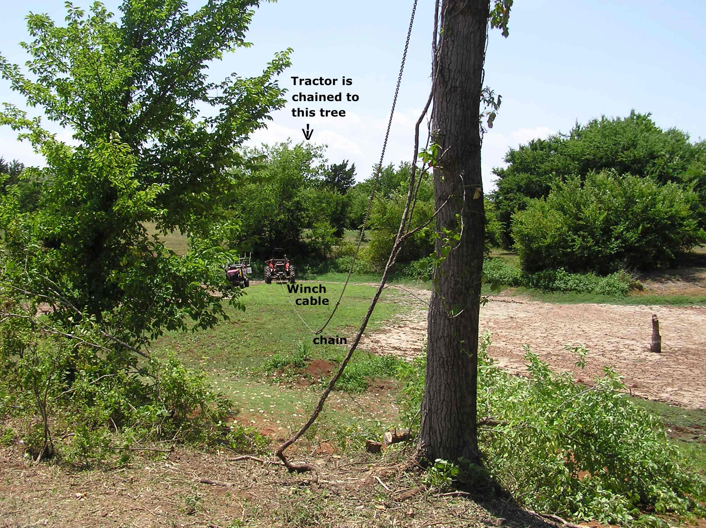

Do you have a winch?
I have one on a receiver mount that I could use on the front of the tractor that I used to have.
Pictures from July 2009.

I too vote for a long cable and a snatch block. (Snatch block to either reroute the pull from a desired direction if tractor can't access that direction, or use it to double your pulling power.)
What will happen if your saw didn't cut very far through is that when you pull with a cable, you may open the kerf wide enough to get your bar and chain out, but there may be too much holding wood for the tree to fall over.
Now you're faced with a dilemma.
Walk away or cut some more? If you cut some more, keep in mind that pulling on a tree from the top while back-cutting the bottom is a good way to create a barber-chair (where because of the top pulling, the trunk splits vertically right up the tree, eventually the whole tree breaks off and falls unpredictably from a height above your head! )
It's a fine line between pulling too much and just enough so that the kerf opens as you cut up to the hinge.
