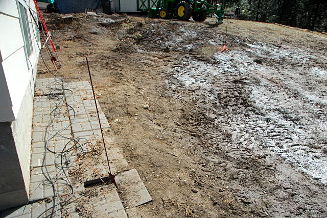

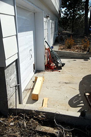

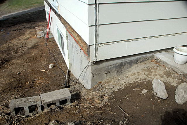

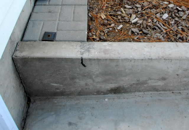

The first picture is what was there. Since, the deck has been torn down. Couldn't believe how poorly it was constructed. The nails came out and it warped. The posts were set on concrete rounds only 6 to 8" deep.
Anyway, the next picture shows the level of the floor vs fill in the front of the house. This wall is about 15" high and goes level to the other end of the house. So, as you can see in the picture, the fill slopes higher towards the back of the house and under the deck there is less and less height. I plan to extend that back wall by 15 feet and add a full retaining wall along the first half of the deck from the back, and a lower height wall for the rest. I want to fill under the deck with concrete. So, I have been thinking it would be nice to have it full height for all the space to the back retaining wall. I wasn't planning to enclose it in front, but may decide to later.
So, after measuring the existing floor height vs front fill, I guess I am looking at a 15" difference. Keep the fill at 15" and live with a 6.5ft hight to the ceiling beams, or dig down 15 more inches for the full 8ft height? If I did this, then it could become a second small garage. Not that I need it for a full garage because I am planning on a 40 x 80 building about 250 feet from the house. But, for convenience items such as the garden tractors and other hand power equipment.
I am in an unzoned rural area and don't require permits. Regardless, I want it done the best possible way. Is it too risky to go down the additional 15"? I don't yet know how much lower the existing footers are deep. Our minimum lows typically do not go below -20F for not longer than a week or so.

/ Foundation questions #7
Well,what the previous posts are saying still remains a potential problem assuming you proceed with your plan. Picture this scenario; When the house was initially designed and built, the masons probably poured a continuous footing at one level based on the premise that the front of the house would receive at least two feet of backfill. They should and most likely did pour the footing level at a certain distance below grade for protection from frost and to meet code.
Now here you come maybe 30 years later with this plan to excavate that two feet of fill away from the front and install a stilted deck and you are wanting 8' of headroom with a concrete base none the less. Being it is going to be concrete you will probably scrape what little snow gets under a deck (slim to none) over the Winter. So you have not only taken one thermal blanket consisting of 24" of backfill but will also keep or not receive any insulation quality due to the lack of any snow.
What we are trying to say is that it looks like you are creating a vulnerability for your house due to frost penetration in your cold climate. Make sure if that footing should be exposed with this plan that you are aware of this potential problem before you commit to such a project.
Frost levels for footings in areas where Winter lows can gt down to -20* F are probably at the very least 42"from top of grade to bottom of footing. You might be able to use a layer of Styrofoam placed on top of existing house footing and left in place beneath any potential flatwork to reduce frost depth codes. Another consideration to think about after looking at your current elevations now. If you lower that grade will you be creating a situation where water has to run back toward your new concrete floor. You sure don't need that to ruin your day. Good luck and I hope this helps.

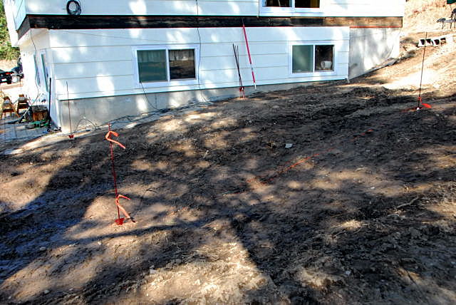

Thanks for the input!
It sounds like I should not go deeper than it is in front. It is lower on the other side of the house for a 1 car garage and there is concrete at that level out in front with another 15" retaining wall from the edge of the house. If I was able to do that on this side, obviously, I would need another short retaining wall there too. I am not talking about reducing the level at the front of the house, but only along the side and create a similar pad to the existing garage on the other side of the house.
We are re-building the deck into an enclosed sun/screen-room with a lot of glass. The space underneath is bonus, but I would like as much available as practical.
How likely is it that the back of the house footers are higher than in the front? Could I have the same issue if I level out the space under the sun-room to that same 15" level, maybe sloping back just slightly.
If that is risky, how about at the back 4 feet, I create another wall 3 ft higher so that there would be a shelf at the back wall. That would still give me a lot of space underneath and still have the back footer well covered. Is this a good idea or anyone have any better idea?

/ Foundation questions #9
<<How likely is it that the back of the house footers are higher than in the front?>> (skidoo)
Good point. For the sake of argument let's assume the footing was built according to code and that frost code was 42'' backfill grade to bottom of footing. That would tell us that the bottom of the footing was at least 42'' below the point at which the backfill grade intersects the front wall.
If all our assumptions prove correct (which only seems to happen in Indiana Jones movies) the footing very likely stepped deeper as it ran down the front wall. if this were so, perhaps you would end up with a diminished need for backfill height or a the very least could provide a 2" thick layer of a good sheet foam such as Dow (blue, r-11 ?)foam because removal of that berm has created less protection than needed however you would still likely be deviating from code.
I don't advocate for your shelf suggestion unless you insulate and make it at least 4' or more in width out from building. I still would be concerned with creating a negative grade out from the building which would invite surface drainage towards the structure.

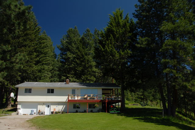

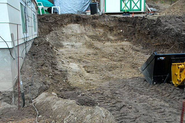

#15
Perhaps another picture would help the visualization. This is how it was. The Deck was removed and the Tree next to it was removed. I will essentially be re-doing it to a similar layout, but lengthening the space to 15 ft from 10 ft, and the space above will be enclosed with lots of glass. The end will be about at the right edge of where that tree was. The deck space out front will remain open but extended to 10 ft in the front. I have been thinking if I could make the space underneath very similar to the garage space on the left. It has the 8 ft height...
I have presently been parking my 2520 under that space with the ROPS down. But, I could only go back half way due to the slope. But, that was enough to cover the tractor.
#16
The weather has been cold, snowy, rainy, etc... So, I tried out this Sketchup program and drew what I think I would like it to end up like.
It was muddy out this afternoon and the wife says "get to digging" or else... She can't wait any longer. So, I dug down to the footers at each corner to see how far down they were.
So far, it looks like these footers may only go down to the basement floor level !?!?! Well, the house has been here for 35 years and I haven't seemed to have a problem. I know it has been down to -40F here in 1989. One potential positive is that the dirt that came out was very dry and power like, almost like an absorbent power... Is it possible that if the dirt remains dry enough that the footers don't need to go very deep?
The dirt under the topsoil elsewhere does seem to be dry and powdery just like this. My neighbor had his own open gravel pit probably 1/3 mile away, and the well has to go down 200 feet...
My concrete and framing contractors think this is doable. What do you think? Any other considerations I may have missed?

#19
Thanks Scott... That is what I would have thought. It sure would be nice to have others confirm that opinion. But, this thread has generated little response. Oh Well...
Anyway, my contractors seem to think it will be fine and they like the 3D sketch I drew. Finally, after the wife was able to see the sketch, she could visualize it and agrees. Before that, she just could not visualize by looking at painted lines and stakes.
So, we decided to go forward with this. Unfortunately, or fortunately (depending on how one looks at it), this is an evolving plan. For example, we have decided to have the full space underground, but that was not the primary purpose of this project. So, I am still debating on how to best use the space. I could use it as a second garage to collect stuff, dedicate it for some parking of small tractors, or a car, or a separate work shop from the other garage, i.e. one for metal work and the other for wood work, or I am thinking it would be great to function as a root cellar. I think I will start a separate thread on that idea.
Here is the progress so far. My concrete contractor wants the trench for the concrete forms about four feet deeper than the existing floor in the back, side and front. He says he wants it that deep not necessarily for frost, but for strength due to the amount of dirt being held back.
/ Foundation questions #20
skidoo- after seeing the cad drawing, I agree with your contractor. You definetly need to have deep footings for the back/front and side walls to hold back the dirt. If you don't, you can get some cracking in the walls without the deadmans posts installed. SO getting a deep footing will help with stablity just like a regular basement to hold back the dirt without deadmans posts. deadman post is meant only for wood or rock walls, not concrete walls like the ones you are proposing. Good luck and keep us posted of the progress. I think it will come out nicely as the cad drawing you have.
