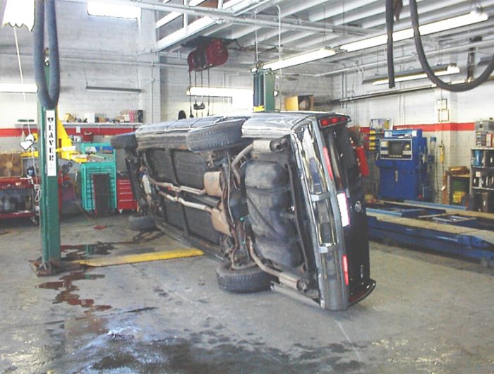

Here is the reason that I won't consider a 2 post lift. Sure, it doesn't happen every day, but when it does, it does ruin your day. I have seen this happen too often with heavy vehicles. You don't want to be near this when it happens.

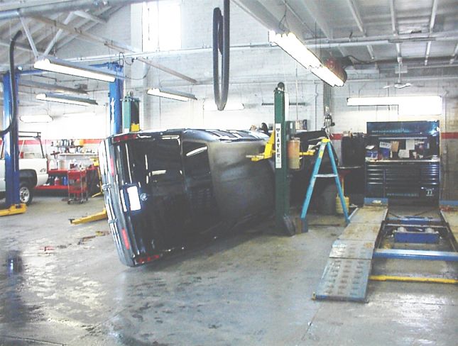

Picture 2 ....... this accident happened at a Cadillac dealership and the person that put the car on the lift was a experienced mechanic/technician that had been using the lift for many years. This car had been serviced on that lift many times before this accident. This happened as the car was being lowered. The car was a total loss....

Safety was a big concern when I bought mine. The KW lift is overbuilt for my needs., and extremely stable.

No doubt that the potential to get hurt is there.
I think that cars that do not have a frame are more dangerous. If you try to lift the vechile on a point that is not strong enough to take the weight you will have a major problem. A truck with a frame is safer.
Also you never see it done, but if you stick a jack stand at each end of the two frame rails you can reduce the risk. They make 2 ton jack stands that are very tall for this purpose.
