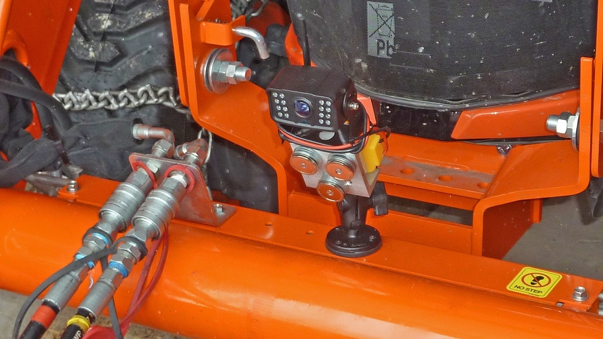

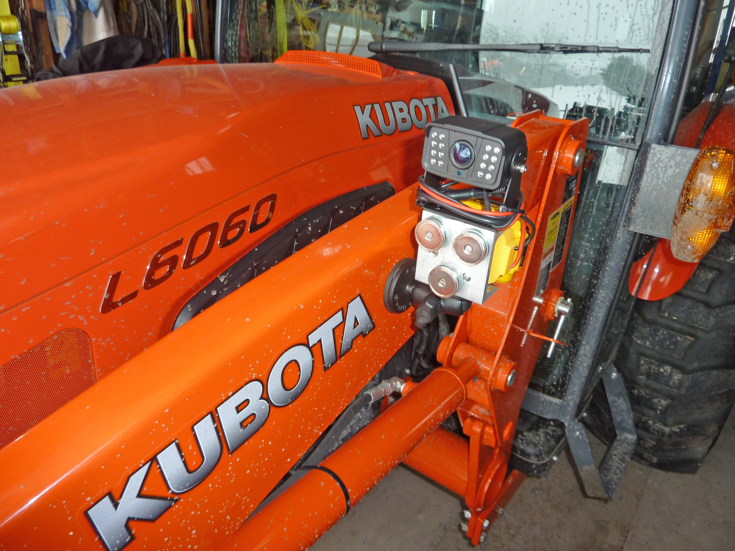

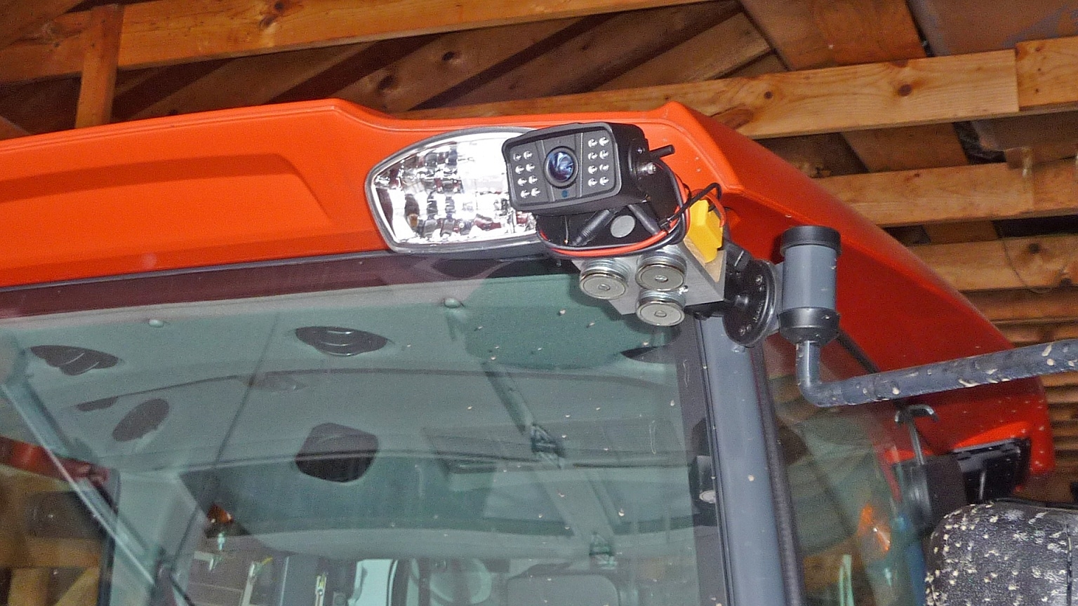

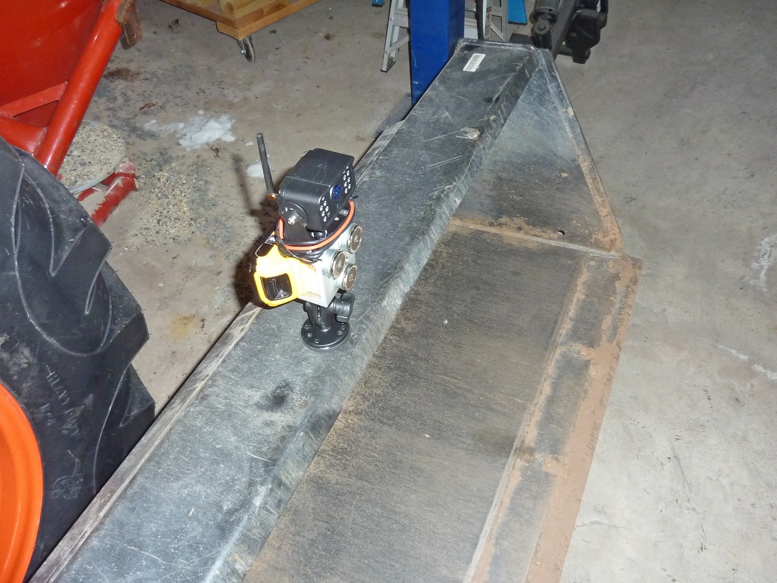

I find the rod level indicators on both my L6060 and MX5800 to be marginally useful. They have their faults but are better than nothing.
What would be useful is a level indicator for working with forks at near max height. It's sometimes tough to judge with a cabbed tractor. There is no guarantee the pallet is level though, so trial & error is the only way.
I do use portable cameras with magnet mounts for some work operations:
Level isn't always where you want the implement to be.
That's what I was asking about. Show us your monitor/display. I have a friend who installed a wireless aftermarket camera in his pickup for a backing up display that is monitored with his cellphone in a holder on the dash. Works pretty well.
Anyone with a newer vehicle has a built-in backup camera system, and most these days are very very good.

I posted this some time ago. It won't replace a good wired camera system but it's completely portable:
There are many portable camera systems available but most use proprietary batteries and always seem to need charging when you go to use them. I solved the issue by using cordless tool batteries which I always have around charged and ready to go.
Missed that thread. Nice work.
I already have a Milwaukee M12 battery socket. Very cheap aftermarket.
