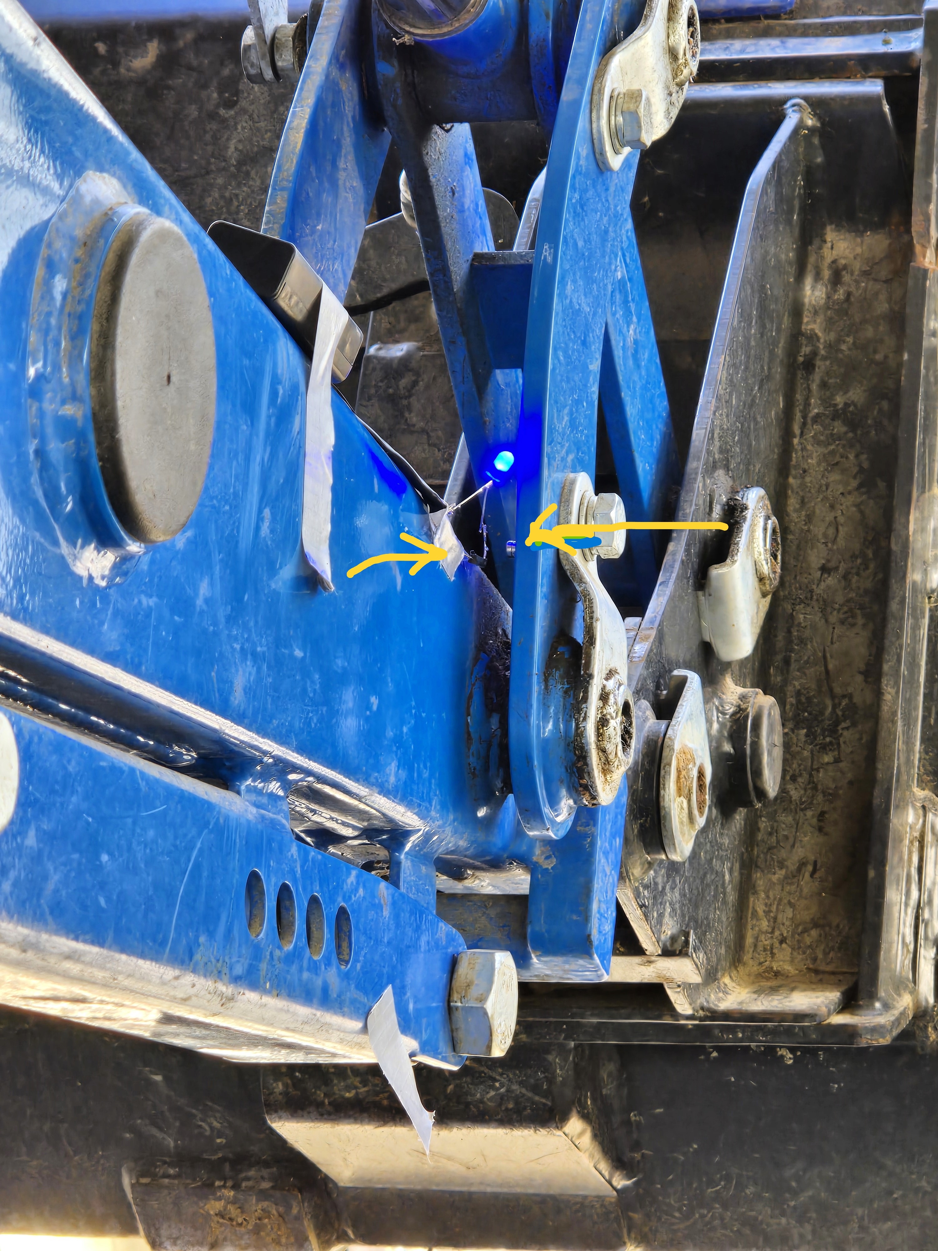

I posted earlier that my rod keeps getting bent and is not very useful and decided to work on this.
My solution cost around $25 and indicates when the bucket is flat relative to the ground at any height.
It also stays with the tractor and is useful with forks.
IIRC Reed switch (pkg 5) was $5, led and magnets (8 magnets, 16 leds) $8, battery holder (3 holders AAA) $8
This is a test set up I need to come up with a permanent solution. Blue led comes on when bucket is slightly below level and goes off when bucket is brought back up to level. This is all adjustable on how to set it up.
B-pos-----LED----reed switch---B-neg The led will be relocated up the lifter arm or dash and probably be red.
........................Magnet............
Battery holder 3VDC
on left arrow reed switch and led
right arrow is magnet.
   / Fragile, Inaccurate, or Useful? Let’s Talk Bucket Level Indicators! #67
Unfortunately; the above did not work out as planed. Back to the drawing board.

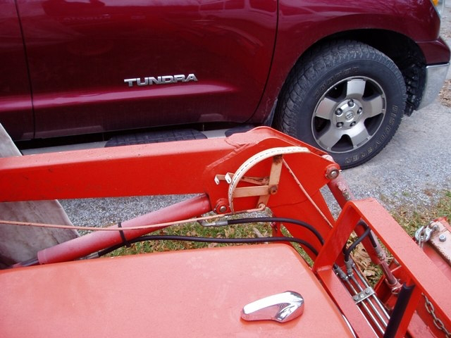

Thanks, I found that simple flat bar on top of the bucket useful too. My hat's off to Kubota for doing it - and doubly so because they did it without any fanfare or even any explanation. For the longest time I wondered what those flats on top of the bucket were there for. I bet I'm not alone.
And anyone can easily add that feature to their FEL to better judge the angle of the bucket cutting edge. The downside to that simple solution is it still needs well-calibrated Mk II eyeballs to confirm how the level changes when the loader arms are moved. The better the eyeball, the better the leveling.
I am also greatly intrigued by Medonsy's setup back on message #11 - the one where he shows a curved gauge with dual pointers - one pointer showing bucket angle now, and the other pointer showing the angle the bucket will have if lowered at the ground.
That is a one very clever idea. .
