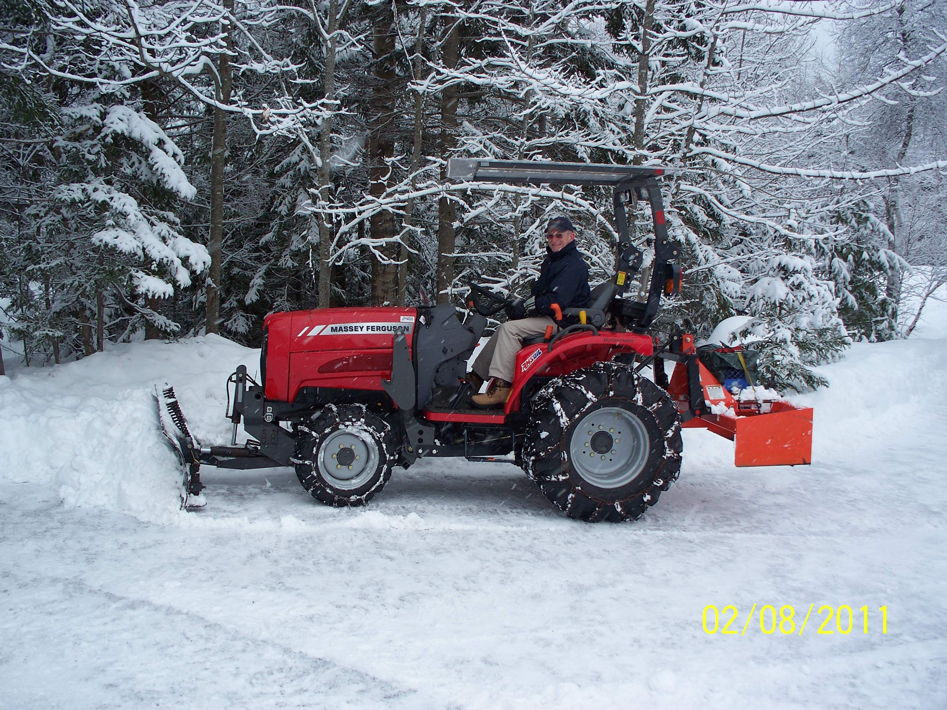

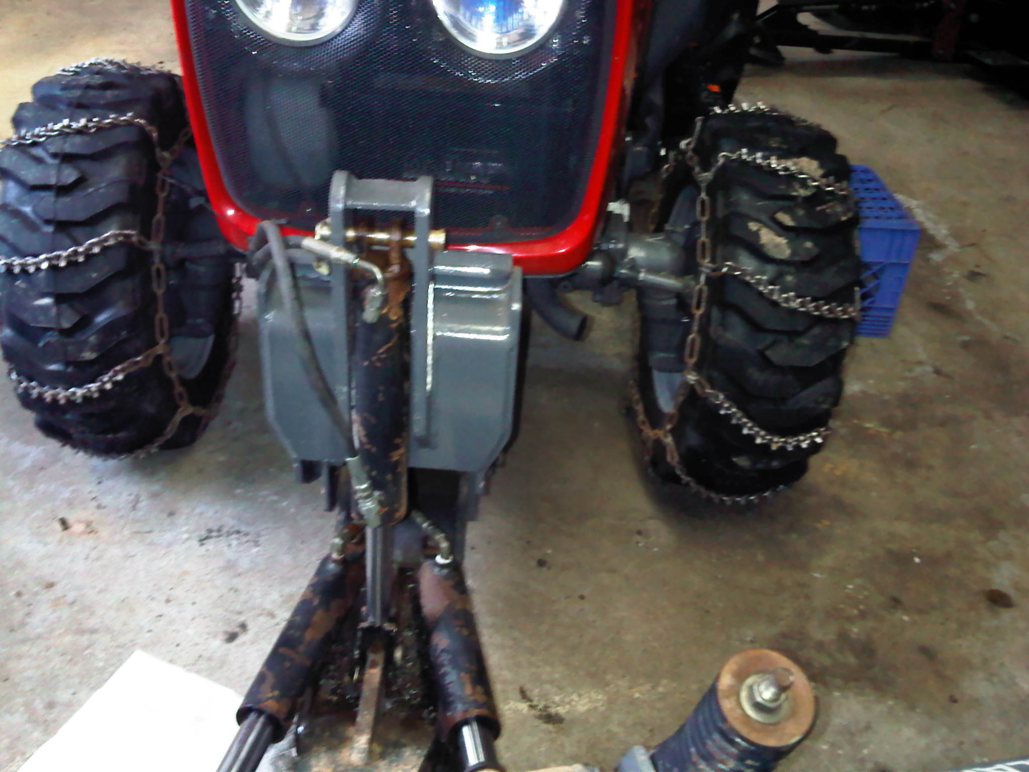

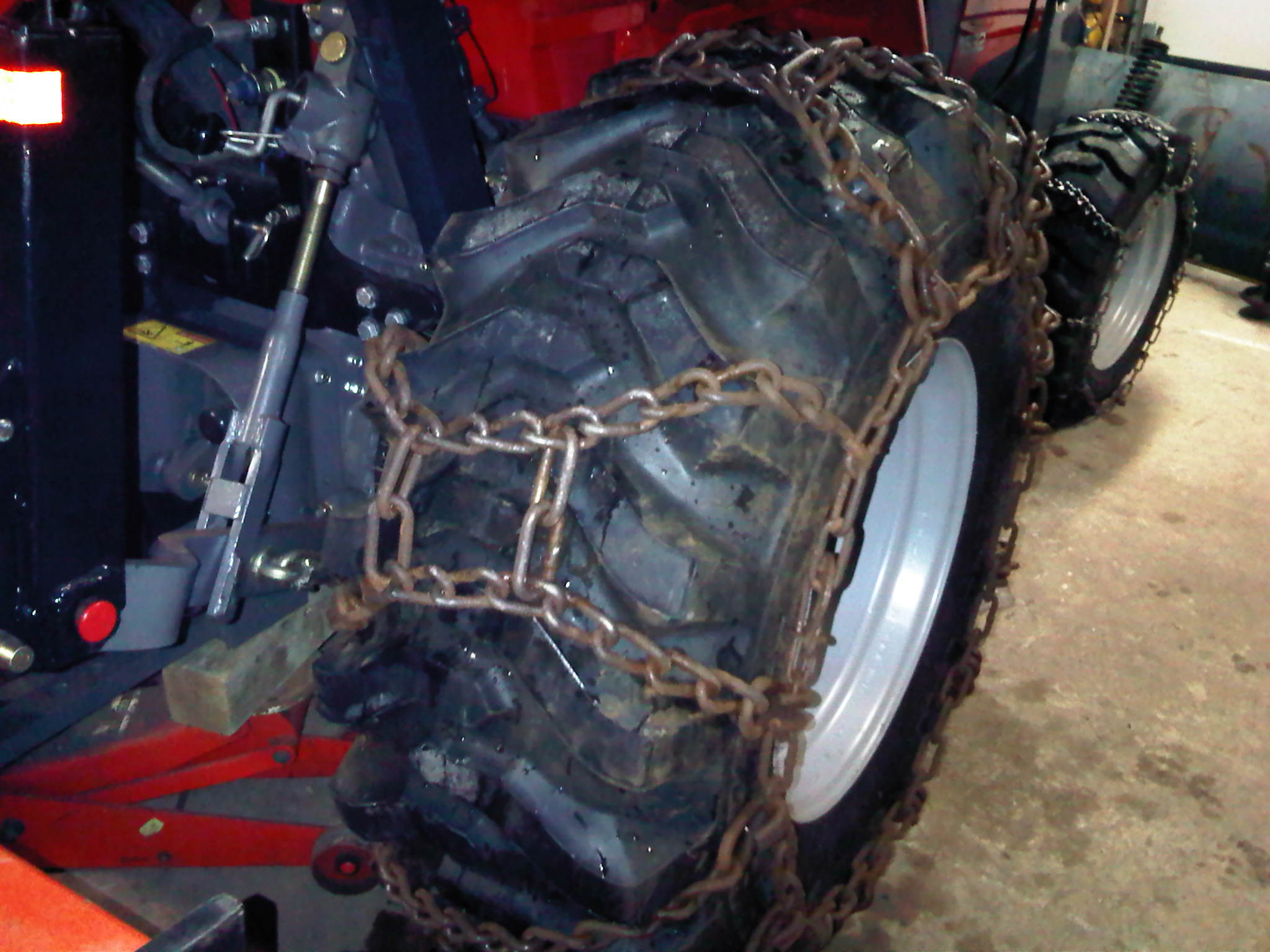

Pics of the plow on 1532, worked great , will be much more comfortable with the cab this year. if you zoom in you can easily see all mount points.
Thanks a ton. When you have it on the 1635, would appreciate more.
We love oure 1635, love the cab even more. Nothing beats heat and AC.

You got a good deal, my blade was $1K. Personally i would consider a frame mount if you are planning on plowing unfamiluar territory. The tire chains kept chewing the snow up instead of packing it, i have a gravel driveway so ice build up was small by sping. Chains also a big help when plowing while turning especially the ice cleats chains.
have a good one.
Curtis
