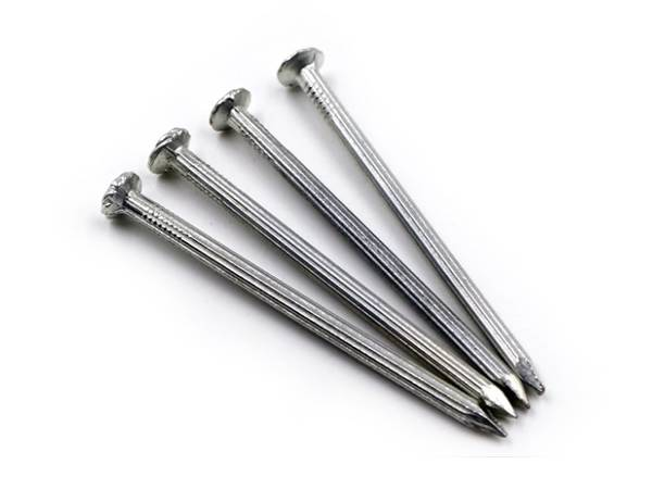

There is one nail that will not pull out very easy is the round
shank mason nail
