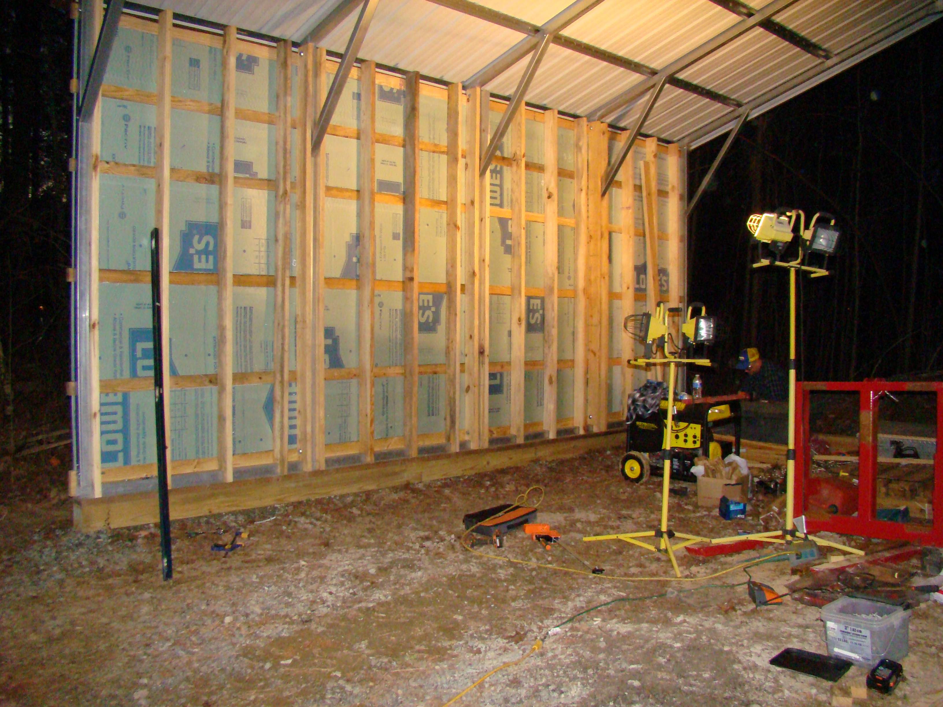

When closing in my carport this is pretty much what I did. Studs are 16" on center 9' tall. I ran 2x4 purloins horizontal essentially 24" on center. I then installed 1/2" and 1" polystyrene foam board between the 2x4 purloins overlapping the seams. Then covered the wall with 1/4" polystyrene foam board, house wrap, and then attached the metal vertically screwing the metal into the 2x4 purloins. I thought I also had a picture of the outside but couldn't find it. Here's one from the inside as I was putting up one of the walls.
