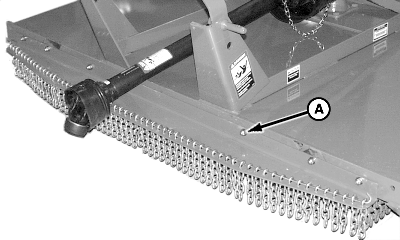

I also can't figure why I have never been hit by anything, ever. Although, if you look at the design of the JD LX-6 there is a thick metal lip that extends out from the front of the mower, right at the lower edge of the mower. The chains hang down from this point. It sticks out considerably past the cowling and blade tips:
I never thought about it, but this may truly be a life saving feature. Or it may not. Who knows?
