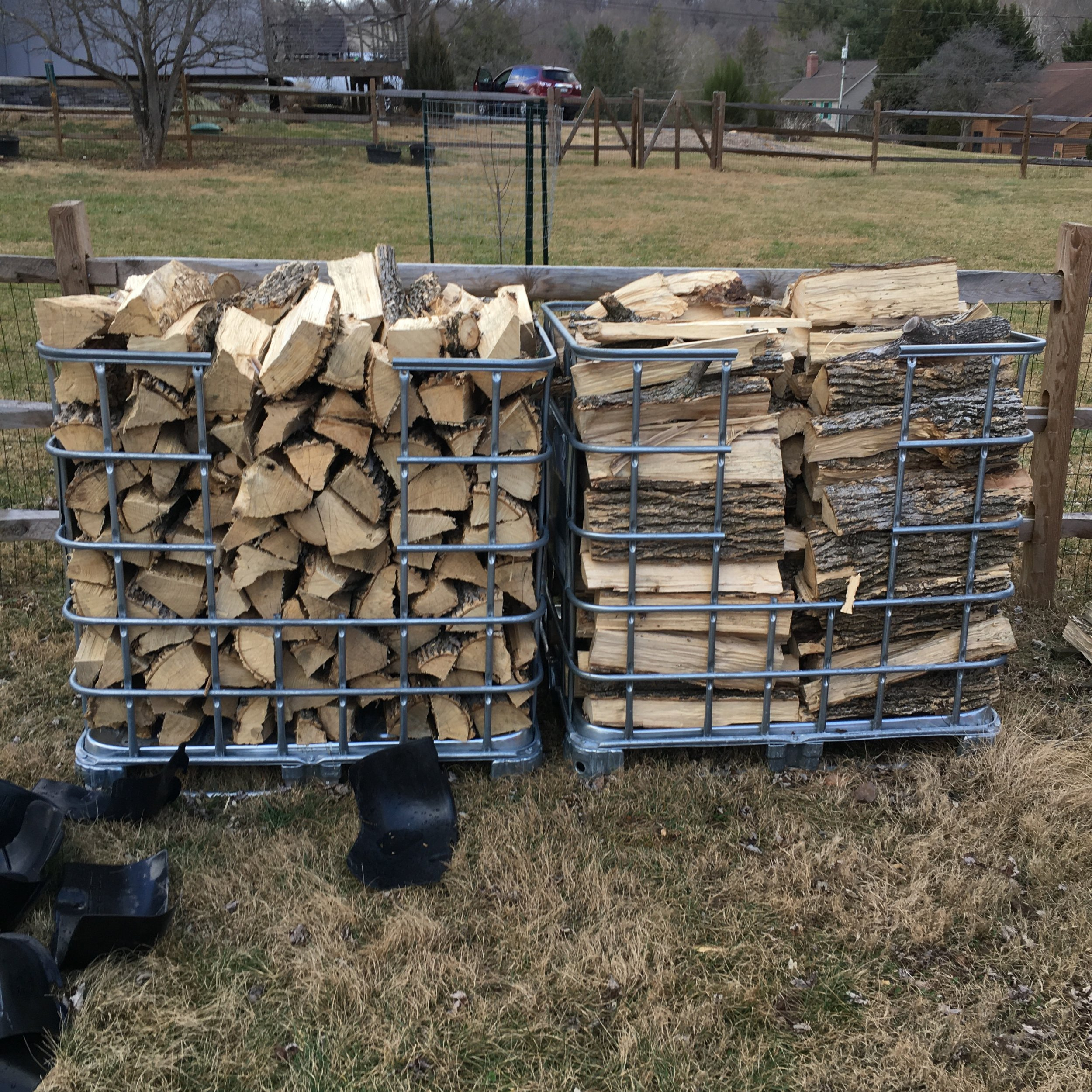

Thank you. I personally still think even the 3 point hitch is going to have trouble lifting these totes. Each one holds a 275 gallon bladder (for those not familiar) and almost exactly a face cord (1/3 cord) when neatly stacked. They can easily weigh a literal ton from my experience. Right now they have large pieces of Ash in them. However, as I said, I am not familiar with tractors whatsoever. It would be awesome if this little tractor could even get them a few inches off the ground to move about. The one in the picture is actually mine on my property and about ten feet away from the Ford 1210 ironically lol.
So a Ventrac is a special piece of equipment. They are super cool pieces of equipment that are only meant to outdo a tractor in a very niche market. For instance, they are marketed as machines that can operate on steep hills. The thing to know about them is implements are very expensive and can only be used on other Ventrac or Steiner equipment. I know what I am talking about when it comes to Ventracs lol. Bobcat is now getting into this type of market as well. The implements are front mounted but use a pulley and belt system rather than a pto or hydraulics.
Also I am looking into the fuel problem now. I was reading that the most common place for them to leak is from the injectors. So the best way to determine that is to put some die in your system and use the blacklight.

I have an old Steiner 525, (one of the largest models) out back, which was the predecessor to Ventrac. Parts for it were not cheap, which was why it got parked.A FEL on them are very, very limited, and I would not consider a Ventrac unless I was doing commercial work mowing. Never for FEL work.
A Ford 1210 is rated at 881 pounds of lift at the end of the 3 point links. Add forks extends that measurement so decreases that capacity. There are ways to adapt the totes to be able to move them, but no way is a Ford 1210 going to pick up a tote that weighs more than the tractor itself, with the stronger 3pt or the weaker FEL . Making a system to hydraulically raise the tote and just use the tractor to pull it is very doable.
I will refer the fuel in the oil to smarter people, but if it is an injection pump, I would be shaking in my boots, worried about getting parts and the cost of rebuilding it!

Yeah I may be interested. A Ventrac is something I have wanted to invest in for awhile. I knew without a doubt that the Ventrac did not have a chance of lifting these IBC totes. I have been doing research for a really long time. If you cut the totes in half, leave the bottom half alone, then screw the top half to a pallet, you can then move them with much smaller tractors. I have seen larger tractors struggle to get these totes a couple inches off the ground. I do not mean like an 60 HP tractor but talking about models in the sub compact range. All the John Deere 2xxx series tractors fail to lift them all together and I think the 3xxx tractors really struggle.

So I got to talk to the neighbor today and he said if he recalls correctly the tractor was leaking at the injector seals. So that may be the most likely culprit at this point. How do you go about diagnosing exactly what is wrong? From what I have seen everyone uses dye and a blacklight.

I will still consider that and have already spoken with him. I would like to diagnose what is going on with it first. He offered to rebuild the injection pump, which is expensive and I also understand. I will have to think about it more but right now I am against putting that type of money into it.
If it is something simpler I may mess around with it to get a little experience if nothing else.
