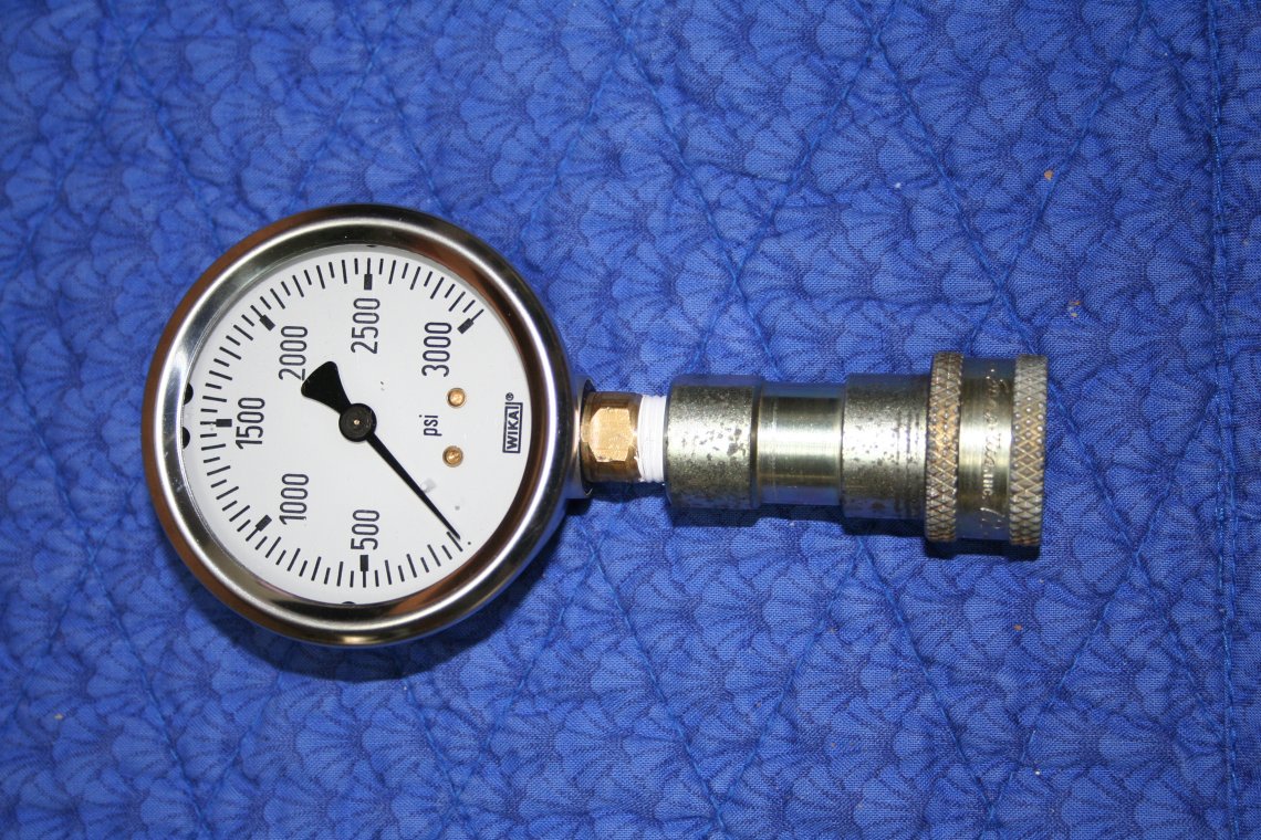

   / Free Log splitter #35
Here are two gage test sets made up by TBN members. The 3000 psi gage it self only cost about $12 to $20
Your TSC should have them or any hyd business.

   / Free Log splitter
#38
Will have to get a DeLux coupler connection to add to it. Never mind, I just took a closer look at it, and that one would work.
