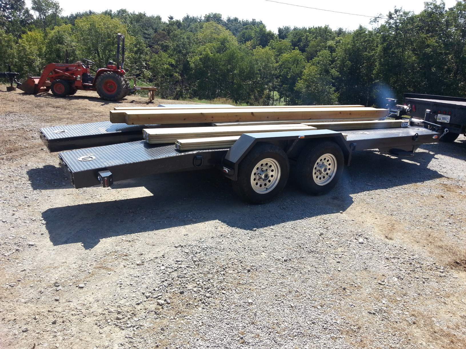

#48
I also got to use the trailer to haul some of the wood.
