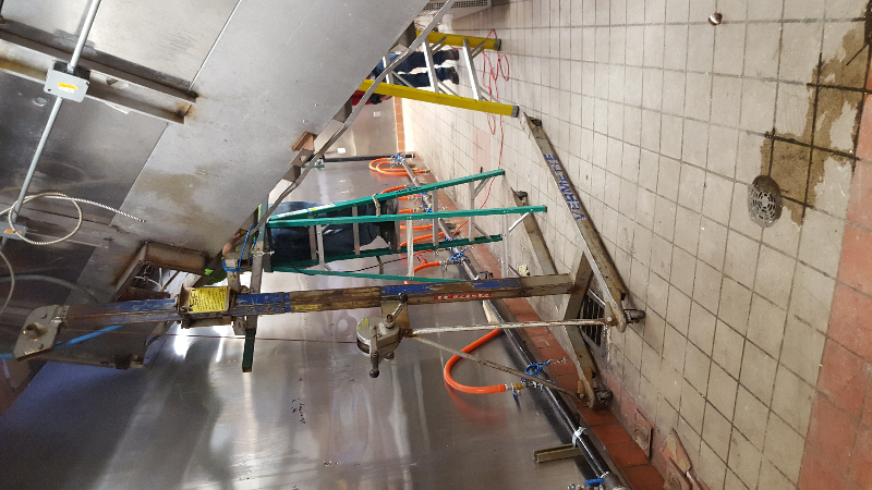

We use pb or wd40 but prefer pb blaster for our high jackers. They have 2 shafts that slide together and if left in the rain or forced together without lube are a b***** you get part and for the winch and wheels on the forks
Also more technical name "duct lifts"
