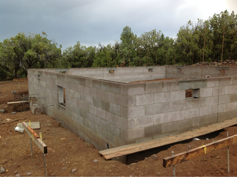

I am also going to install French drains soon. My foundation stemwall is done except for the drain and water sealant. I'm planning on going with the 4 inch hard PVC pipe (with holes) instead of the flexible pipe. My drain will be down 4 feet at the high side and 6 feet on the low side. My inspector says I should sleeve it but I've heard of sleeves clogging up. Would a roll of mesh be better? With a few inches of gravel on top of the pipe before folding over the mesh? I should put a tee and a clean out on the high side too?
How about sealing the block? Any good roll-on sealers I can use. It's just a crawl space, but I want it as dry as possible.
I'll have big overhangs, and eventually wrap around porches.
/ French Drain Question #14
I don't know about the sleeve/no sleeve thing. Muddy water (suspended particulates) surely passes through the mesh/fabric, into the stone bed, and on into the pipe. It may depend on the nature of your soil as to whether that would clog a sleeve eventually.
Logically, if the fabric protecting the stone bed fails to do its job, the drain will not be very effective due to clogging material in the stone. Looked at from that perspective, the sleeve on the pipe will not save the drain from eventual failure. If the fabric is working, then the sleeve represents an unnecessary point of failure if that is the nature of the soil.
Don't skimp on the washed gravel. :)
