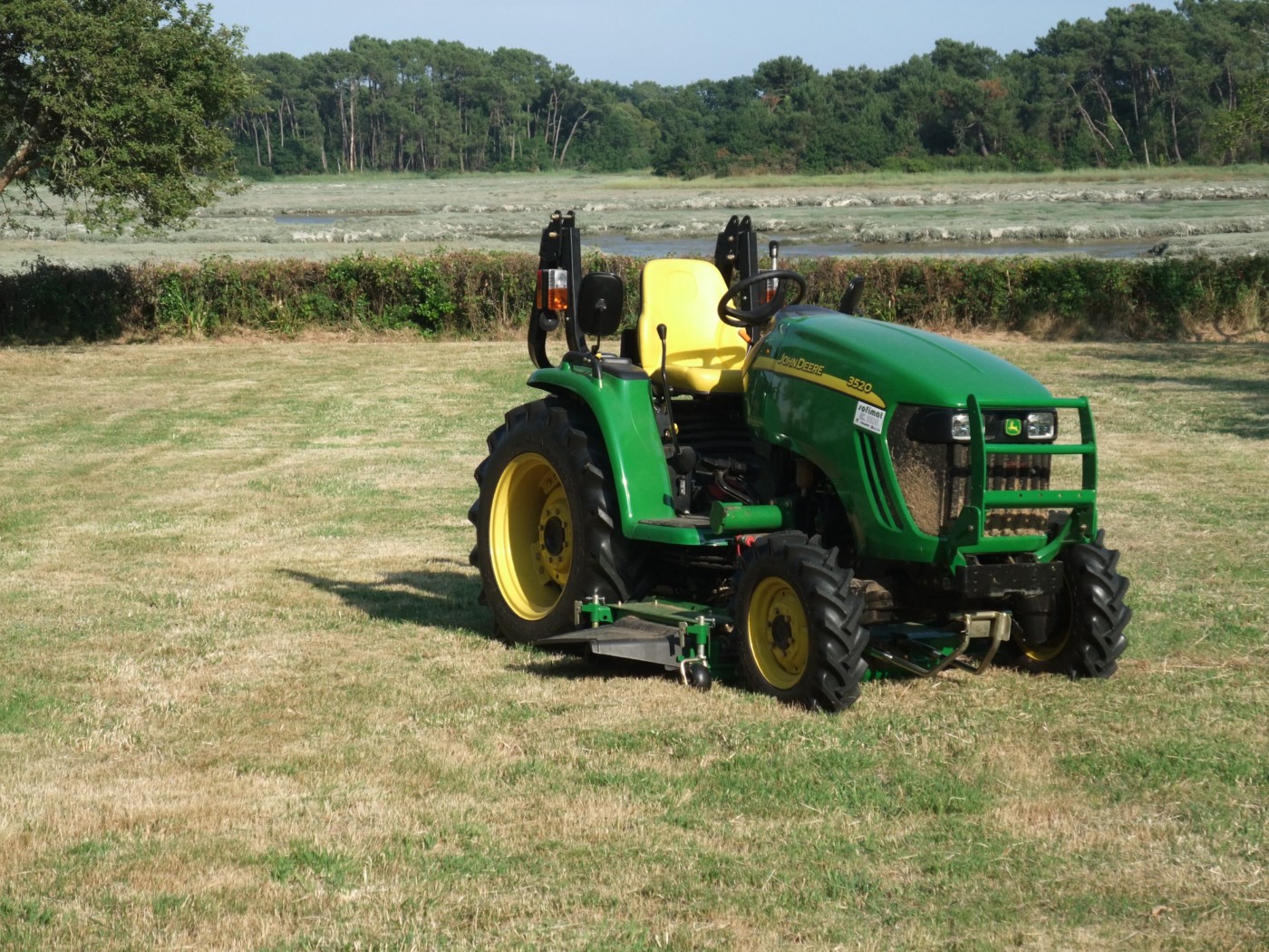

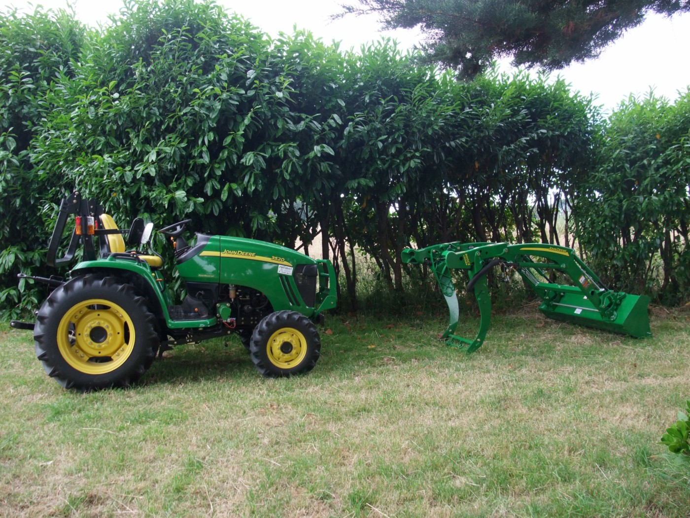

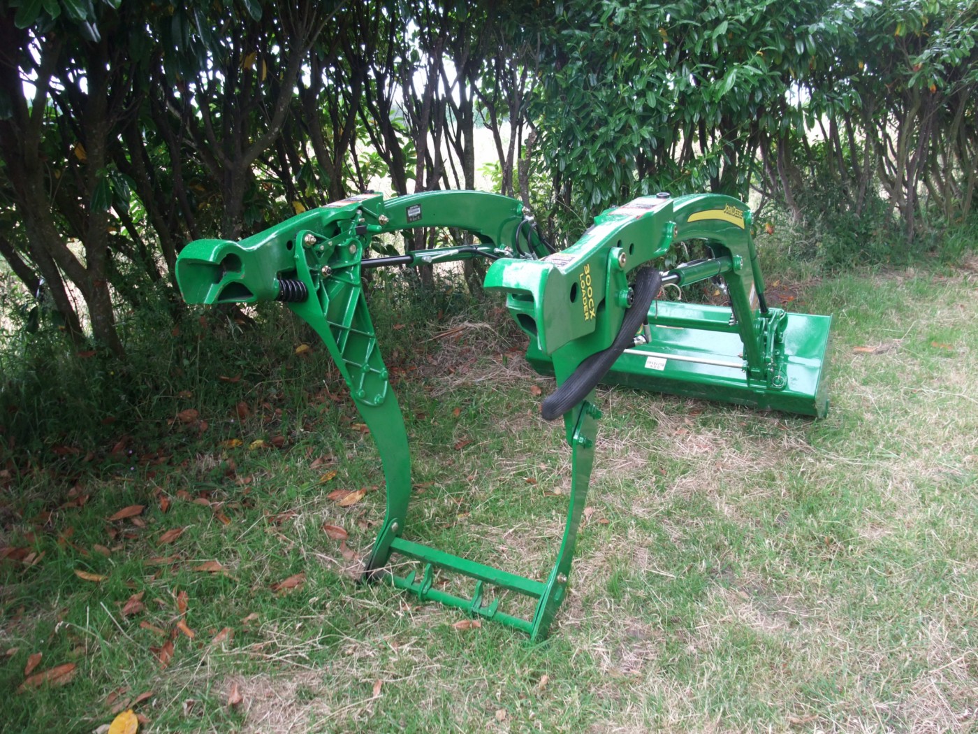

I always take off the FEL to hitch the autoconnect deck on my JD 3520 to increase visibility and manoeuvrability and decrease weight. Less damage to the grass and smaller surfaces left to cut with the walk behind. No particular sign of wear so far.
